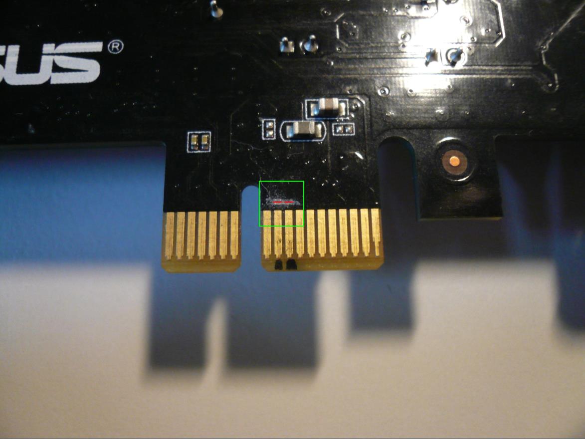

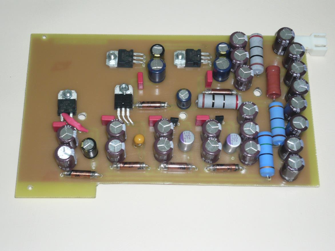

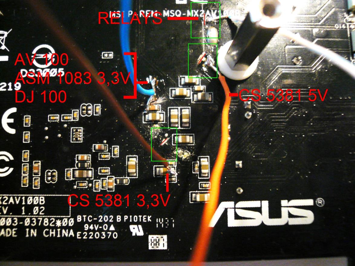

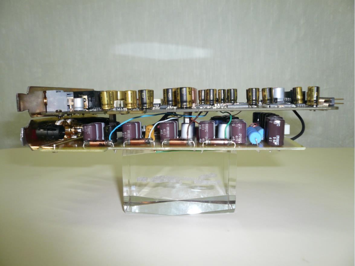

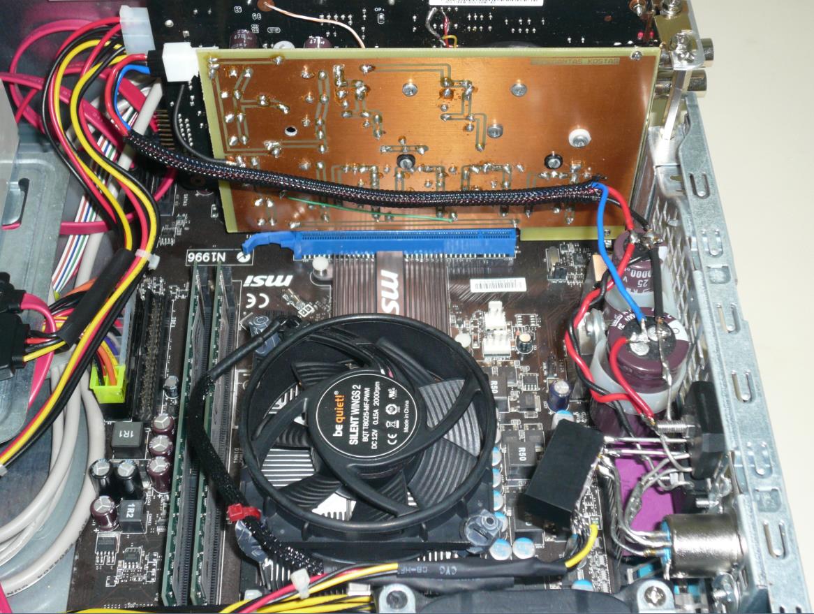

I had brutally jeopardized an asus stxII to make it work completely from a linear psu. I even bypassed the PCI-e traces for 3,3v. Great adventure and great sound. Still, the ground connections had to stay for it to communicate with the PC thus, the only way to overcome ground loop noise was to use ground lifters for the preamp/amp and that worked fine for me.

I am actually powering my pcie soundcard with riser and linear ps. But It just lower the " noise floor". I think it is not a solution for your noise problem..
