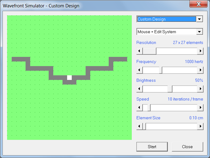

Unfortunately, when creating a custom design in the Hornresp Wavefront Simulator, there is no way around it but for a non-straight wall to be generated element by element.
The Up, Down, Left and Right arrow navigation keys can however be used to make the task a little easier.
To add a wall, click the mouse on the first element of the required wall and then use the navigation keys to extend the wall in the direction(s) required.
To delete a section of an existing wall, click the mouse on the first element of the existing wall and then use the navigation keys to remove the required section.

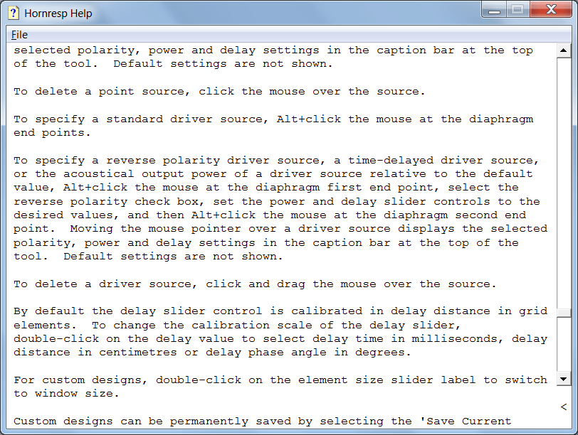

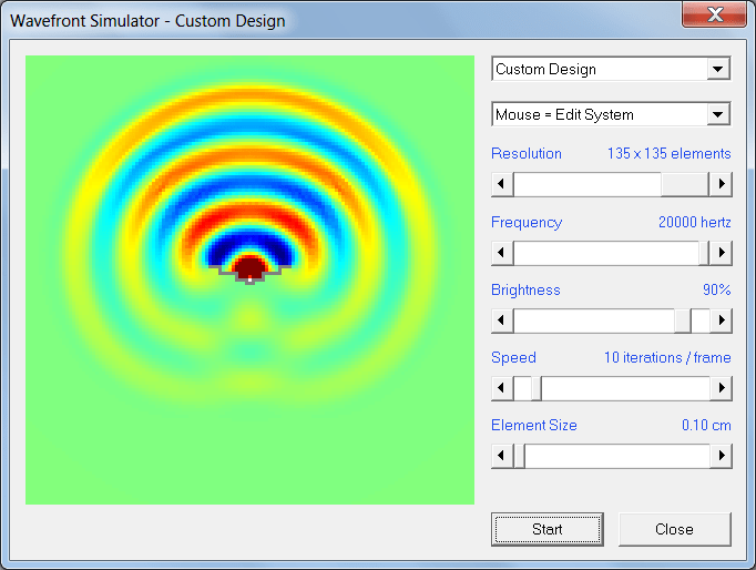

In addition, it is sometimes possible to generate the walls (and source/s) using a lower resolution as shown in Attachment 1, but to then switch to a higher resolution for the actual simulation, as shown in the Attachment 2.

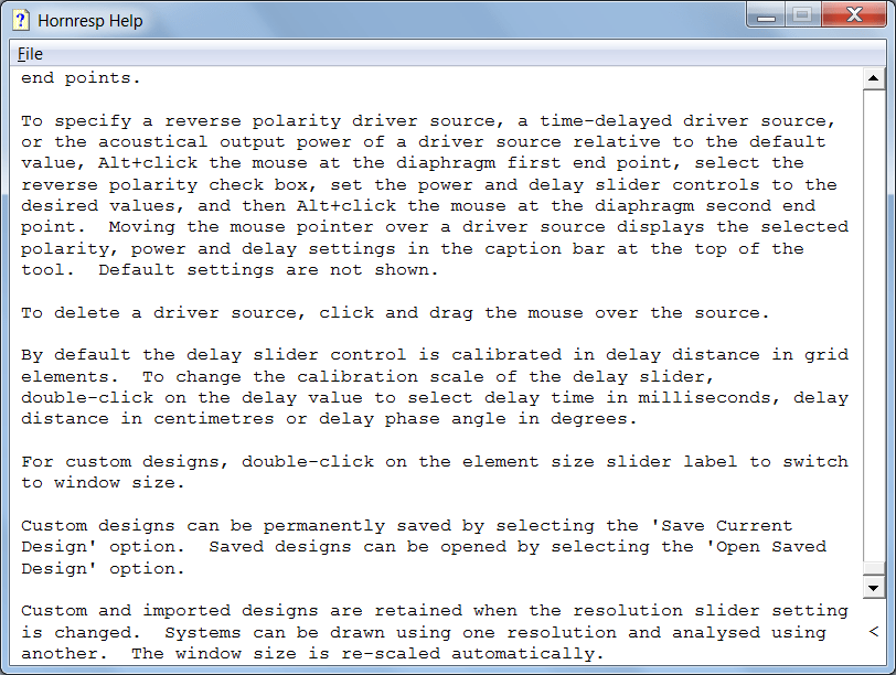

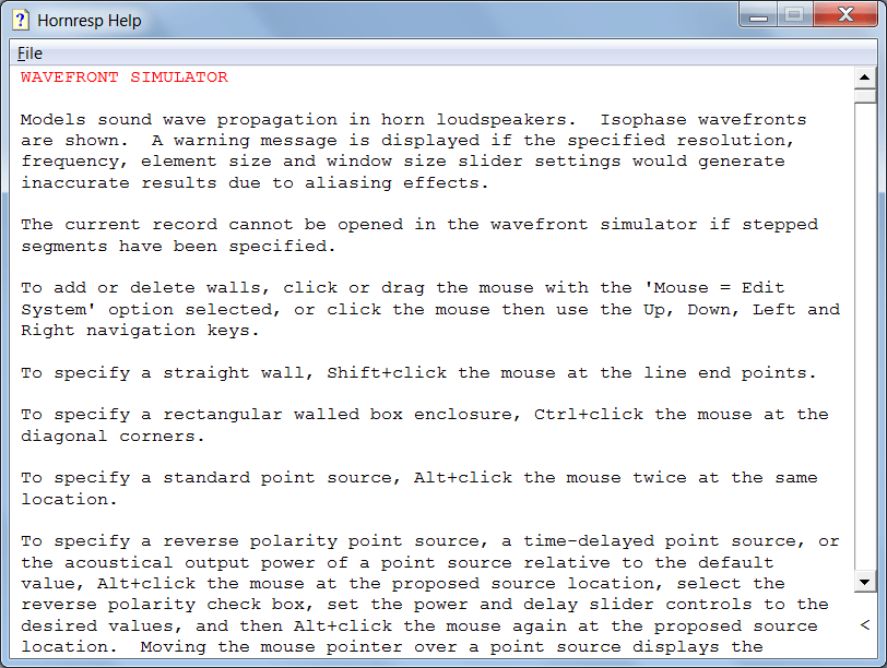

All available features in the Wavefront Simulator are documented in the Help File, as shown in Attachments 3 to 5.
