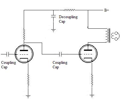

Tom, do you mean what I call coupling caps when you say decoupling caps🙄 = The things that couple ac from one amp stage to another but block dc? --- Does that mean that in reality the hum level in a C-coupled driver stage doesn't matter (so no need to multiply by the gain ratio and calculate the ripple for knowing the hum-level) -- but maybe the stage suffers from other downsides of a non-stable voltage supply (intermodulation distortion etc.)? (Just letting my thoughts flow 😀 )
John, may I ask how sensitive the speakers are that you want max. 1mV hum on? Mine are around 96dB/W and my ears are around three meters removed from the cones.
Kilmon, my speakers are 91dB/W: Diatone DS-35B , but the room acts as a horn to amplify LF. It height ramps from 2m (where the speakers are sited) to nearly 6m...Yes it's a strange house!
Coupling caps transfer the signal from one stage to the next. Decoupling caps "couple" the signal to ground, such as signal that may be present on power rails. This would otherwise cause unwanted feedback and instablility.
This is not precise use of language however. If you look carefully at your schematic you will find the signal's return path is often through the "decoupling" caps. This is why it makes no sense to spend $$$ on coupling caps without considering the return path too. (In my view it hardly makes sense anyway)..🙄

Aha, then the decoupling caps in a single-ended amp are the last caps (for each stage) in the power supply / the only ps caps directly connected to the opts in an output stage😱? I use small value pio caps for that purpose (around 10-15µ / channel) and small value Russian military teflon in oil caps (0,1 or 0,056µF; calculated for 5-7 hz) If I'm still not talking nonsense; I once swapped cheap mkp decoupling caps in a push-pull for pio and there was a definite improvement - maybe not as much as the coupling caps but both are in the signal path I gather (although most of the ps of an amp is not but redesigning makes a world of difference😀 ) // Do you use flea-powered sets on your Diatones? Today I tested a two-watt amp + preamp (gain = 6) on a pair of 89dB/W tml's and to my surprise I only needed about half of the available power to drive the speakers to good soundlevels???
Klimon said:Hi John,
Aha, then the decoupling caps in a single-ended amp are the last caps (for each stage) in the power supply / the only ps caps directly connected to the opts in an output stage😱? ...
Decoupling caps are generally used in the B+ line before it connects to the plate resistor of the input and/or driver stage. The purpose is to provide an AC path to ground. Any signal that gets put onto the B+ should follow the cap to ground and not enter the tube.
Often the output stage is not decoupled.
