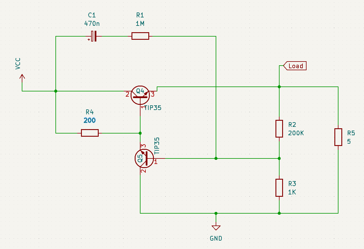

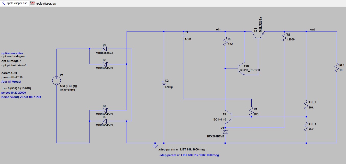

Ripple Clipper or cap multiplier
This circuit is from "Low Noise Electronic Design". It inverts the ripple on the input and modulates the drive of the pass transistor base. I suspect that it isn't too stable.
1) Motchenbacher, C.D. and Fitchen, F.C. "Low Noise Electronic Design", John Wiley & Sons, 1973
If RL is split, and a capacitor is added at the junction point, it will become a regular cap-mult, but helped by the open-loop reduction. R would then need to be made much larger.
The scheme might overcome the 60~70dB limit of a standard cap-mult, caused by the Early effect

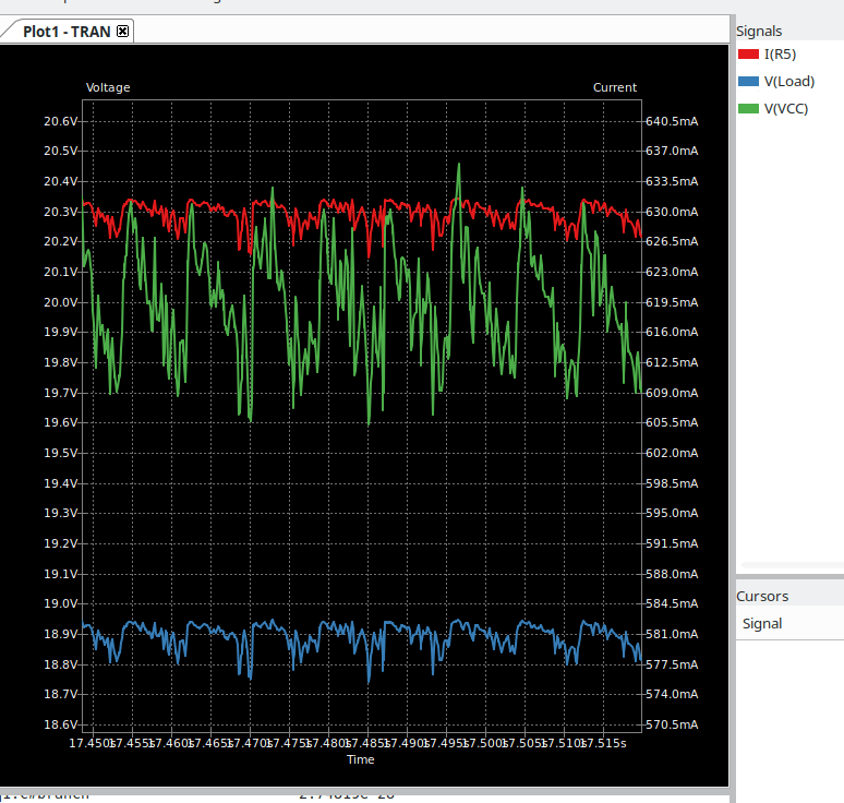

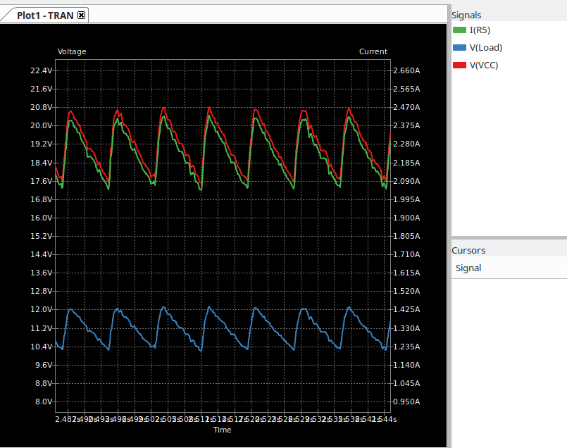

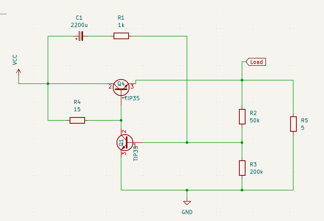

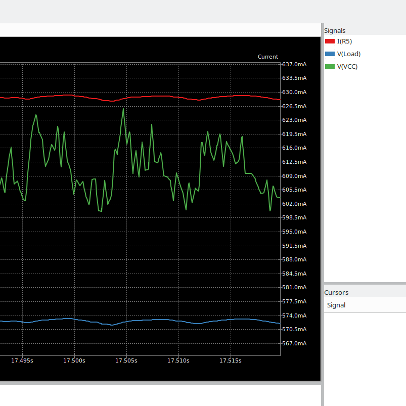

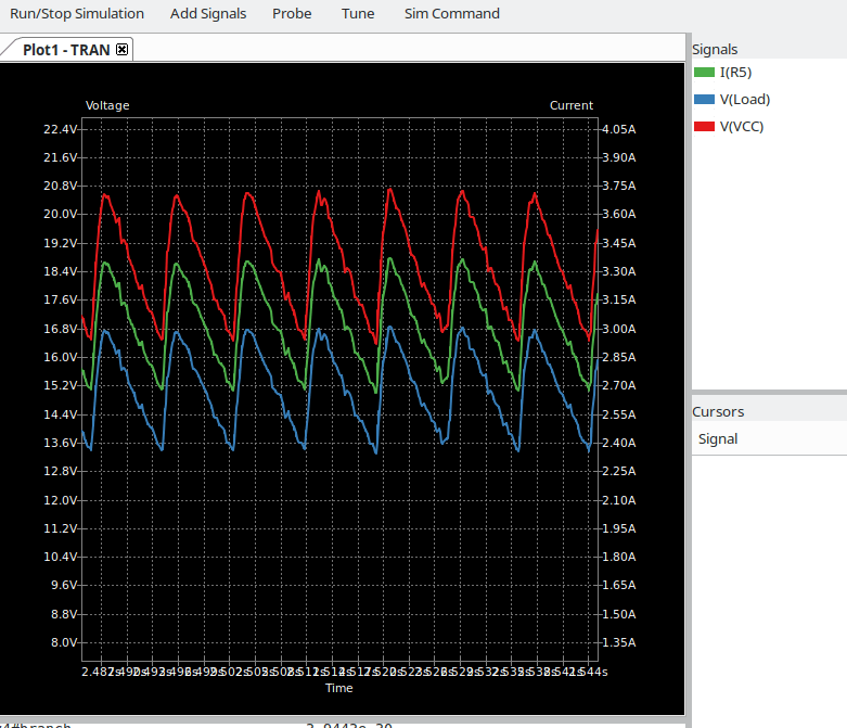

Hi there. I simulated and I see that to get reduction in ripple you need to give up a lot of RMS with R4. Attached also is a graph with R4=50 ohm (more RMS).
Should I try different component values?

Or simply accept a second Vbe of in-to-out voltage drop; merely connect two conventional (R-C-Q) filters in series. Instead of "N" dB's of PSRR you now get "2N" dB's. If one gives you 40dB (100x), two give you 80dB (10,000x).
You should stick to the original, with a NPN for Q2.
In addition, it would be preferable to adopt a more deterministic approach for the bias of Q2: a fixed base divider instead of the potentiometer + an emitter resistor.
If all this is combined with my previous suggestions, the circuit could become usable practically; R would need to be adjustable to suit the Vaf of the pass transistor

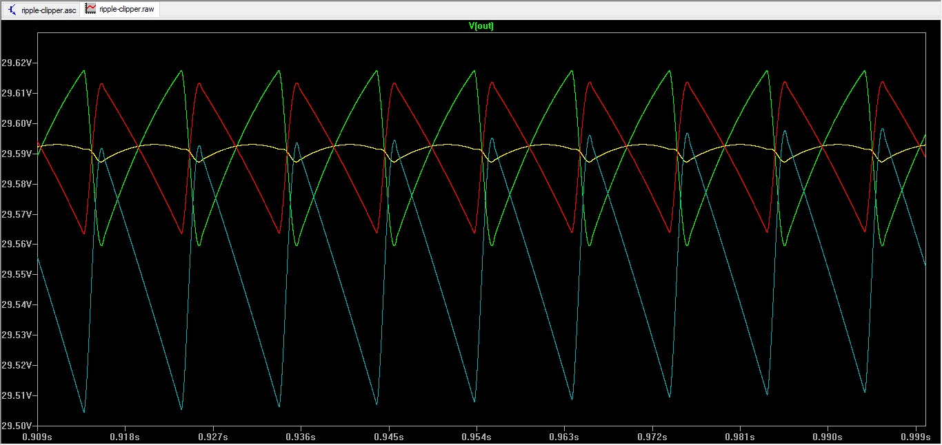

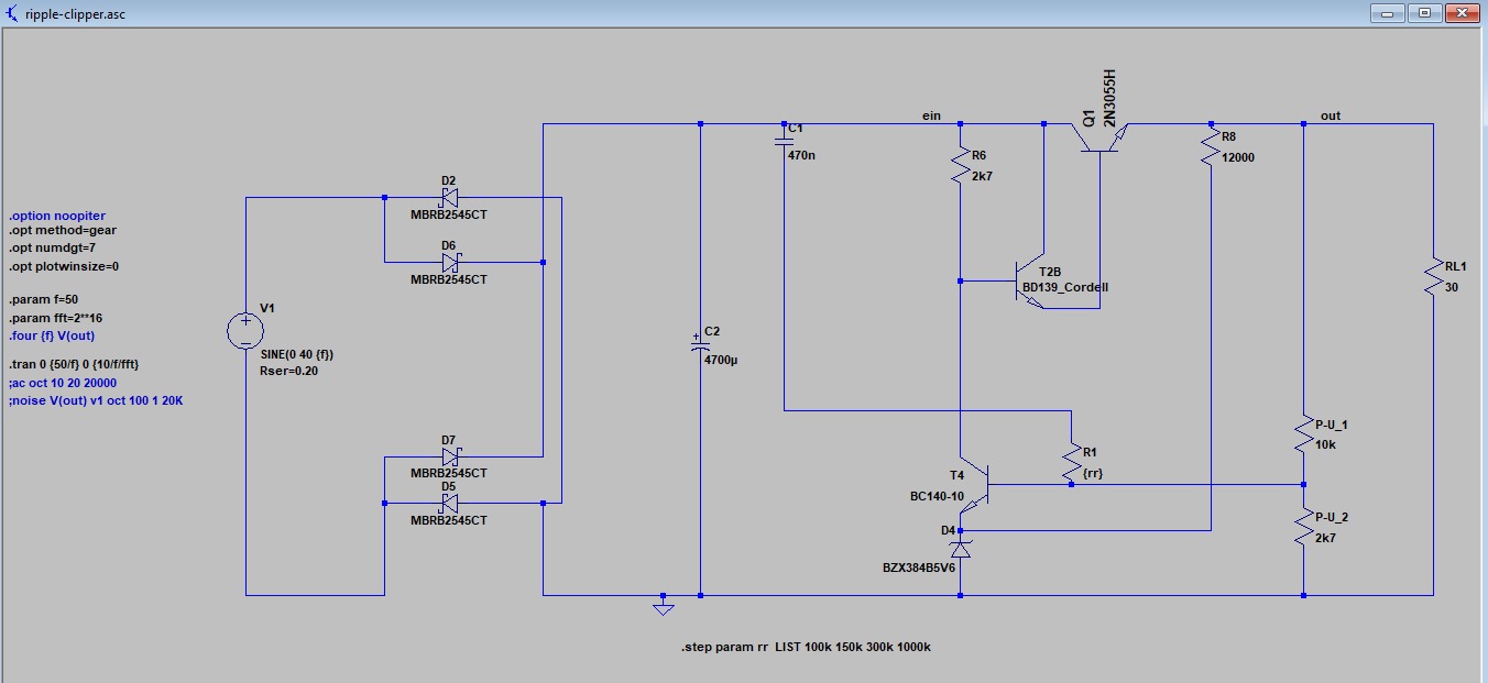

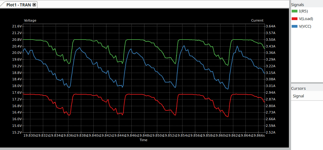

Below is my above mentioned regulator (simplified) from around 1972, with "ripple clipper".
Output voltage 30V, simulated current 1A
I add the .asc file.

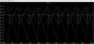

The graph shows V(out) with different values for R (R1/rr in asc-file).
light green 100k
yellow 150k
red 300k
dark green 1000k
seems to work best with R around 150k 🙂
The original circuit shown in the first post is certainly only intended as a basic circuit diagram and cannot be implemented directly as an independent circuit. But the principle works quite well, as my circuit simulation shows. The functionality varies somewhat depending on the output current, but in any case the ripple suppression is better than without the two components. Definitely useful for preamp power supplies where there aren't large current fluctuations. In a narrower output current range, attenuation of the ripple voltage by more than 20db is possible. (if I haven't miscalculated).
That's a plain vanilla discrete regulator helped by a hum-bucking scheme, not a ripple clipper or eater.
A regular cap-mult adapts itself to the input voltage and provides 60~70dB ripple rejection using a single transistor (or integrated darlington for higher currents)
If they are carefully (and individually) selected, no: they can improve the PSRR but opting for a suitable topology to begin with is the first priority. Such small embellishments can then be added to improve the performances further if needed

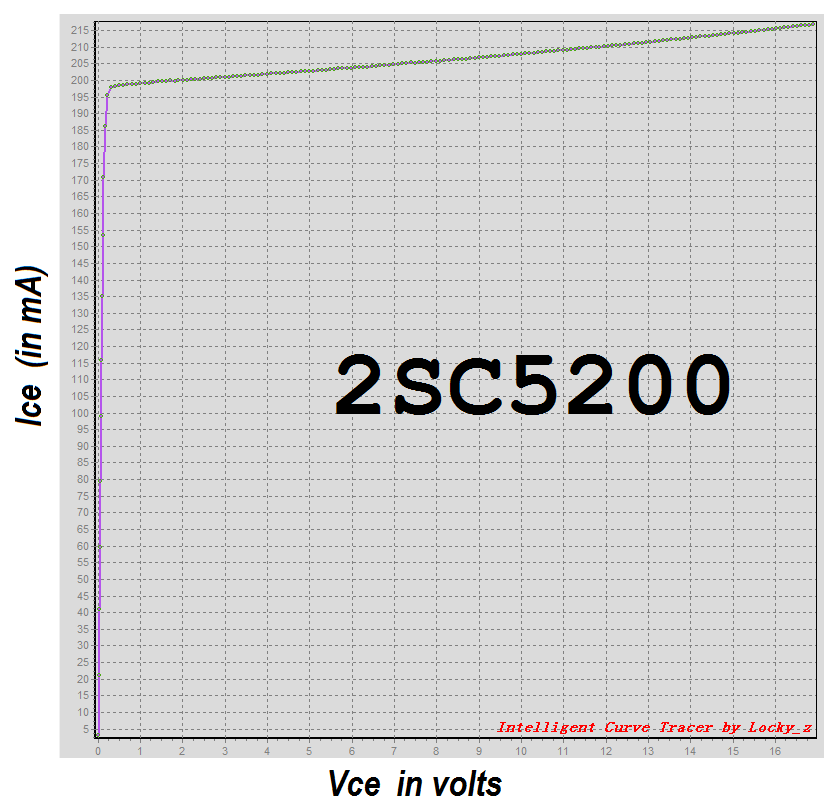

So it's a pretty good idea to hunt for pass transistors with the least Early effect. Here's a potential candidate; good by itself, and wonderfully excellent in a cascode pair.
SiGe transistors like BFP640 can have Early voltages in the KV range but are probably
dangerous in the hands of an average AudioHead. (Hint: 0603 50 Ohm bead close in the base)

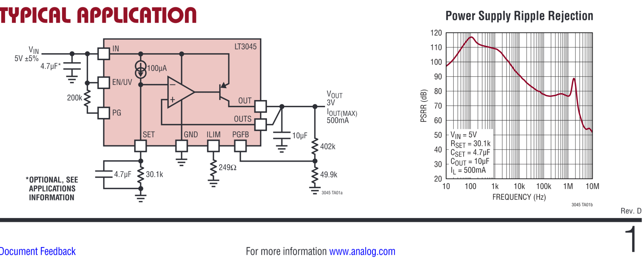

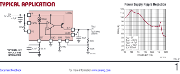

Also I cannot understand how 20 dB more suppression can provoke such a joy when
modern-day regulators provide > 110 dB at hum frequencies, along with metrology
grade voltage precision and 2 nV/rt Hz noise density. (LT3042, 45, LT3094 neg)
And at high frequencies you can help the regulator easily with cheap non-special parts.
I'd be ashamed if there was a spot on a board of mine where I needed 110 dB suppression.
