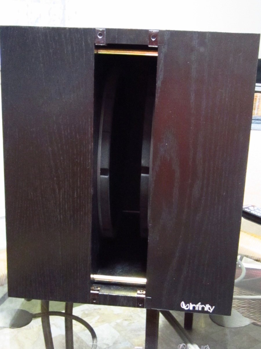

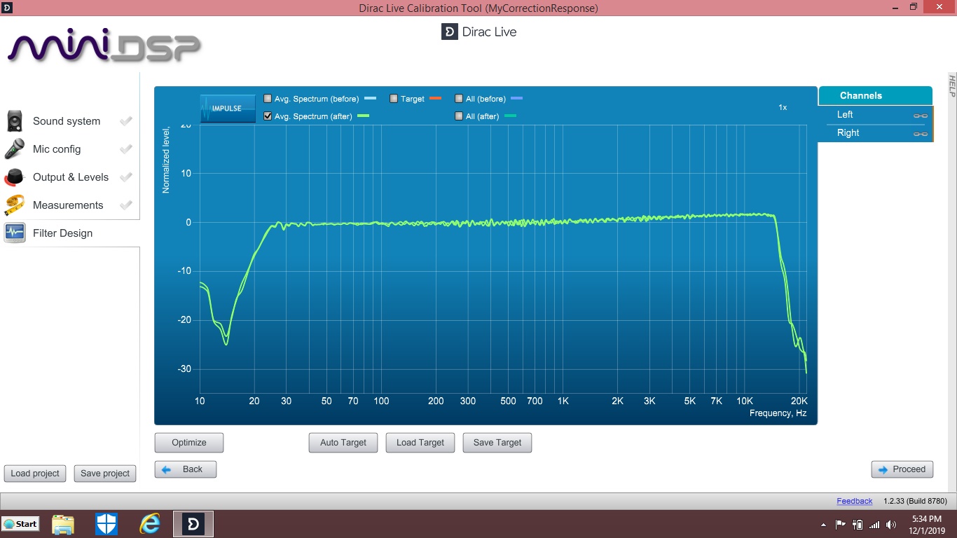

I built a pair of Ripoles using a pair of 12" Infinity Reference RF1200S low-profile subs in each cabinet to go with my Magnepan speakers. I couldn't be happier with the results. After room EQ the frequency response is flat down to 27Hz.
I had a little trouble calculating the size of each cabinet due to confusion about the math as explained by JM in his write up. The problem was with calculating the area of the center chamber opening. I figured out that the calculations for the center chamber need to be calculated by doubling the amount of cone surface area since there are two subs firing into the center chamber.
Here are pix of the subs. The enclosures only measure 13.5" wide by 15" deep and 16" tall. I used 3/4" MDF for the cabs and wrapped them in oak veneer. They're pretty compact when you consider there are two 12" drivers inside. I didn't care for the magnets hanging out the sides of the cabinets like JM's subs. That's why I decided to go with the lo-pro Infinity subs.

I'd just like to add that I've owned my Maggies since '91 and in that time I've built both sealed and vented subs. I even built a transmission line sub to go with the Maggies. While they all added low end in the end they just weren't satisfying. They just didn't blend together nearly as well as the Ripole subs. Magnepan recommends using a dipole sub design with their speakers. I've been listening to the Ripoles for a few months now and I must say that I agree 100% with that recommendation
Here's the frequency response of the subs and my Maggies after running my MiniDSP DDRC24 room correction equalization. I tweaked the treble up a bit to offset my now 60 year old hearing.
