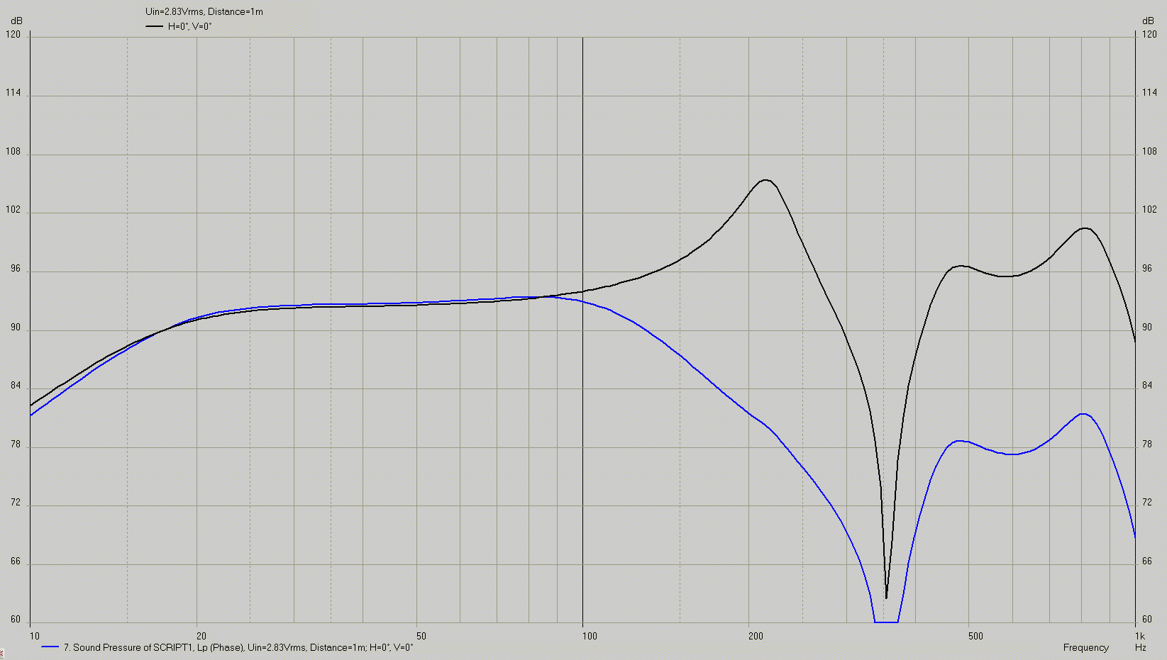

I am ready to produce a cutting list for the H Frame.
As this is a First Time Experience for me, I have been toying with the idea of having the option to experience the effects of the H Frame in different configurations.
I was thinking of having the Two Drivers Mounted Side By Side,
on a W 800mm x H 450mm Baffle.
Does this configuration work ? or is the Stacked Drivers the better array ?
In my choice of Driver Mounting, I was intending on making the
Framings Base Plate and Top Plate 1000mm x 1000mm x 20mm.
This will allow for my Side Walls on the H Frame to be Shortened and Extended.
The Driver Mount Baffle and Side Walls will be a of 30mm Thick Material, and can be used when required to produce the final OB Subwoofer design.
The Driver Mounting Baffle can also be moved towards the front or rear, changing the depths.
Again extended Side Walls can be added.
I have also looked at a Method to allow for the Side Walls to be Tapering In or Flaring Out, this can be produced for both the Front and Rear Sections.
The Speaker Baffle and Side Walls will be bedded into a Sealant Substance at the rebated Pivot Point to give a Air Tight Interface.
The Image will offer a description of the idea I am working on.
This is not my thoughts on a Final Design for a every day use,
but a idea on how to produce a framing to be able to experience the H Frame in different configurations. Subwoofer, it is just to enable a Speedy Change of a Configuration of the Parts that have an Influence on the SQ.
This design has been produced as a result of Information that I have recently been reading up on.
It would be good receive a comment on this as a method to produce a OB as a initial experience.
It will probably be more of an amusement to those that view it.
I am sure there are flaws to be seen that I will never comprehend.
If it is seen that there is enough available from the build,
to allow for my first DIY Subwoofer Experience and extend this into experiencing the Bass SQ as a result of changing the Framings Configurations,
I will happily produce a cutting list for the Parts and use the Router for the Interface Posts Pivot Point Rebates.
