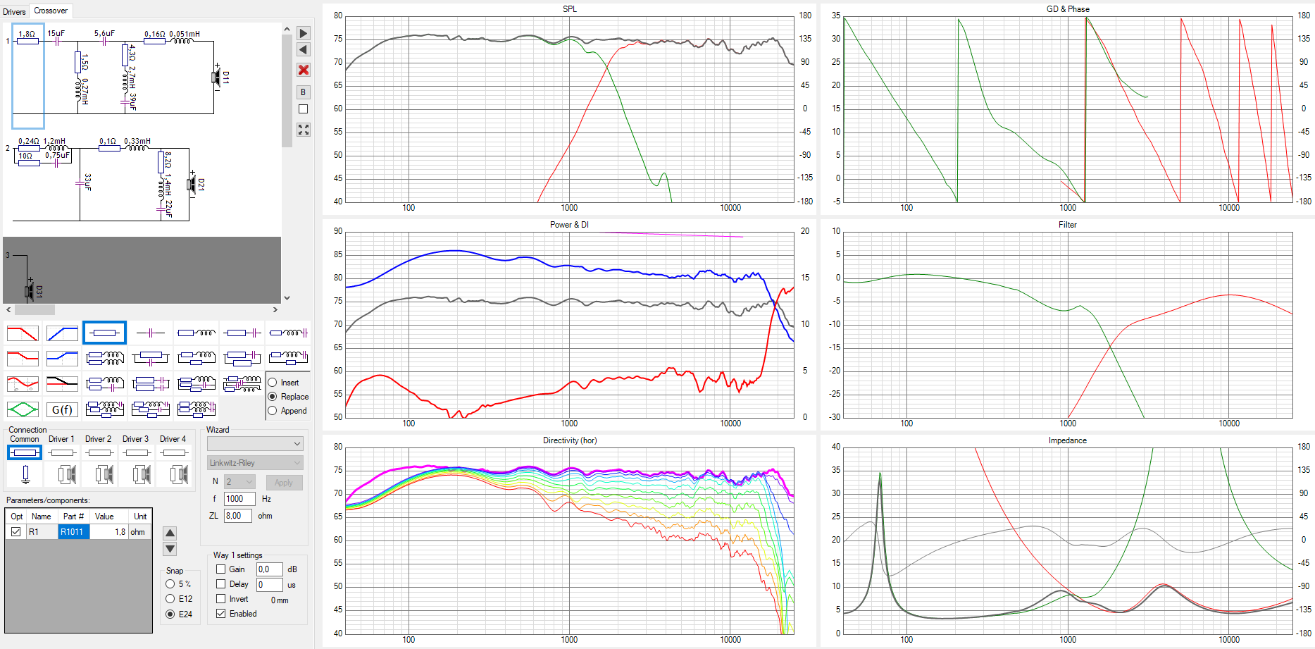

The steep crossover (actually it's a shade over 26db down so not exactly 6th order) is needed to phase match with the woofer's target slope - as the 3.5K resonance is messy and badly interferes with the final axial response. The resultant peaking HD at 1200Hz is also worrisome. It's only -35dB down at 1w for the 4 ohm model and almost coincides with the dip in FR due to the cone edge resonance. I'm not even sure a 2-way is possible but we'll see once I have all the drivers in place and scrounge up a test box.
I understand your points. I did prototype speakers with MW19+SS6600+customWG, see Vituix six-pack in the attachment. I started with quite simple crossover and gave it a listening. Phase tracking could be better on both sides of Fc.
WG profile does not exactly follow target curve, hence dip around 10kHz.
I also worried about HD peaking at 1200Hz. But considering all aspects of MW19, I see that peaking to be just a wrinkle on otherwise great midwoofer. ~10 people heard that project and nobody complaint about midrange (actually it was opposite, midrange clarity was common comment), unless loudspeakers driven very hard with symphonic music, which is just inherent issue of 7+1 2-way.
But to be clear, I do not like that Satori cone edge resonance either, and hope to see it mitigated on Textrene series of Satori.
Moderator
Joined 2002
That looks a nice design - did you use the 4 ohm woofer?
I don't have measurements yet, but I'm using the manufacturer's data to give me some perspective on what I need the crossovers to approximately look like. Though this does not finalise the crossover, I get a good idea of the topology needed.
This is what I have so far. It's based on the tweeter's 30 deg response as it is below woofer, farfield will be closer to 15 degrees. 4dB of baffle step with woofer on top layout. I ended up putting zobel on the woofer to hit the target curves at the top end.
After this is some way ahead, I can try some kind of comparison between the RN and DN versions, even though the rest of the drivers are totally different. The RN is in a system with Volt B2549 at the bottom and a MW13P-4 crossed at 220 and 2.3k.
