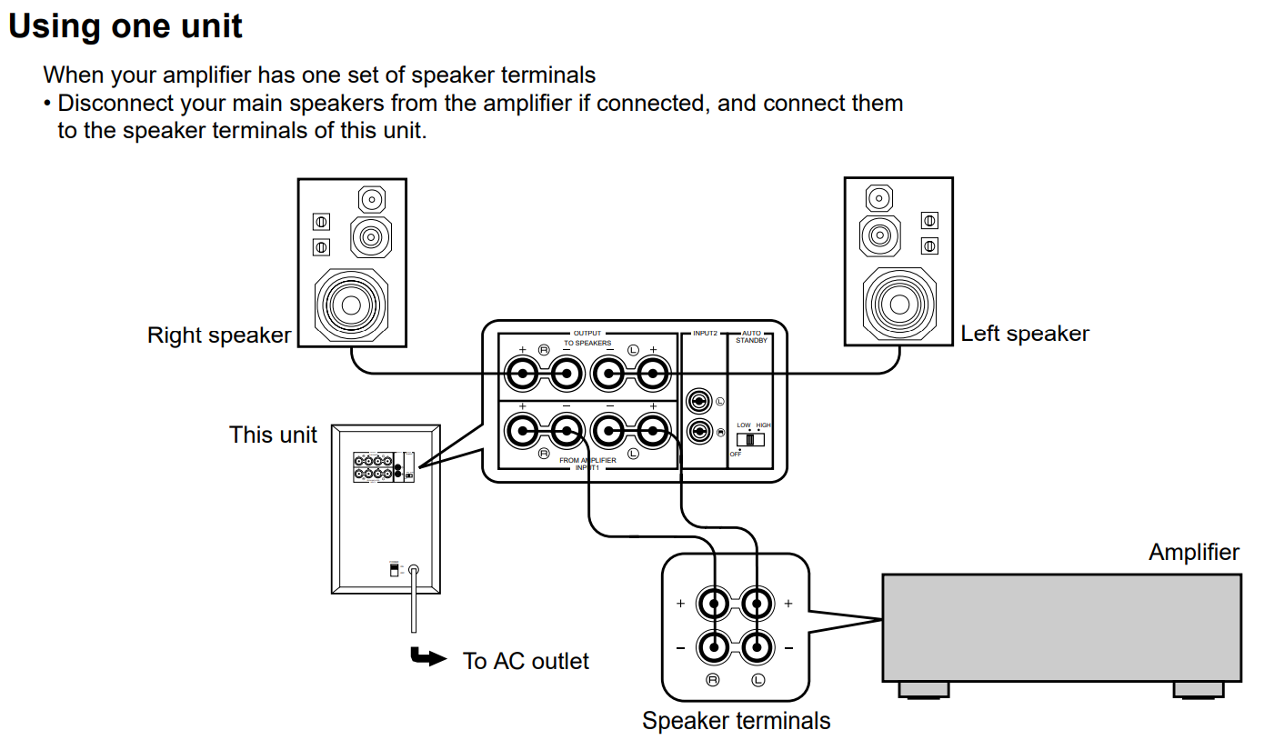

I think that it will work the way that you have described. It's essentially the same as the set up described in the Yamaha user manual for the "two sets of speaker terminals" case. Keeping in mind that the A and B speaker outputs of an amplifier are simply two sets of terminals connected in parallel and with an electrical switch in the circuit.According to this video, it seems like this way the impedance read by the amplifier won't change much compared with the two speakers alone. But he was using a solid state amplifier.
Do you think it works this way also with a tube amp? From the amplifier speakers terminals, two cables to the speakers, two more in parallel to the speaker level inputs of the subwoofer. Then I adjust volume and filter frequency. All this without using the speaker outputs of the subwoofer.
On this video, Paul McGowan, the owner of PS Audio, also says that it will work that way with a tube amp. He adds that you should keep your speakers full range, in short you shouldn't use the speaker level output of the sub.
That yamaha sub has a compensation circuit for the speaker signal. That is something very different than just connecting the speaker output of an amp to the line inputs of a powered subwoofer.The following is a diagram provided in the user manual for the Yamaha YST-SW45 subwoofer. I expect that Yamaha know how to properly and usefully connect their subwoofer to a hi-fi stereo speaker system.

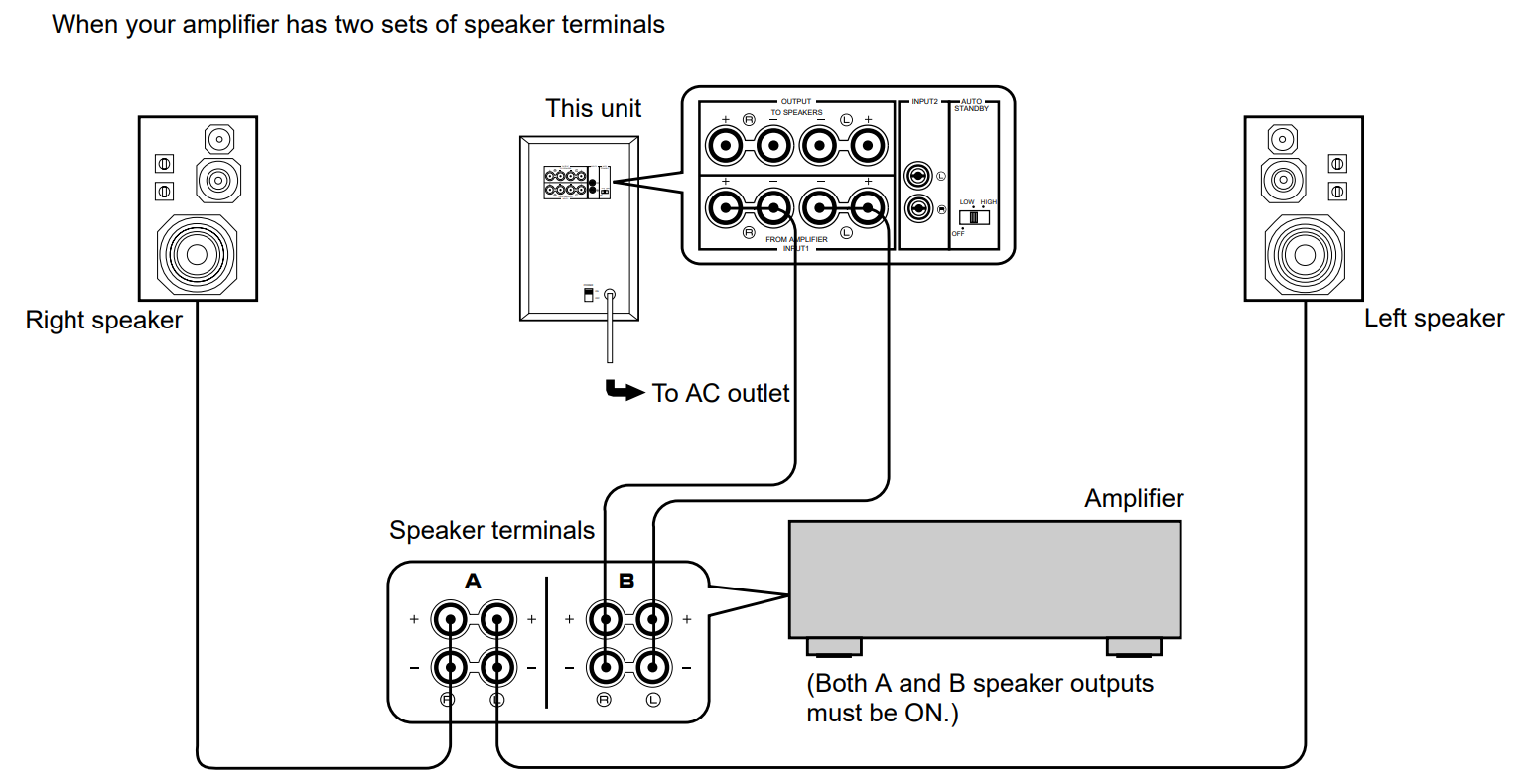

The other option is to use the B speaker outputs for the cables that run to the subwoofer. This is also shown in the Yamaha user manual, as seen below.

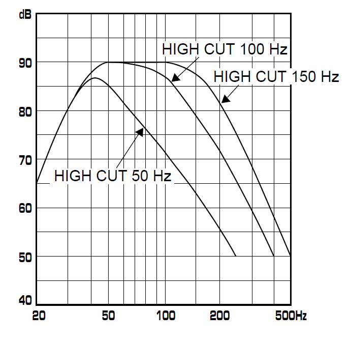

The Yamaha YST-SW45 subwoofer seems to be a moderately capable unit for its driver size. It's only an 8-inch woofer, so that's only 64% of the radiating area of a 10-inch driver and only 44% of the radiating area of a 12-inch driver. The latter will likely have a larger linear excursion capability, magnifying the difference even further. It will provide an excellent "voicing" match to your Altec loudspeakers, which seem to have quite limited bass response.The old Yamaha YST line is the most common for sale in Italy. They all have speaker level inputs. It's probably not the best subwoofer, but there's a lot of them available so it's going to be easy to find a second of the same model.
Having said that, the YST-SW45 has a reasonable bass extension for an enclosure whose gross volume is a compact 27 liters. The published frequency response curve is shown below. With the low-pass filter set to 100Hz, this subwoofer will be −10dB at 30Hz, and −3dB at about 37Hz, which isn't too bad. With its low-pass filter set to 50Hz, the –3dB point will decrease a little to about 33Hz. These results are quite good for an 8-inch driver, and show that Yamaha has tried to ensure that the subwoofer won't easily be overloaded by infrasonic content outside its nominal passband.

According to the user manual, with one sub I have two options:
With two subs I have to study the matter.
Thanks anyone for your help.
The power handling of the Altec Duplex drivers is just 16 watt. I have got two integrated tube amps, the smallest push pull Cayin and the smallest single ended Line Magnetic. I haven't got separates.
When they deliver the Yamaha sub, I will start with one and then I will purchase another. There are several for sale. You can have it even for 50 euro.
- From the amp's speaker terminals to the speaker level inputs and then from the speaker level outputs to my speakers, through the sub crossover
- From the amp's speaker terminals in parallel with the speakers to the speaker level inputs of the sub, keeping my speakers full range.

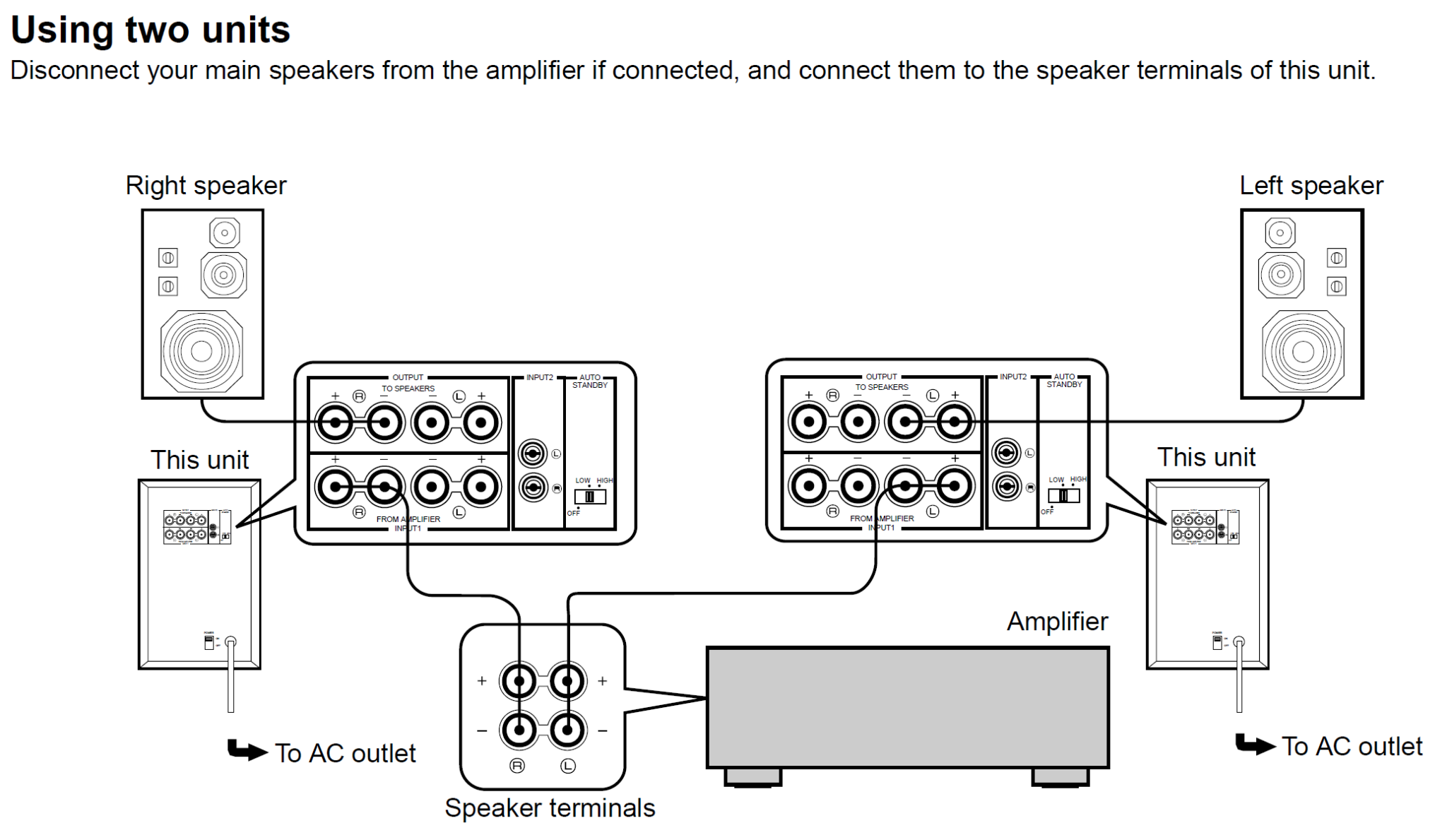

Looking at the diagrams in the user manual of the Yamaha YST-SW45, it does not appear to have any RCA connector outputs that are high-pass filtered. High-pass filtered RCA connector outputs on a subwoofer are altogether a bit uncommon.I second Witwald's advice to use 2 x Yamaha subs. If you have a separate preamp feeding your amp, you should try the phono inputs & outputs on the Yamaha so you can take advantage of their electronic xover which will roll off your Altecs as required.
The user manual describes the connection of two subwoofers using the speaker terminals as shown below. For some unknown reason, Yamaha decided to draw the left speaker on the right and vice versa!
You seem to be leaning towards placing each subwoofer in close proximity to its main speaker. This setup would require a long speaker cable run from the amplifier to the speaker input on the subwoofer, followed by a short cable connected from the subwoofer's "Output To Speakers" to the relevant main speaker's terminals.
In Japan, they also drive on the wrong side of the road, so that is only logical.For some unknown reason, Yamaha decided to draw the left speaker on the right and vice versa!
