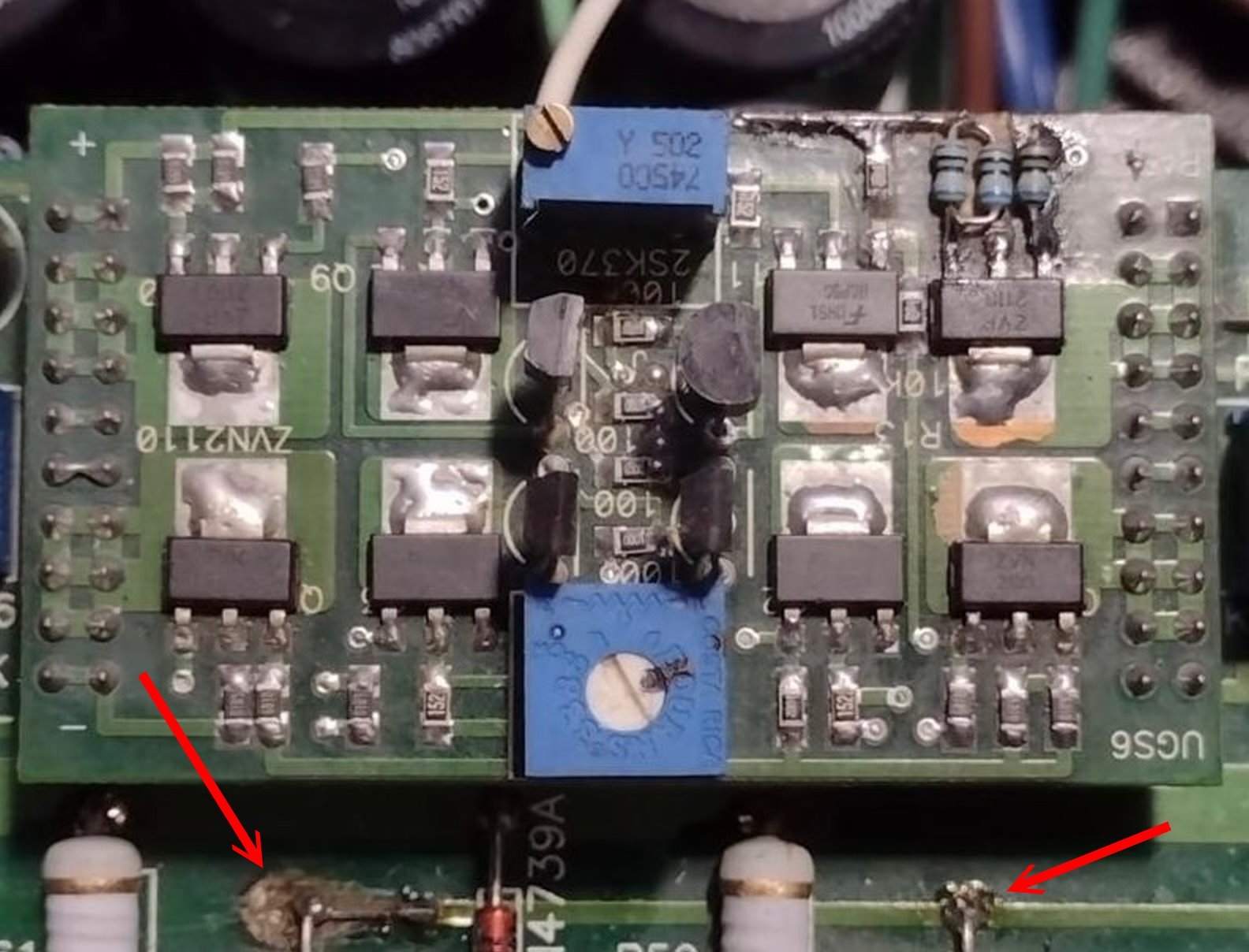

Hello, I'm having a problem with my pass the x250 in the right channel, when I turn on the speaker it goes out and returns to its position and when I turn it off it goes backwards and also returns to its position. Can someone help me understand what it can be? Thanks a lot
Hello. This plate is the one that is broken, how could I get one sent to me?

That UGS (universal gain stage) board appears to have already been repaired after a via was vaporized or damaged. Also, the main board has also been repaired. Can you contact the person who did these repairs?
I bought it like this and the technician to whom I left it now asks me to replace the plate since here in Argentina the parts for repair are not obtained.
