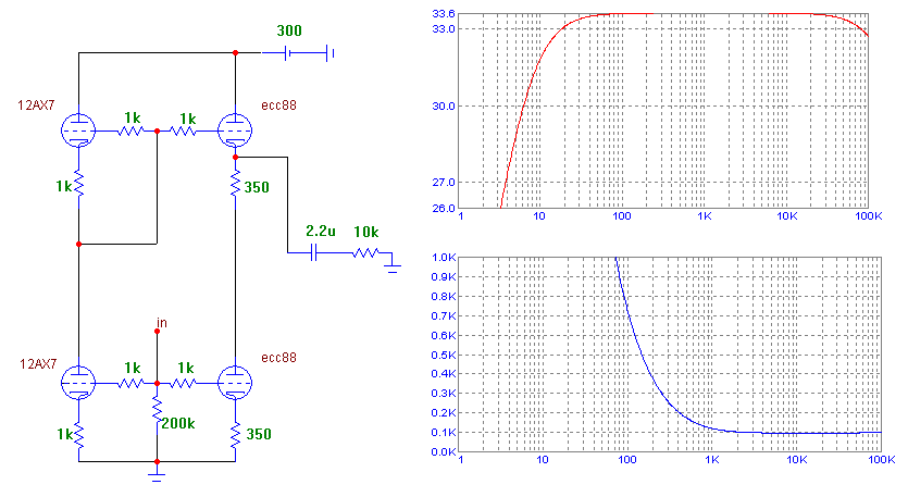

In the simulation of the schematic I join to this message (gomez) not made by me, It appears the coupling capacitor to be of 2,2uF.
This capacitor value makes not possible to the output impedence to be very low at lower frequencies.
As you can see the out Z will be around 100 Ohm, only until 1 Khz.
Than will increase.
Now: HOW DO I HAVE TO CALCULATE THE EXACT VALUE OF THE COUPLING CAPACITOR IN THE SAME CIRCUIT SHOWN, TO HAVE THAT OUT IMPEDENCE (around 100 OHM) UNTIL THE LOWER FREQUENCIES (LET'S SAY 20 Hz)?

...still help!
Hi!
If, for example:
- we have a BJT buffer (power amplifier of 200 watts max, with no voltage gain) with approx 10KOhm input impedance (in the schematic attached to the first post we drew it with a simple resistor)
- I want to drive this buffer stage with the gomez drew as above,
- I want an hi control also on low frequencies
using a coupling capacitor of 1-2-3... or 10 uF (max) causes a very high output impedence of the Voltage stage, exactly where and when instead I need big "control".
The possible solutions:
- can I use a coupling capacitor of around 100 uF to have same impedance at 20 Hz?
- Don't you think using this big capacitor will worsen the sound, especially on mid-hi frequencies?
What kind of solution would you recommend (or use) in situation like this?
Thank you very much

Hello, and thank you for your advices!!
My doubts come from the simulation in "gomez.gif" (1st post), when you can see the output impedance increase a lot at lower frequencies.
And this is also when the bjt stage input impedance remain the same (let say 10 Kohm).
So it is true the low bandwith is -0.5 dB at 20 Hz, with a coupling cap of 2,2 uF, but it is also true that if the driving impedence of the BJT stage increase at 1Kohm or more, It will lack especially the bass controls.
We have the same effect if we use a Tube voltage stage with 2 Kohm output impedence (like 6Sn7 SRPP) or the same stage with, for example 6H30 (300 Ohm output impedence).
I want to say that is clearly listened the differencens IN LOW FREQUENCY CONTROLS between the two stages (I mean better 6H30 stage) ALTHOUGH both stage have 2,2 uF coupling cap and -0.5 dB at 20 Hz!
What do you think?
Thanks!!
** So it is true the low bandwith is -0.5 dB at 20 Hz, with a coupling cap of 2,2 uF, but it is also true that if the driving impedence of the BJT stage increase at 1Kohm or more, It will lack especially the bass controls. **
Sorry, maybe it is not enough clear: I want to say:
It is true that the low bandwith is -0.5 dB at 20 Hz, with a coupling cap of 2,2 uF, but it is also true that
if the driving (VAS) impedence that the BJT stage sees, for istance, at 40 Hz, has increased at 1Kohm (or more... see the graph above), it will be (IT IS!!) very audible the consequent lack in the bass.
