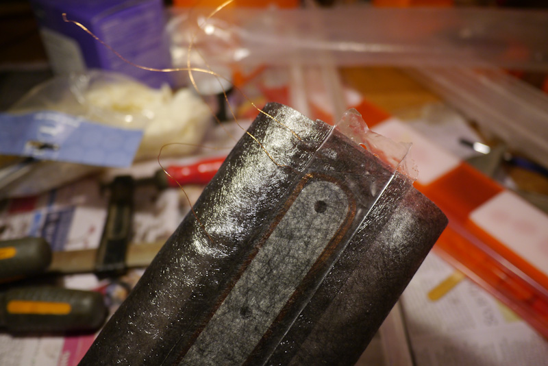

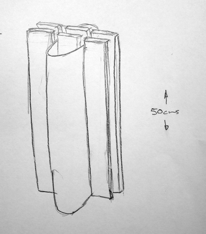

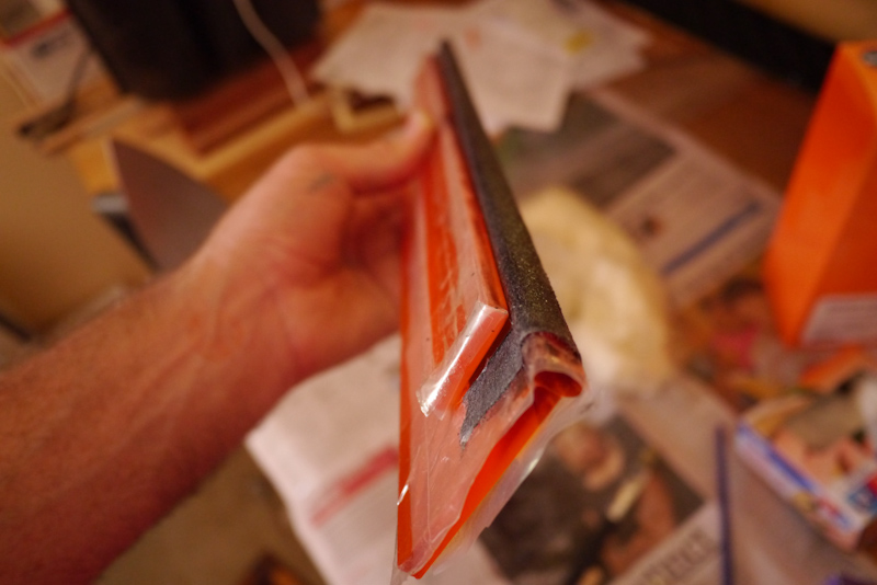

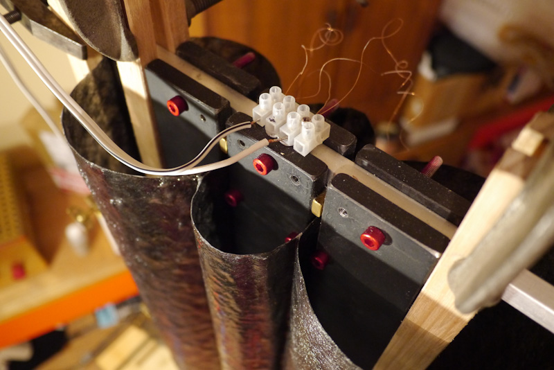

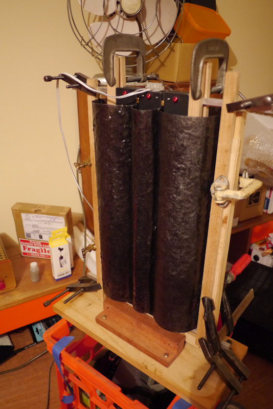

Here are the beginnings of making a variation on the rubanoid design, inspired after reading the wonderful experiments of WrineX and sergiu2009, and then trying my own triple-segment version, which sounded amazing but was full of flaws. I have now decided on a greatly simplified design using a pair of transverse coils down one single cylindrical membrane - like the triple design with the two sides taken off.

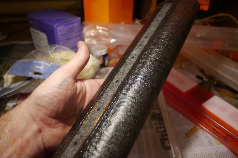

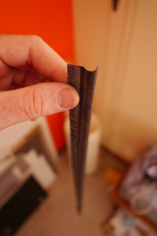

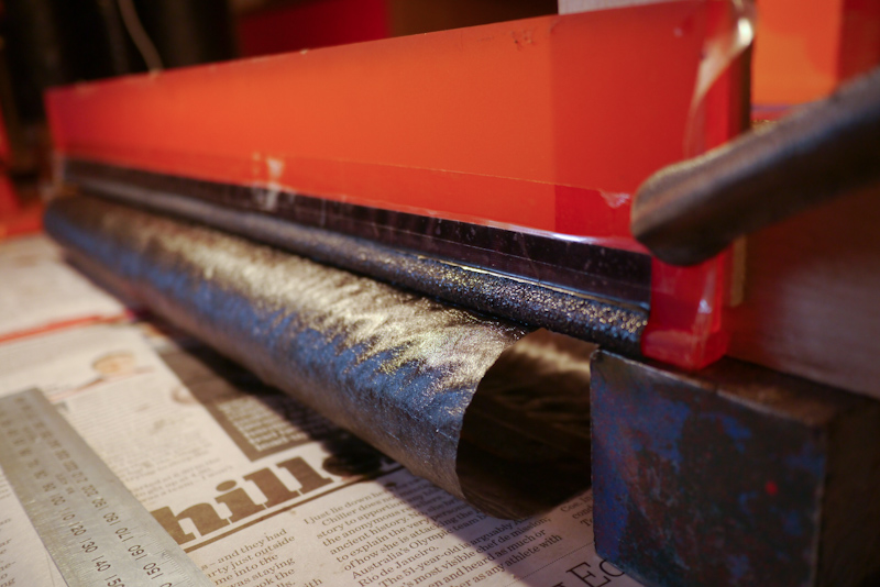

The cylindrical membrane is laid in carbon fibre tissue, so keeps its shape even though it is very thin - weighs only 32grams with the two wire voice coils embedded, and will only get better as I work out how to lay in the epoxy next time....

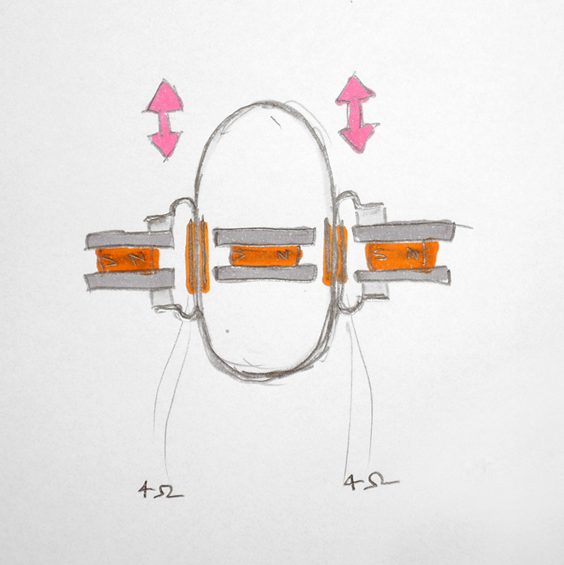

The basic design is to have voice coils down the length of either side of the cylinder, which is set within three strips of magnet bar (similar to all the rubanoid designs, but using 3 instead of 2). So I will have a (theoretically) uniformly driven membrane, that distributes the force nicely over the curved cross section. But we shall see - it may sound terrible!
This comes from my trial 3 section rubanoid, which worked as a trial, using similar 2 voice coils trapped between the middle membrane and each side. THIS IS THE OLD VERSION - THE NEW VERSION WILL BE ONLY THE CENTRE CYLINDER, changed in dimension and proportion....
This is my little video of it playing.
The membrane was far too heavy, very inefficient, but had amazing bass - real drum like beats so punchy and fast. Very directional.... Interesting sounding - compelling - and well worth the effort, but time to change some of the basic notions I think.
OLD DESIGN WITH 3 SECTIONS -
I think the new design with a single cylinder, driven pistonically, eliminates possible weird breakups as the vibrations move from the driven section to the stationary side wings that are characteristic of the rubanoid style. Maybe. I am just guessing with my own ideas. Whether it works or not, it will be a pain to get the membrane in and trap it between the magnet bars - I have some ideas about how to do this but it may be done completely differently while attempting.... And when it is done I shall hear if I have any idea of what I am talking about. : ) Fun.
Not having the wings means I need some other way of centreing the cylinder in the 5mm magnet gap, and I am trialling making long rubber roll surround - mould-making silicon impregated into open-weave fabric, set on a small hump mould to make the right shape, and then siliconed in place onto the membrane. This will add some weight to the moving mass, and the only other idea I have had is to suspend the cylinder between very thin wires of spring steel top and bottom. Not sure, but I have hopes for the rubber roll suspension. There will be 4 strips - front and back, both sides.
Next is making more rubber roll surrounds and attaching them to the membrane, and then seeing if I can position it within the magnet bar structure accurately just with the surrounds....
If anyone has any thoughts or suggestions, please let me know. I am good at making, and can think things through pretty well, but i can get caught up thinking only one specific thing, and all of a sudden, i am in the muddy gutter at the side of the road, tears down my face, and no idea how I got there. But hopefully these speakers are a very sunny trip in the country.

Hello,
There is too much resin and you membrane seem too heavy.
You should use a sucction pump, the carbon is a lot too wet.
And you should also experiment with high modulus vertical oriented fibers in order to reduce the weight and the holes in the diaphragm, there is a lot of weight to gain !

hello silverprout.
do you mean too heavy with the new version? the new one is only 32g including the 2 copper wire voice coils, and the whole diaphragm is 1/2metre long....? the old version has 3 lobes and is like you say too wet - that was the very first trial.... do you really think there is too much resin in the first - second - third picture? 32 grams including voice coils i thought was good after a few other experiments with this thin tissue.... : (
the new one will only have one centre section only - no side wings - and made from the thin tissue in the first picture....
and yes to holes in the diaphragm also. thanks. i read about it this from sergiu looking through rubanoid patents i think.....
not sure what you mean by high modulus vertical oriented fibers - i have trouble finding carbon fibre tissue of any sort online or in australia - please let me know where i can find it and i will buy and give it a try, if not too expensive!!! the only thing i can find online is on specialty research with nanotube graphene strands and looks like it might be a million dollars for a square inch....
i just found the weight of the old membrane with 3 sections like in the video - 220grams!!! hefty. : )

You should care about the resin and the weight because of use of a "too stiff resin" should be limited to the strict minimum in order to minimise the weight and to have a margin for futher doping resins.
You perhaps use strutural resin that is not designed for audio (damping) the carbon cone loudspeaker manufacturers often use critically damped resins whith muliple layers.
Your transducer motor seems underpowered for a high mms, IMHO you should make some modelisation in order to fix your T&L parameters for a good alignement.
High quality carbon materials and resins are extremely expensive... you should use paper if you are not very rich.

Hi Orangealpaca,
I'm glad that we inspired others with what we achieved.
Congeats for your triple ruband and for this ideea.
Here are my thoughts about your single cilinder ruban:
- you have pretty strong magnets, why not use 4 or 3 mm gap (like mine) , this way you will gain flux and some extra juicy dB;
- your cilinders are a bit bumpy from the extra resin, can you sand paper them or make them somehow smoother?
- i have seen that you use hand winded coil wich i think it has a poor surface contact and i suggest a flexible printed pcb or diy cutted coil from thin backing Al foil like mine;
- the originall ruban has one coil and two cils wich elegantly dampens the peaks but yours have a cil and two coils wich i think it will shout at some peaks so i strongly recomend ading at least 5 diagonally folds allong the cil if you can( this is what i want to try also) with an almost sharp big wheel . See, this is why i use paper: its easyer and faster to make, cut, fold add laq etc;
- your diy dumping foam hinges that you want to atach to the membrane, i think it will restrain the sound abit so i suggest you should make another membrane and hook some thin elastics (two or more in parallel) and then compare them and tell us the results.

sergiu,
thanks heaps for your reply. its so fun to make sound from the ground up. i make these speakers because i am so bad at playing the piano and making REAL music.... and i want to make something different, from the ground up where i can, and learn as much as possible on the way.
- 3mm gap - that sounds good - first i need to try and make sure i can keep both the sides evenly in the 5mm gap. but if so, i will try this, it is easy enough to change my spacers while levering apart the magnet assemblies. i like juicy dB's.
- the bumps from the resin are due to ripples in polyethylene covering the mould for release - next time i will stretch it better and use much much thinner material. hopefully get rid of all the bumps and ripples.... learning carbon fibre from the start here.
- for the diagonal folds i do not understand, but will keep watching what you do and learn from that.
- i will get these ones working with the silicon rubber surrounds, if possible, and trial what you suggest if it looks like the surrounds are reducing the membrane movement - they are very soft and thin though - very flexible. but not sure how they are going to work in the whole driver setup yet.
anti-bending system - fun. magnetic force is an amazing thing. a separate non-magnet frame and tensioning the bars out towards that? will be interested to see what you do - sounds heavy....

so i made the suspension and got the triple-magnet single cylinder rubanoid-like membranes to work. but they sounded pretty terrible.
there were peaks all over the place, and they were "veiled" in a way that was very disappointing. distortion. shouting peaks and silent valleys. i was supposed to measure them, but they sounded so awful it was pointless - unless they showed promise i was going to try the "standard" rubanoid design that everyone recommended and seems tried and true (ish...!!!)
i took off most of the rubber roll suspension, leaving little sections top and bottom - no improvement. i made a paper version, but it was not stable enough to stay true in the double magnet gap. i tried reinforcing it with some carbon fibre tissue and made it worse....
this design needs someone more patient, if there is any hope with it at all, likely because it is a silly idea from someone with no idea. the problem with making it work is the double gap - it means that the membrane has to be completely stiff and stable and stay in place. which is too limiting for materials. and too painful to make.

so i made a paper version to compare, and made it orange, because that is the best colour and makes any speaker sound much better.
as a pair, they are very mismatched, one carbon fibre and one paper, but i can already hear some very interesting things in the music now - things i have not heard before. it makes me love the music more. this is what i want.
i am crossing over at 200hz and running some 6.5" bass below. at first listening there was some sibilance of female vocals, but that has diminished a lot. there is so much spoace and air. and i can hear the plucking of strings and the wood of the soundboard. it is especially good with simple acoustic instruments and vocals. it gets a little confused with complex music. plays electronic better than i thought. : ) they are changing the way they sound in a few days also - i guess they are brand new....
the carbon fibre is perhaps 6db louder (by my knobs) - i have not measured it though.... the paper sounds softer and warmer though.
so now i am decided - i will make four of these panels - two per side - using paper. this design is so much simpler to make, using two magnet bars and attached membrane sides, and with the simple securing system i have, i can adjust where the membrane sits in the gap.
