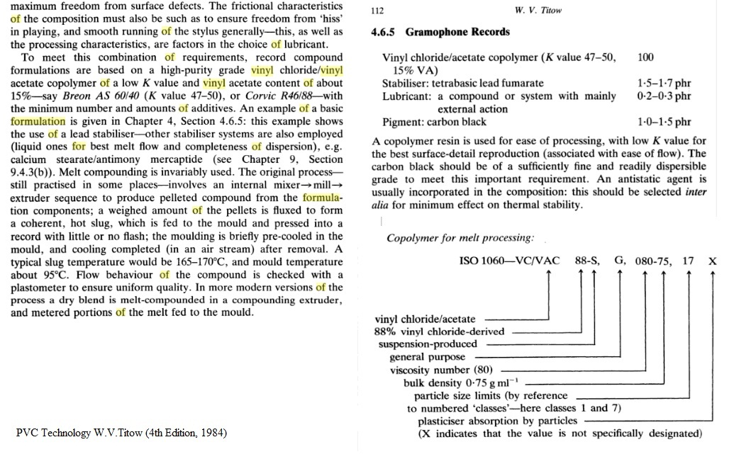

Attached, a PVC formulation for vinyl records. This is for SY exclusivelly 🙂
