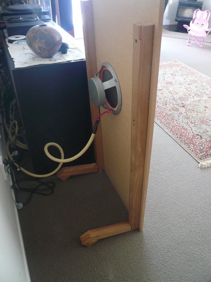

Nice job T110! You driver placement on the baffle appears to be ballpark for what usually yeilds fair results on "The Edge" baffle simulation software. Bass stil won't get real low and SPL will be excursion limited at some point, but it should be good within that range. Try driving it with a high output impedance SET amp or add a bit of series resistance to see it that improves things in this case.
As far as closed boxes go, the CG10T wants rather large ones. The smallest "ideal" box would be sealed at ~70 liters; if you stuff it well, it might give you Qtc=0.7 with f3 around 60Hz. A tight-sounding vented enclosure might be between 150 and 200 liters and a large TQWT might be the most fun for this, but certainly even larger.

Hi Papa. I havent ruled out using the paper H/F units. This is really a step by step project. Also with a fair bit of "winging it" thrown in. The H/F unit I have goes up to 17kHz I believe and the CG10T 15kHz so there will be gains if I feel I need them.

I also may add side panels of some sort. I have limited myself to cutting these MDF panels only once each (Driver hole) just because this is nasty stuff and I dont like the dust floating around in any way.

I ran these in their old cabinets (backs off) with my 130wpc Rotel amp to reasonable SPL's and noticed fairly limited excursion so this may indicate (hopefully) that the unlikely Rotel will keep the desired grip on the drivers...as long as I don't wind the wick up too far😉 This is really a bit of a low budget experiment to see if the open baffle H/E driver sound suits me. If it does tick enough boxes I'll be diving into valves boots and all.

As we can see on my previous graph, and as I feel it sounds in my room, the CG10T is not doing much above 10kHz, especially if you consider it's beaming by then, so the power response will be rather weak up this high. A helper tweeter that has f3 or f6 around 10kHz can do some good. Even if it does not make it to 20kHz "flat" it'll help out covering what's missing. I had some success with the current Eminence APT:80.

I'm thinking I may alter the angle of the baffle as it is leaning back more than I had thought it would be. I'd like it closer to vertical as I can get it.

The fact that the CG10T has a very soft top-end might somewhat balance-out witht the light bass it's likely to have on the OB, but it'll still be missing something. The RA cone tweeters can't be too bad and I'd sure give them a try.
