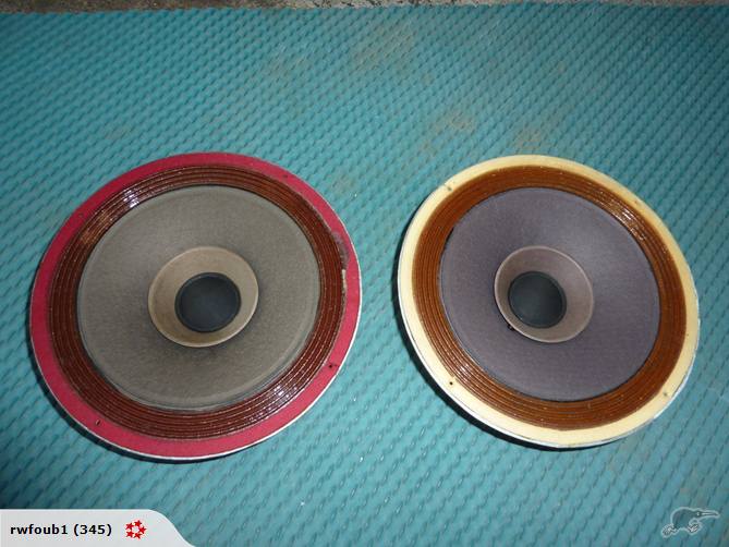

Hi all. I'm thinking of pairing up these CG10's and CG10T's in open baffles. Can anyone offer an opinion on whether I should add a simple crossover to the CG10 or just run them both without?
I'm seriously impressed by these drivers with Jazz and Classical.
Also as both drivers are 8ohm and I will wire them in parallel, I believe the impedance will drop to 4ohm so I may need an amp that will keep a grip on them. Valves are not an option at present and I may have my Rotel RA1062 spare soon. As long as I don't over drive the speakers, will this amp be okay?

When I had a listen the other day I drove them with a 130w Rotel power amp. They really did sound great. I think I'll go with no crossover and see how they sound. Thats the best way to start I think.
These Richard Allan drivers have a superb sense of timing and they sounded beautiful with jazz and classical.

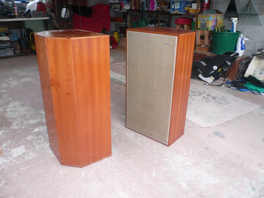

I may put the R/A project on the back burner for a while due to the unexpected discovery of these not two hundred meters from my gate.
They were waiting for the demolition team to come by and throw them in the truck! So after consulting with the ex owner I brought them home...

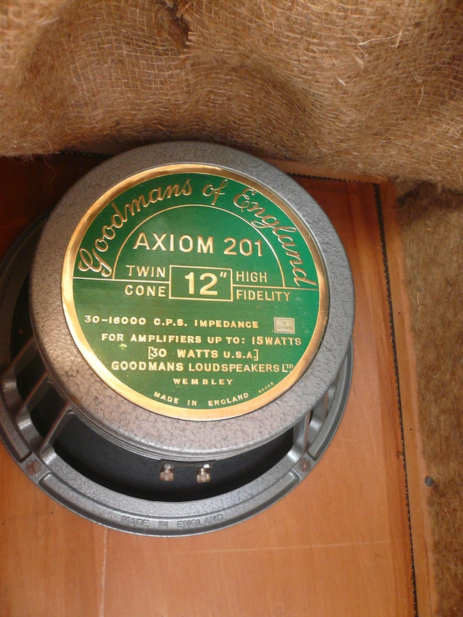

They are rather large Goodmans jobbies.

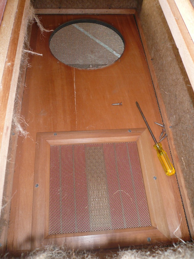

And here is what is inside🙂🙂🙂🙂🙂🙂🙂
I'm now thinking I'll use these in an open baffle instead. They do show great potential even in these old "soft" cabinets. There is also the pair of genuine(by the looks) A.R.U panels in the base of the front baffles.
Quite excited.

I have a pair of 201s running in open baffle at the moment. I note that your ones are the 3 rib ones, mine are the 2 rib. one is earlier - I forget which. I use the 201s as my everyday speakers, whereas the Richard Allans are doing tele duty at the mo"- I think tho' that the RA are my preference. Both classics tho'.
Nice find there T110! The Richard Allan CT10T might be quite good in these cabinets FWIW. Just make an adapter ring for it and try it. You can compare between both drivers in OB and these cabs to see what's the best in the end.

IG, after having a wee listen to the 201's I tend to think they are a better all round driver. The R A's seemed to not handle more modern genres of music yet loved Jazz and Classical.
This could all change once they are mounted to a more supportive and rigid baffle though.

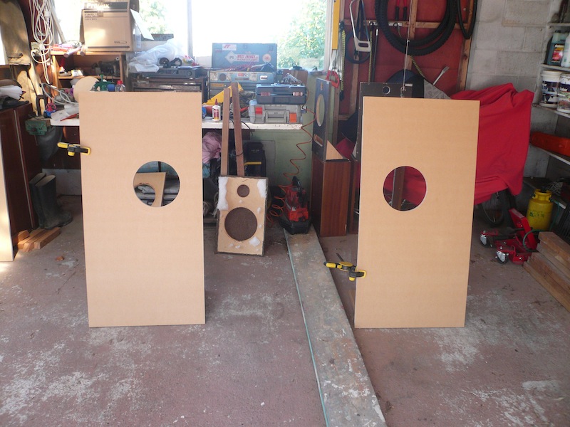

OK. It's been a while so this is my latest update.
I went back to my original project/plan re the Richard Allans.
In the end I decided to continue with these first before I started anything with the Goodmans.
Initially I was going to attempt mounting a CG10 and CG10T in open baffles however I discovered a slight voice coil rub in one of the CG10's. Therefor I am going with just the CG10T's.
Keeping it as simple as possible here are some pics of my progress.
I am limited with space so I went up rather than across.
I may add some side panels at a later date if I feel they are needed.
Wifey is worried about the size. 😀
Craig.

Are you going to use the hf cones too (I'm reluctant to call them tweeters, but that is what they are).
I just love the sound from light paper cones, not at their best on some modern music, but they do what they do do well.
I wonder if you have thought of a resonanting cabinet such as the ones used with Saba drivers (search on lencoheaven if interested), it seems to me that Richard Allans may be suited to this application, and a lot higher WAF.
Then again, if you can get away with it, open baffle does give you that lovely box-free sound...
