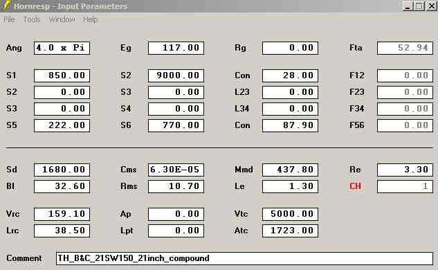

We played around a little with the 21SW150 in the collaborative and the PA (screamer) TH thread early in 2009. I think you are on the right track with your simulations. In the tapped horns it generally helps the impulse response to either set S1=1 after you have basically optimized your simulation, and/or to try increasing S5 to a larger value without altering any of the other parameters (for these changes, and in general, I recommend using all four sections in Hornresp, it's there, it's free, ...... 🙂). The frequency response of the 21SW150 simulations responds well to even small amounts of series inductor (e.g.: Rg=.1 / Le= add 2mH). There seems to be a difference in the driver parameters from a year ago, I would not spend too much time in Hornresp without having measured the actual drivers. Also, one type of enclosure that David McBean has added to his loudspeaker wizard seems to find little use: the compound horn enclosure, I'll attach a quick try for reference.

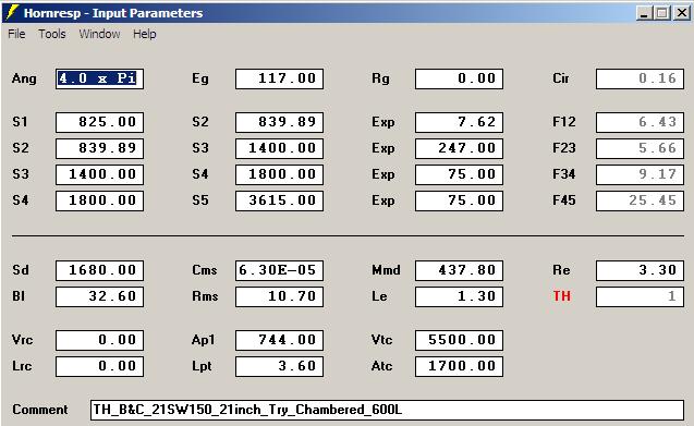

Hi Ricci,
Just one more thing. Tom Danley mentioned that Hornresp does not account for losses at high power levels, and there seems to be a general scheme that works e.g.: in the TH-SPUD: S1 about 1/2 Sd, S3(S4) about Sd and S4(S5) about two times Sd. This results in a bit larger response variations, but may be something to keep in mind.

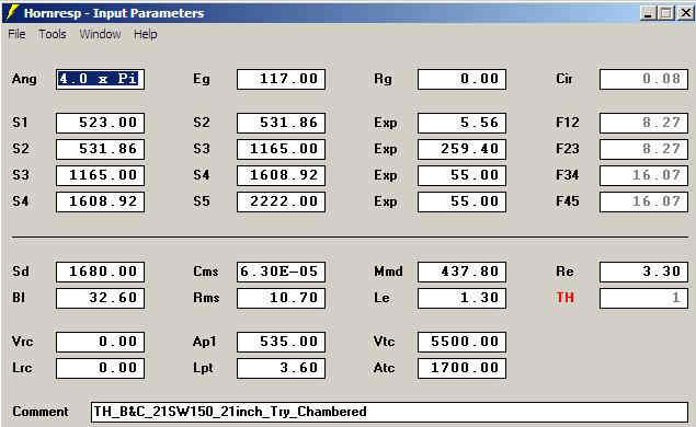

Hi Ricci,
In the TH-Spud the S1 is equal to ~Sd, S2 is ~Sd x.5, and S3 would be ~Sd x1.75.
With four segments change S3 to x1, S4 x1.5, and S5 to x2.

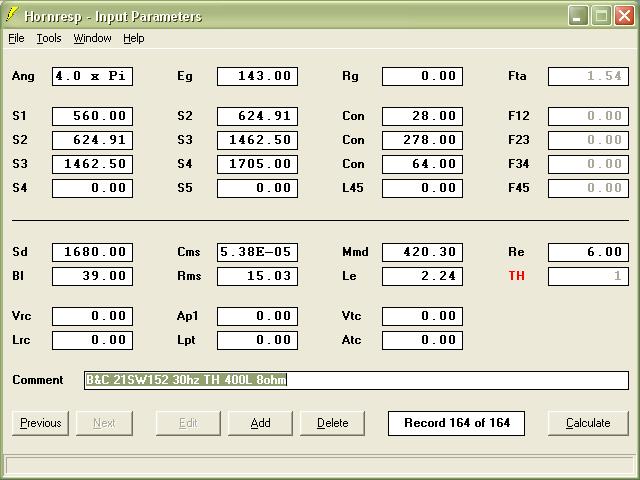

Hey guys. I've got the 8ohm versions. Here is the PDF. I put a dmm to the drivers last night and they both come out exactly at 6ohms. the modeling doesn;t appear too much different.
View attachment 21SW152-8.pdf
