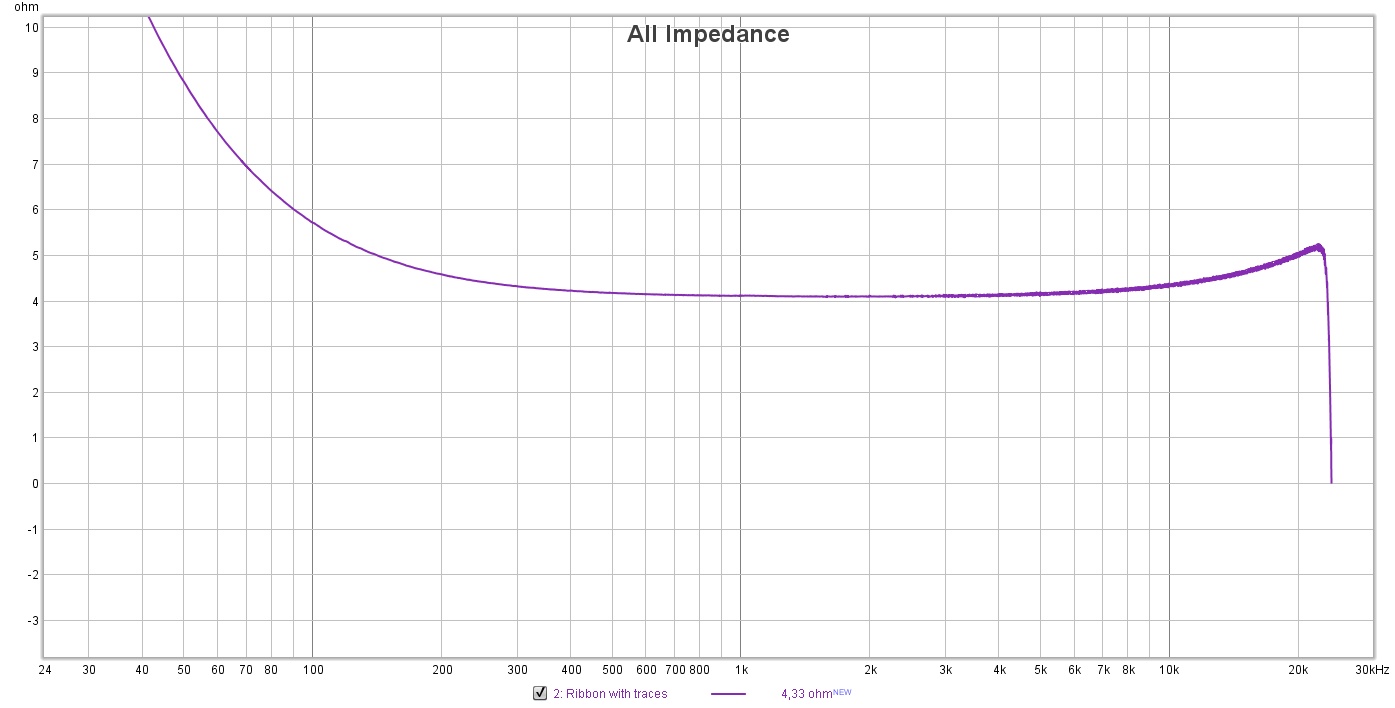

People asked many times why not use a transformer instead of my traced ribbon (a ribbon with traces just like a planar magnetic) it looks like everyone including me thinks/thought it might benefit the efficiency.
But is it actually ? If by any miracle my transformer impedance would be 4 ohm flat (i made a few and got 3.7 and rising worked fine), just like my traced one here (almost flat actually not sure why it rises slightly) PIC1
would one be louder then the other ? the only reason i could think of is (weight) being able to use 7 micron alu or 4 and it functions as membrane and conductor. are there any others? since all the ones i made with different transformers etc are within 2 db compared to the traced version, that might be only the weight difference.
Only when i would dip under 2-4 ohm they would be much louder.... but that same would be te case if i made my traced one go so low.
i know with small true ribbons, tranny is the only way. but for long ones 90cm+ it seems to be not much of a difference.
am i missing something ? i mean current driven ok, but the amplifier will dish out the same amount of current in both occasions. 4 ohm with tranny vs 4 ohm without tranny, both have the same power going to the device in question

SQ IRL ?? im not sure what that means :) but i did try several combinations on the primary and or secondary both ending up in a decent 3.7 ohm going up to like 6-8 ohm or something in the top end. (so the top end is a bit more efficient in terms of power used, when the FR is equal)
But yeah if a true ribbon is used a transformer is a must (or blow allot of power in a resistor when the magnets are strong enough to compensate) since i always use affordable magnets :) i cant go resistor route. but my big ribbons consist of traces just like the apogee ones, you start at trace number one then feed it back down by means of a good conductor outside the field and feed it into the second one etc etc. so i can make any (well only if the ribbon is long enough) resistance i want. for the tranny version i indeed beefed up all connection wires and transformer conductors to parallel 1.5mm2 copper. results remains the same as my traced version within a dB or 2.
