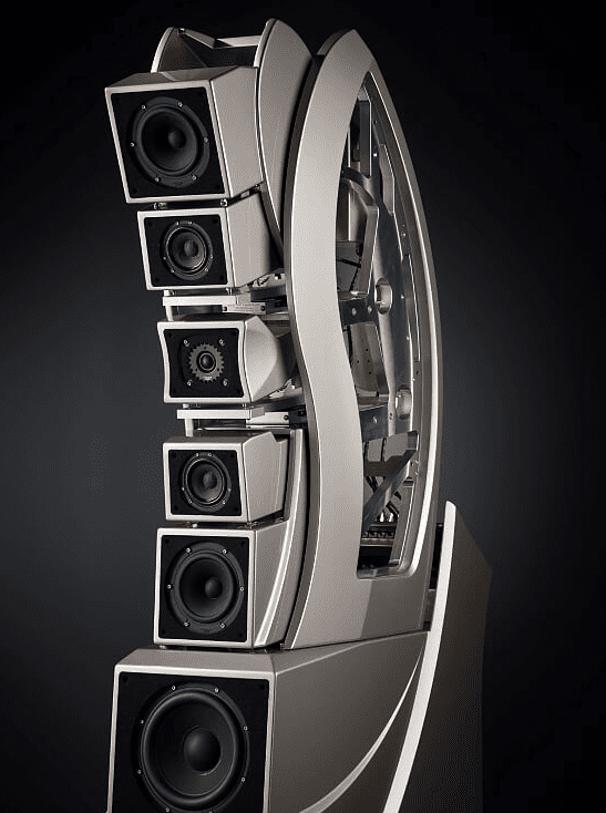

-with a few designs like the Wilson Audio: you can actually alter the image diffuse/stretch depending on listener distance (..derived by being a little farther back from the loudspeaker than optimal), which can be useful to achieve a more 3D image.

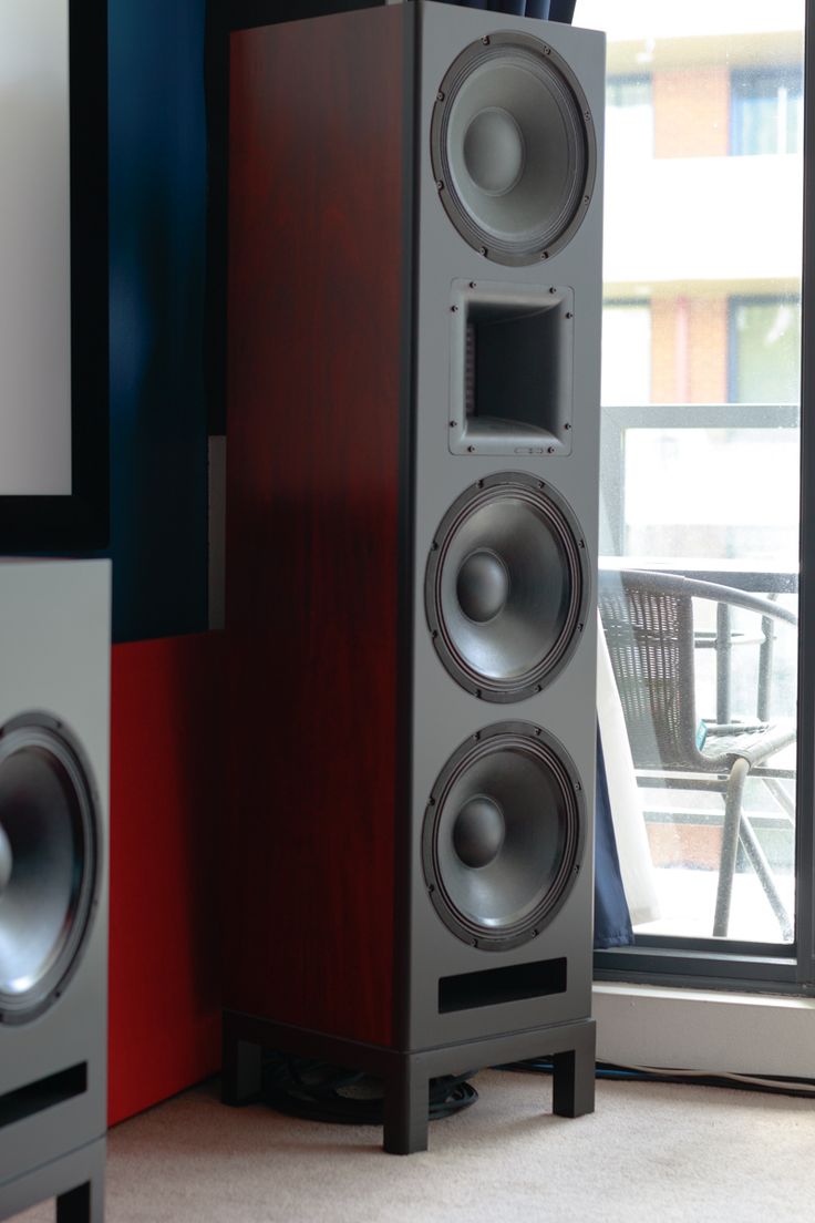

As suggested, the non-waveguide version is not symmetrical if you cross it around this suggested band, however a round driver would be axisymmetric. As a result there is no exact best place there to cross and you'll be relying on measured averages.
I swear someone crossed the tpl150 over at 700hz...crossed to a 12"....
I haven't seen it. Vapour Audio makes a 2-way with TPL-150H crossed at 1.1kHz to a 10". I haven't come across lower xo for this driver. Most people cross around 1.6kHz. There was a thread back some time ago where a resonance was measured around 1.8kHz so crossing at 2kHz seemed ideal from that point of view, but challenging to achieve with a large midrange and such large tweeter - at least on paper.
The non-H version, of course, requires a higher xo.
I recognize those (Vapour) maybe I confused them...1050hz XO is pretty low for the beymas as it is....

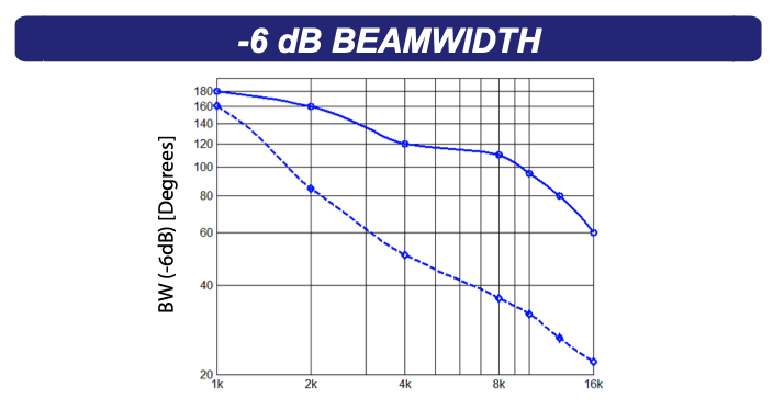

But ribbons are very directional. For instance, it's not unusual to see ribbons that have as little as 10-30 degrees of vertical beamwidth.
If we agree that the main problem with one wavelength spacing is the fact that they generate a ton of output into the ceiling and the floor, then the use of a ribbon tweeter can be a valid solution to that. (Because a ribbon tweeter generates very little output into the ceiling and the floor.)

The narrow vertical beamwidth of a Beyma TPL-150 actually only is there at higher frequencies. The data sheet shows this, be it quite general. The dotted line is (should be) the -6dB vs angle vs frequency curve.One thing that's worth considering is doing an MTM with a ribbon. Because a PAIR of midbasses can have narrow vertical beamwidth, matching the narrow vertical beamwidth of the ribbon tweeter.
