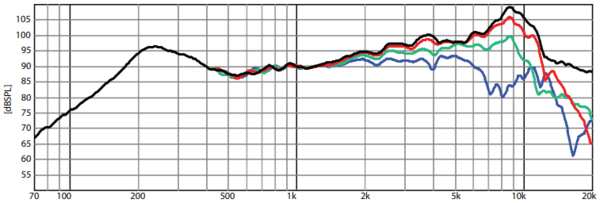

GRS has a 10" and 8" Planers.
Impedance as usual, is pretty flat.
What would be considered resonance
is around 250 to 330 Hz
GRS PT5010-8 ohm 10"
GRS PT6825-8 ohm 8"
GRS PT6816-8ohm 8"
The bigger PT5010 could go down to 500 Hz

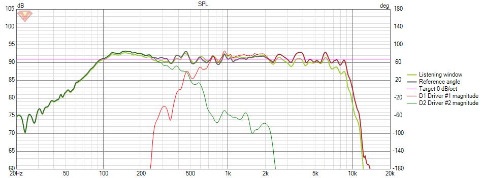

I played around with it in sim with 4th order crossover.
Response looks little roller coaster and has rising top end.
I got it flat in sim with passive crossover.
About 91 dB
Looks about like this
And quick sim with live sound 12" woofer got it to this
Ironically about 500 Hz crossover. likely add another
ribbon at 3k or 4k. Shown on bandpass I never added
a tweet, was just playing around with it.
