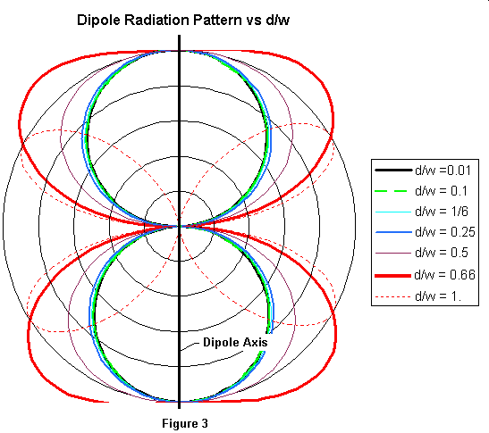

The Beston Ribbon Dipoles look like a good alternative to the now popular BG NEO3. The diyAudio community will be interested in your evaluation, and experience with the 10 channel Focusrite Safire.
JohnK's musicanddesign.com website provides a good education on the value of controlled directivity dipole speakers. JohnK provides data illustrating why the crossover between the dipole tweeter to a small area dipole upper midrange is critical for controlled directivity. It is important to keep the center-to-center distance shorter than one half the wavelength of the crossover frequency(fig2). JohnK's NaO Note uses the BG NEO3 and the well reviewed 3.5" Scan Speak 10F/4424G00. There have been discussions of similar designs using an 8"-10" midbass and a 15" or 18" H-frame dipole woofer in order to reduce both the speaker count and height.
MJK's quarter-wave.com website has great info on using a high Qts 18" woofer in an H-frame to generate enough dipole deep bass that a monopole subwoofer is seldom required. In the USA, the Goldwood GW-1858 Woofer from PartsExpress is one low cost favorite. In the USA, the Lambda TD8D 18" dipole woofer and 10" TD10D dipole midbass are popular for "ultimate dipole $$" dreaming. The 10" Eminence ALPHA-10A with Qts ~ 0.6 is a popular low cost dipole midbass.
The information on these websites might help you select the best of your options to build first.
