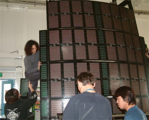

Correct, MAD subwoofers use 12 - 18 " conventional drivers - dipole (I used to work for those MAD guys).
Here is a pic. of the largest push-pull magnetic-planar drivers (by FPS); subwoofers also use conventional woofers.

Yes, see post 13. The large (264x364mm) FPS planar driver is good down to 200Hz.
