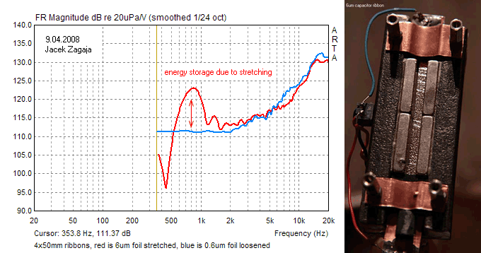

Let consider 4x50mm ribbon immersed between 10x5mm magnets and 1:37 low inductance transformer (RCA 1931 type) which is flat measured at secondary (no primary load). Electret microphone is as close as the centre of the transducer as possible. Stimulus (MLS, sine sweep) is connected to the secondary at level 0dBu. What causes rising top end response?

dunno, looks a lot like a 6dB oct boost? If I recall what I saw last night... also check the mic against something else?
check how it measures at double the distance?
consider some effect of the presumed matching transformer also - possible HF resonance in it?
_-_-bear
Oh, also use the mic to monitor a pink noise source into a driver known to be reasonably flat - compare the measurement mic to the test mic??
_-_-bear
What do you mean by "low inductance transformer"?
You graph looks like inverted on the top end.
Judging from the picture and known dimentions, the path is about 40mm which translates into 8.6KHz null.
Sure, becasue of pretty big cavity and resonances the null can be much smoothed, but it still does not explain that raise and HUGE peak @ ~18KHz.
But wait a second... your ribbon is not corrugated, so it basically works like a marimba bar. Eyeballing the size and considering the weight of 0.6um ribbon it makes much sense of its self resonance of 18KHz.
Make your ribbon corrugated and the whole mic will turn into a perfect mass controlled system, with a smooth response over the whole bandwidth.
Best, M

Now my ribbon is corrugated. Please notice that rising top end doesn't depend on foil thickness.

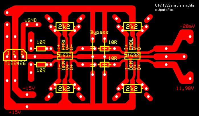

At the moment I moved back to microphone and amplifier. My OPA1632 trial was unsuccessful - output is highly unbalanced. Schematic appended.
Anything changed with corrugated?
Can't measure - it's too silent. But wait a minute - 10k output impedance from souncard and 0.1k from ribbon. Should I use buffer?
From the other hand I have used my 1:8 tranny and Tripath amplifier. I couldn't measure with my laptop integrated sound card (noise, weird impulse response). With Digigram and it's balanced output I've got again low signal from power amp.
Rising top end is still visible.
Confused again :dead:
Perhaps you can put a FET follower from the ribbon to drive the transformer, or a low noise opamp as a direct amplification for simple measurement??
It won't be quite as quiet as a standard ribbon mic setup, but you want a good response curve, not lowest noise.
How are you measuring this mic?
What's the source of excitation?
Or, are you driving the mic as a speaker and then using a measurement mic??
Did you compare to a known source?
Is there some sort of compensation turned on in the soundcard/sorftware?
etc...
