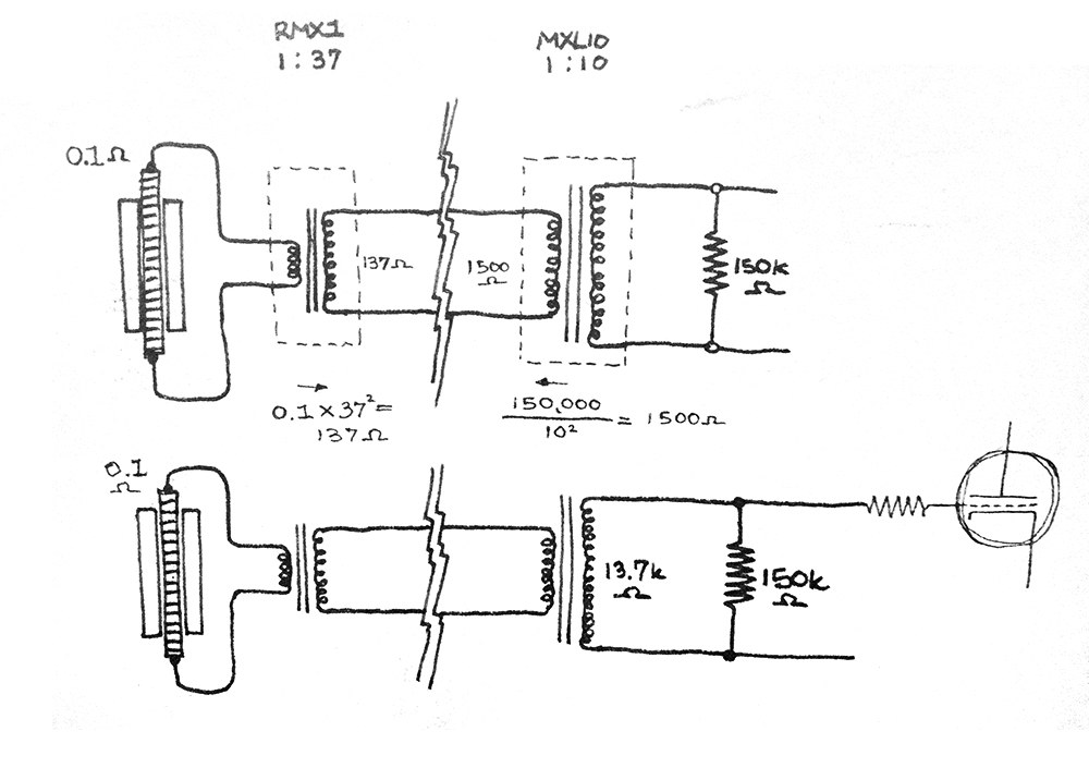

thankyou for the walkthrough! This is starting to shed some proper light on my confusion. I have attached some diagrams of me laying it out to make sense of it. One question I have rolling around in my head was : Grid leak resistors. Does the 150k act as a load and a grid leak at the same time?

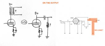

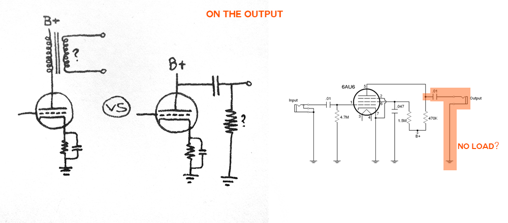

Also... What about the output stage of the preamp. That one diagram earlier had no output transformer... and no load resistor? What good would that drive?
For me, im interested in writing to my macbook which apparently presents a mic input impedance of 20kohms. What does this mean for the coupling part of this? Because of the high load... I could get away with a capacitor set up? or am I rather far off base here.

Your diagram indicates you have a good grasp of what is going on in the transformers.
The input impedance of a tube is essentially infinite but for biasing purposes the grid does need to be referenced to ground. As there is normally no grid current you can use very high values of resistance but the actual value does not matter and is usually chosen to set the desired input impedance. So, in this case the 150K does both jobs.
Depending on the sensitivity of your mac book mic input and the loudness of your acoustic source, you might be able to simply connect the output of the 1:37 transformer directly to it without any intervening amplification.
If you do need the extra gain then either of your proposed schemes will work. The 6AU6 wired as a triode was one of the very first tubes I tried as a mic pre. I used a 390 ohm cathode resistor and a 39K anode resistor which produced a gain of around 30dB. I would try the RC coupled scheme to start with. The resistor from the output capacitor to ground is there mainly to provide a dc charge path for the capacitor so its value is not critical - anything over 100K should be fine.. The output impedance is defined by the tube's plate resistance in parallel with the 39K plate resistor. I would guess this would be around 10K. This will drive a 20K load but it clearly does not meet the 10:1 impedance rule for no loss. This implies the transformer output might be a better option. One of the Edcor 15K:600 output transformers could work well here.

I just have one question while I think about these things: What are the cons of a RC coupled method? It just looks so damn simple compared to the transformer alternative. cost, size, and potential room for distortion. I also feel that transformers for coupling act as giant magnetic pickups from nearby EMI etc. Or is the big pro for people the impedance control?
Hi Ruffrecords,
It's no surprise that its a little of them all. The main one is impedance and drive capability. As I mentioned, the output impedance of the 6AU6 triode stage will probably be in the region of 10K. This is too high to drive normal pro inputs which an input impedance of around 10K. Using the old 10:1 rule you really want the output impedance of the 6AU6 stage to 'look like' 1K or less. This is the main drawback of the RC method and where a transformer comes in. We need to transform 10K into about 1K so a turns ratio equal to the square root of 10 will be about right. This will be a step down transformer and the output will be 10dB lower. So our overall mic pre gain becomes 20dB from the mic transformer plus 30dB from the 6AU6 minus 10dB from the transformer which equals 40dB. No too bad but a little on the low side.
Modern transformers produce very little distortion at normal signal levels and are not really prone to magnetic pick up unless you do something silly like stick a mains transformer right next to them.

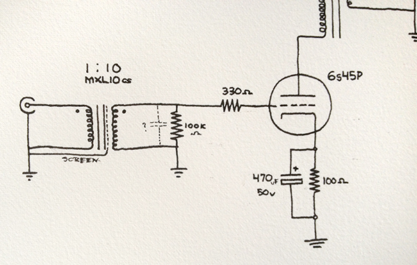

Hi guys, these are all excellent points that are brought up. Again, trying to take it all in.
Although in my peripheral, I would like to design a preamp. More specifically, a 6s45p. I havent drawn up the values yet (and all the transformers that would come attatched to it) but I was curious how this special tube would perform at small signal. I only hear great reviews about it.
And then for this noise deal, how exactly does resistance equate to dB of noise? the Lundahl you show here appears to have under half the quantity of ohms (264ohms) compared to the Edcor... which I purchased. I hear that people really dig the Edcor but what precisely am I combating here.
You are combating thermal noise. In a 20KHz bandwidth at room temperature the noise voltage in a resistor R is just the square root of R/3096 microvolts. So 634.6 ohms of resistance produces about 0.45 microvolts of noise which is about -125dBu. On a quiet source, a ribbon mic might need 70dB of gain so this noise will be 70dB higher at about -55dBu.
For the Lundahl transformer the resistance is about 127 ohms which gives a noise voltage of 0.197 microvolts or about -132dBu i.e it is 7dB quieter and after 70dB of gain it is -62dBu.
Note, a good low noise preamp will have an equivalent input noise of around -130dBu at 70dB gain. With the Edcor transformer its noise is the dominant one. WIth the Lundahl, it and the preamp are nearly equal contributors.

One more critical issue- the loading of the secondary of the input transformer. If you just load it with the large value grid leak (which will be in parallel with the tube's Miller capacitance), it's likely to ring. Especially transformers with high step up ratios. Typically this is handled by a series RC network in parallel with the input transformer's secondary. The values of the RC usually have to be determined experimentally, but when you do so, be sure to drive the primary with the same source resistance as the mike+step-up transformer.
FWIW, I second Ian's recommendation of the LL2912 for the ribbon step-up transformer- that's what I used in my mikes and it worked superbly well.
Many currently available 1:10 step up mic transformers (Sowter, Jensen, Cinemag) recommend a plain 150K resistor loading.
Cheers
Ian
Yes, but you don't get that in most designs because of the shunt capacitance of the first stage. The source impedance from the mike also changes the frequency response, so a blanket "just load it with 150k" is somewhat disingenuous. A few minutes with a square wave generator and a scope (as well as a few resistors and capacitors!) will pay great dividends.
