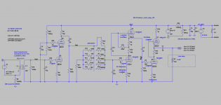

Here is new high gain preamp. First stage is 6N23P cascode, second 12AX7 mu-f, third is 6N23P SRPP. Overall gain is 84dB without input transformer. With it it is 103dB.
I have some issue here. First and second stages have very low THD: 1-st 0.004%, 2-nd 0.0005%. But third drastically drops to 0.07% whatever I do. It becomes a little bit better (0.025%) with 6N6P tube (with a little bit less gain).
How to improve THD of the 3-rd stage?

Distortion in triodes is proportional to signal level. The first two stages have very small signals so their distortion is understandably low. You nearly always get most distortion in the last stage. 0.07% is a very good figure for an SRPP. What was the output signal level and what load did you use?
By the way, 103dB of gain is far too much - you will be like to get a 20dB S/N ratio. I think you can do away with the middle stage.

To woodrough.
LTSpice has some noise simulation, but I do not have knowledge how to use it. Need some training. Also I am not sure if tube models include everything for this noise simulation.
Idea of input transformer is to bring signal up to make it higher above tube self noise signal. On next stages signal is already high enough so tube noise may be ignored. It is my feeling and should be checked.
To put a transformer instead of mid stage? It interesting idea. I even saw somewhere transformer based attenuators.
But 1-st stage should be powerful enough to push through 1:100 transformer, and 2-nd stage should have very high input impedance.
Another thing, transformers do not produce noise, but on higher signals transformers bring other types of distortions.

if 0.07% is a very good figure for an SRPP is there a better topology?
Yes may be 104 dB is too much. That is why there is attenuator in the middle.
Woodrough mentioned about a need to amplify quiet sounds.
Most of mic sensitivity specs are based on 1Pa of sound pressure that is created by 90dB sound. It is quite loud sound. I've put speech level 60dB into a formula that is 0.02Pa SPL. It produces just 0.6uV on ideal ribbon (unfortunately I do not have ribbon mass in the formula). So real ribbon will produce less. Anyway, mic transformer 1:37 makes it 22uV.

Without mid stage it will be 64dB of total gain. Will it be enough for amplifying weak sounds without adding noises?
A wild idea, to make 2-nd stage switchable.:eek:

You are probably not getting enough gain from the first stage. Try increasing the anode resistor and you definitely need to decouple the cathode resistor from the hum point of view.
Also I think you are running the SRPP at too high a quiescent current. 5mA is ample. At 15mA you are probably exceeding the tube's dissipation spec. You should also decouple the bottom cathode resistor. The transformer gives you 20dB gain, the cascode should be at least 30dB and the SRPP will be close to 30dB for a total of 80dB. 220uV is -73dBu so 80dB of gain is ample to raise this above 0dBu.
Both the SRPP and the cascode produce distortion because the top triode is a relatively low impedance load for the bottom one. The mu follower produces much less distortion because the top triode presents a high impedance load to the bottom triode. For minimum distortion you could use two stages of ECC88 mu followers each of which will have about 30dB of gain.
Thanks Ian, I'll try.
I thought that bypassing just removes local NFB improving gain. And as soon as we already have plenty of gain with 3 stages we can sacrifice a little bit gain and also improve sound by removing caps.
Hum should be eliminated by heater elevation. Is it right?
6N23P has 20mA max
220uV is after the input transformer. So it will be added by 60dB of tube's amplification, that gives -13dBu. Will it be enough? And again, it is for an ideal weightless ribbon. A real ribbon with mass will produce less voltage.
Yes, and we go back again to PhonoDude! But someone here said that a mu-follower output cascade can work effectively only to one input impedance. that is why I've changed that to White follower, and then to SRPP.
May be it would make sense to change SRPP to White again?
With White follower as an output stage it gives 1.1V output p-p, 72dB without inp transformer, and 0.003% THD. And it is one coupling cap less.
It looks like its a way to go. What do you think?
