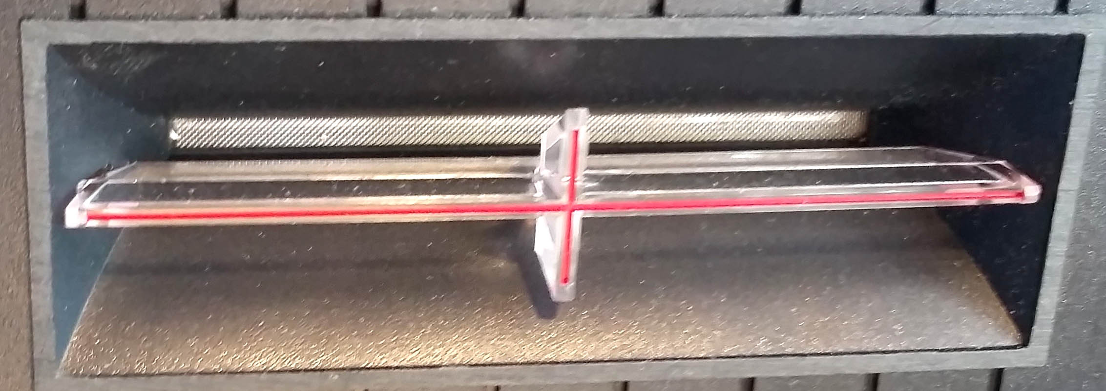

Unrelated question: would removing the center clear plastic piece give me wider dispersion on the tweeter?
I wouldn't mess around with the tweeter construction at this stage. It won't make much difference and might wreck the tweeter.

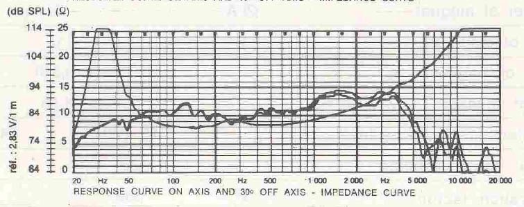

More important things to do. This is an Audax HD20B25H 8" bass it seems.

Are these speakers worth refurbing?

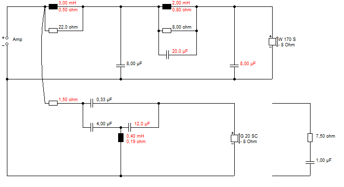

Some of the images are now broken, but I had a stab at the crossover for the Audiomaster MLS4 years back in that thread. I was working with amateurs there, so can't say much for coil values, and I'd have to rerun a sim to see if it works, but I still have some of the images. I think I could knock that into shape. Looks like a 1.5kHz LCR notch needed. Maybe impedance correction, which is going to be around 7.5R plus 15uF.
The great Robin Marshall worked with Audiomaster and Tangent, IIRC. I think we could dig up a bass filter for this Audax HD20B25H driver somewhere. Or synthesize one. The tweeter will be relatively easy, after that. I must sleep on this.

system7: You're starting to lose me in complexity, I am a simple man. The speakers cost me only slightly more than the Polydax/Audax woofers might fetch at auction, and it appears these ribbons are not highly regarded. The crossovers you propose may exceed the value of price paid and I'm not sure it would yield audio nirvana. Perhaps I keep my Celestion Ditton 100's and admit I'm over my head. (Dittons recapped. Lovely).

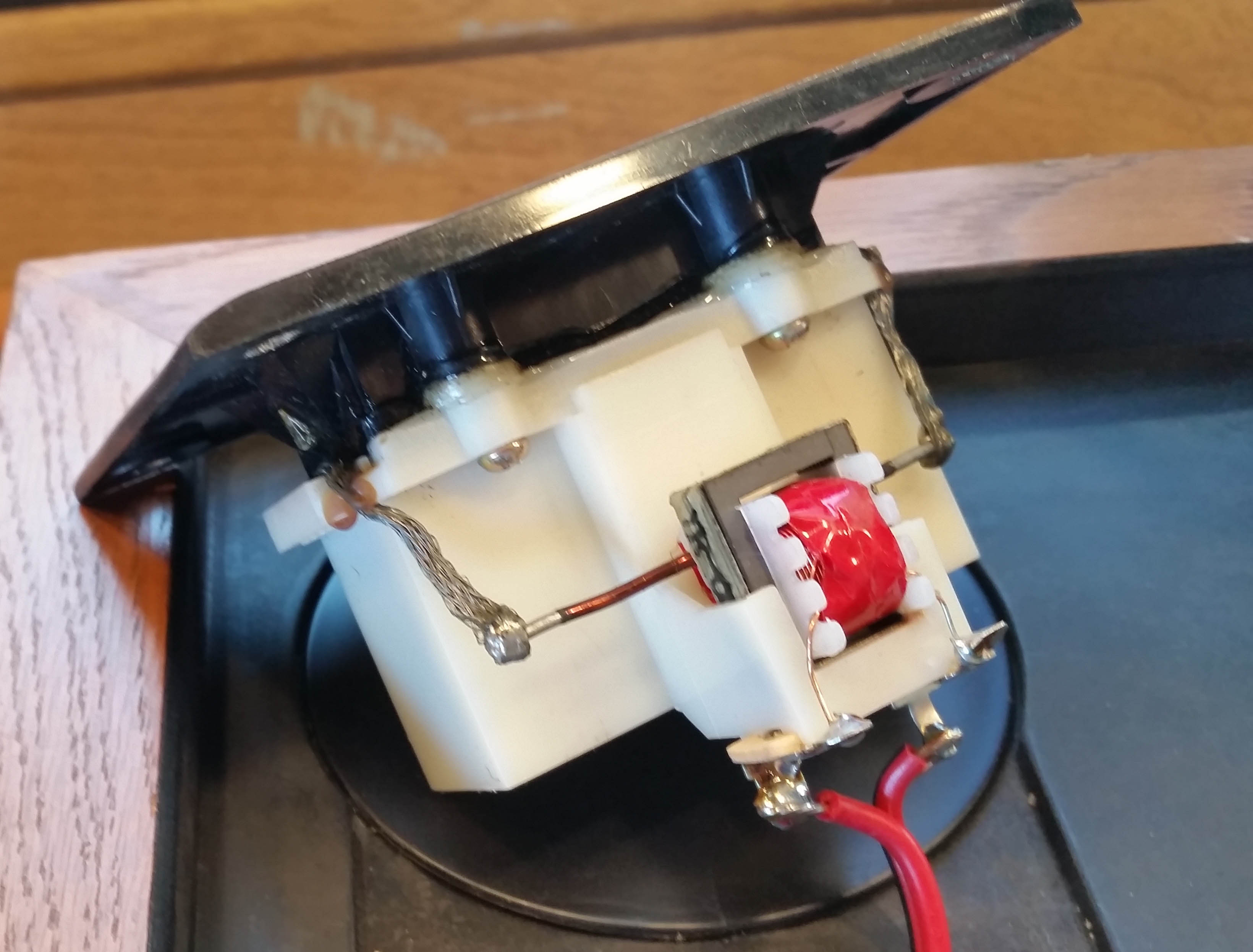

Galu: The tweeters appear to have an inductor installed already, so is the second suggested inductor extra insurance?
As I illustrated in post #10, the red thing on the tweeter is not an inductor, but is a transformer. I won't go into what it does unless you ask!
The tweeter is robust enough to run with the 4.2uF capacitor alone. However, for extra protection, I recommend a 0.5mH inductor to be included (not a 0.4mH one). You simply connect the inductor straight across the bottom two terminals of the red transformer in your photograph. Do not disconnect the wires already soldered to the transformer.
Installing a full crossover network, like the one Steve is suggesting, may be a step too far considering your limited knowledge of the subject.
Stick with the 4.2uF capacitor - maybe add the 0.5mH inductor - then sit back and enjoy the music!

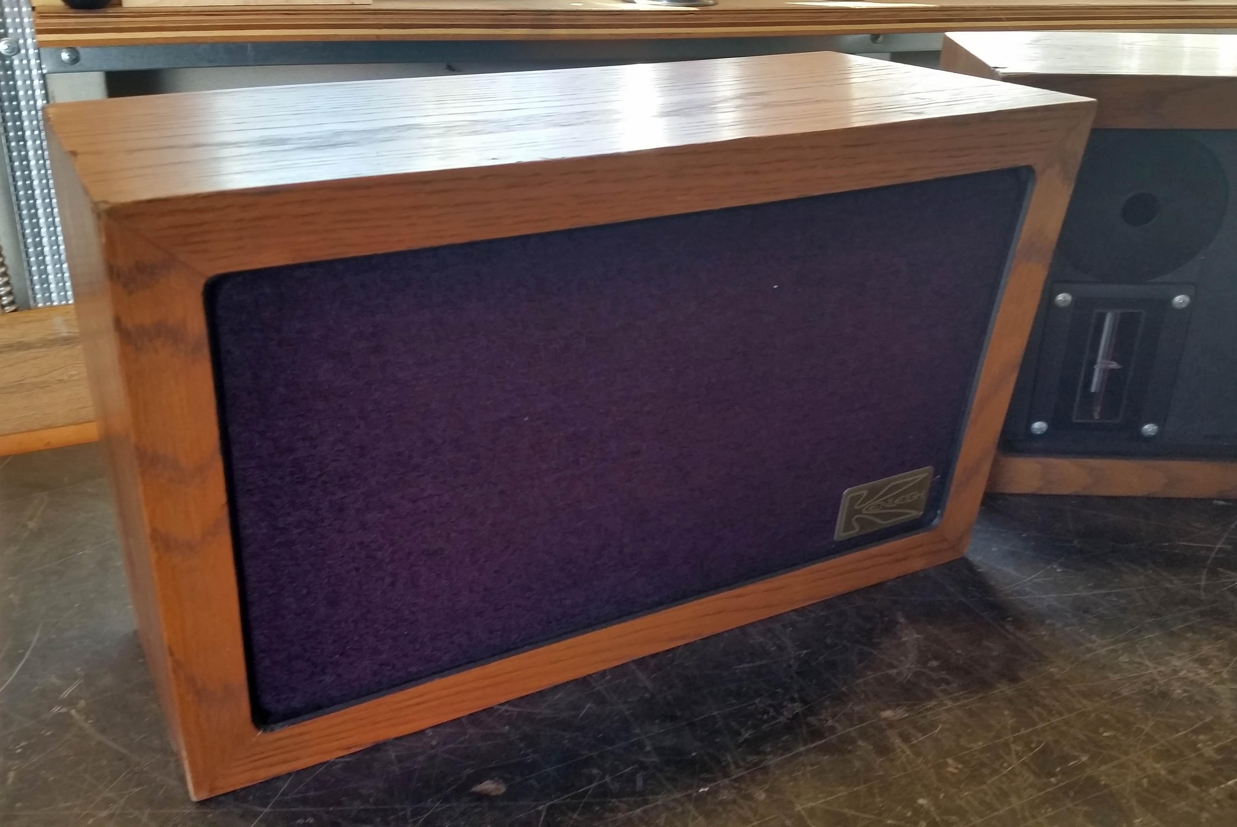

@ turk 182:
Look at the photograph in post #15, where the cabinet is shown orientated horizontally. This results in the major axis of the tweeter being orientated vertically. Maybe this is the way round the speaker is intended to be used.
Perhaps the OP will clarify the matter for us.

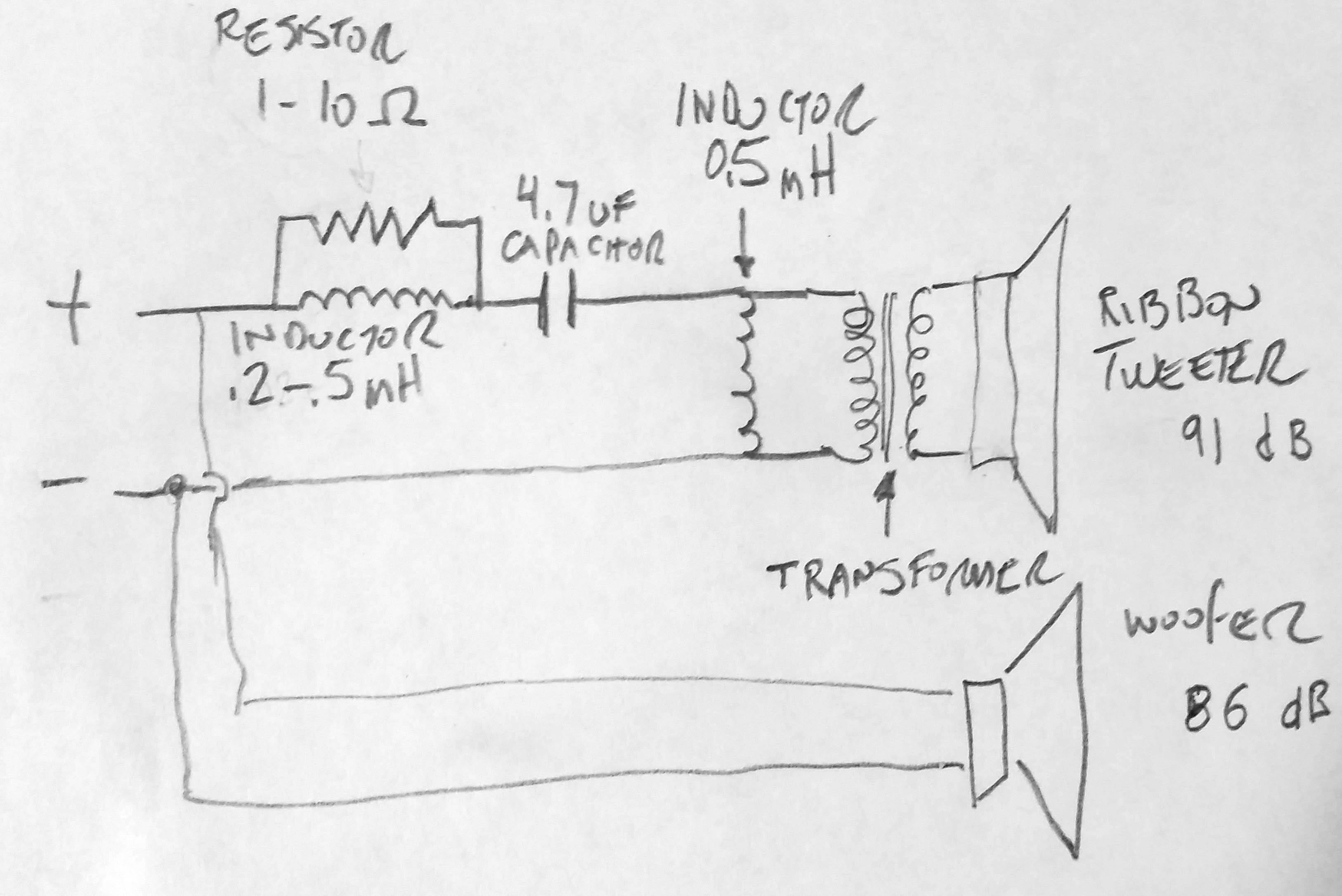

lowmass, see the attached schematic, is this how you described it? Which resistance direction increases midrange, higher or lower resistance? What rating on the resistors, 2 watt okay? Would a 10 ohm rheostat work here?
As regards ribbon orientation, the speakers where designed as monitors to be hung on a wall left and right, horizontally, indeed firing downward. Note the alignment of the badges on the grille cloth. If I were to use them vertically, I'd have to rotate the tweeter 90 degrees.
Continued thanks!
yes that is right. You may not need it BUT it cheap to try and based on the sensitivity of your woofer that tweeter may be too hot up high.
however this wont "increase mids", it will decrease high treble wich may be needed to get a good balance between mids and treble. That tweeter has a rising response out through high treble region. That inductor/resistor combo can flatten that response out without affecting the lower treble. Getting the right balance between mids/low treble and high treble is a very important part of good sound.
larger value resistors will lower high treble
lower value resistors will allow more high treble
use 10 watt resistors
sometimes when I use this circuit I use a rheostat as you mention to decide on what resistor value I need. In the end I change to resistors. Reostats can have issues
