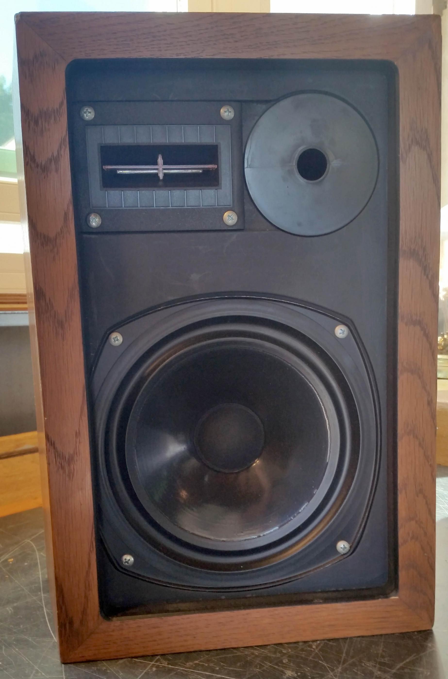

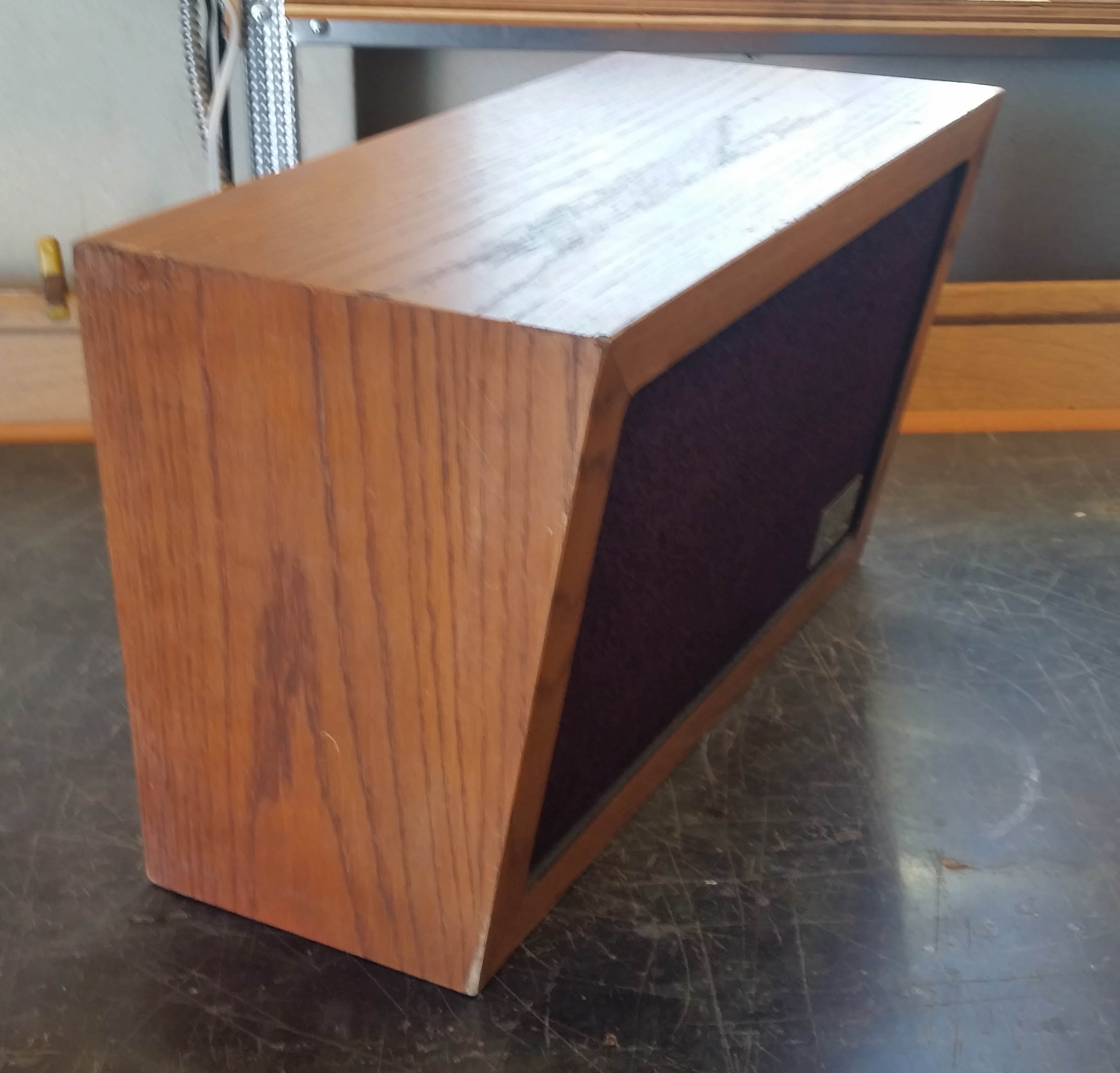

Kenleigh Focused Field Monitors. I bought them thinking they'd have a great midrange and top end based on the ribbon tweeter in a small horn, but there is no real presence, no crisp top end. Even my wife says "muddy"
Dimensions 16 wide by 10 tall, about 8 deep on top tapering to 6 deep on the bottom. Low frequency is an 8 inch French Polydax HD20B25VHV marked 8 ohm and stamped 1184, presumed to be the production date. High frequency is an unmarked ribbon horn measuring 4 1/4 wide by 3 inches tall. Woofer shows 7.2 ohms resistance, tweeter shows .3 ohms resistance. No specs known or found about these drivers.

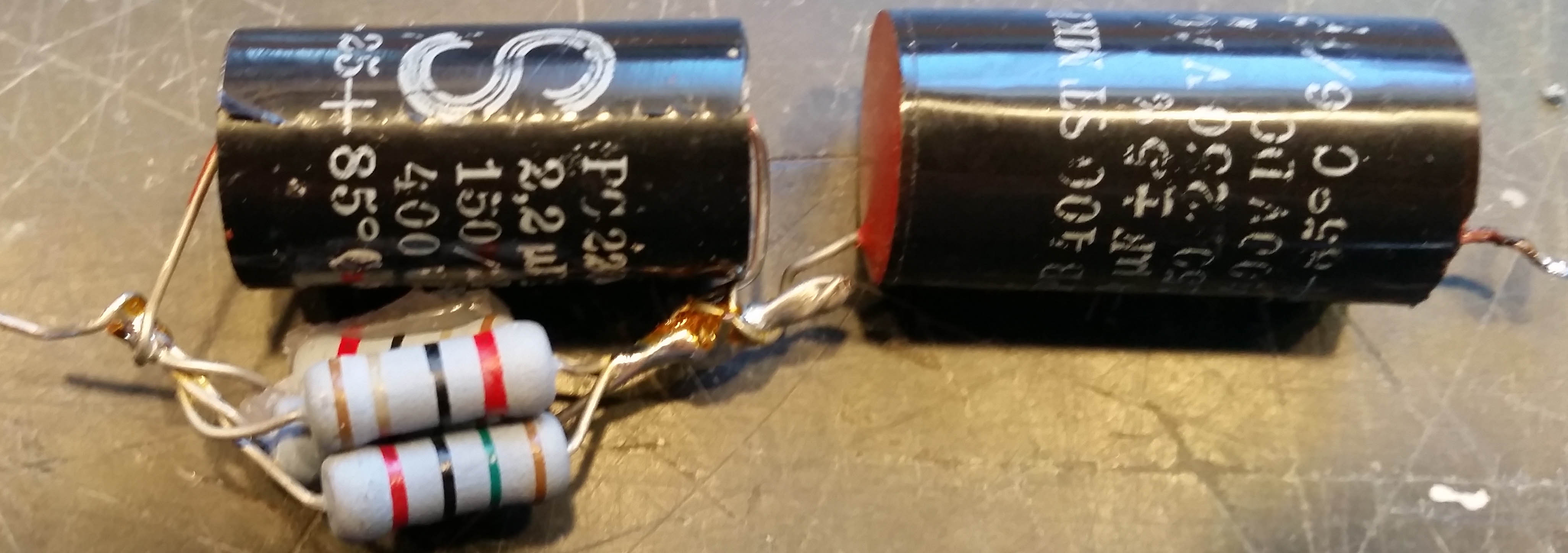

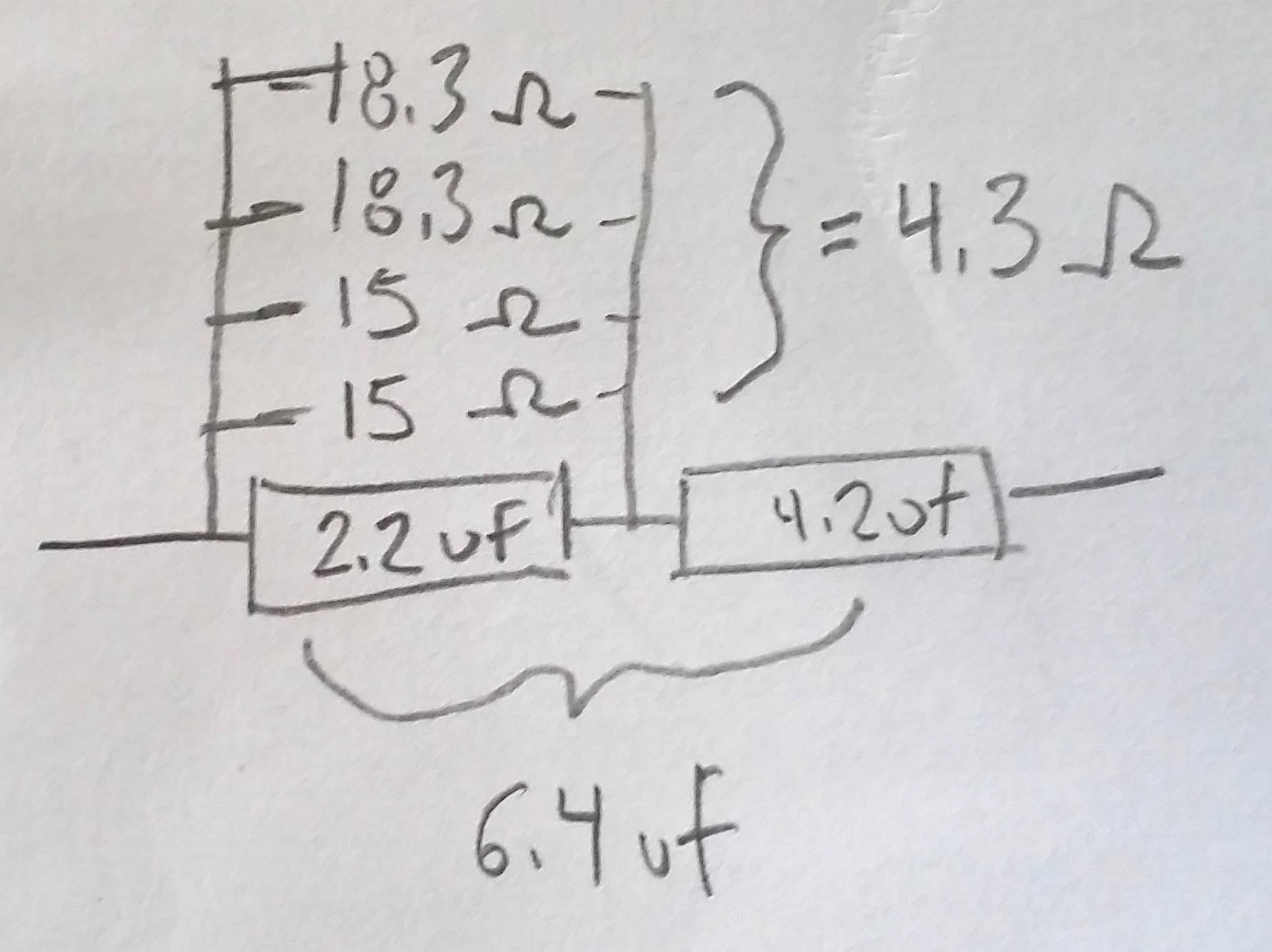

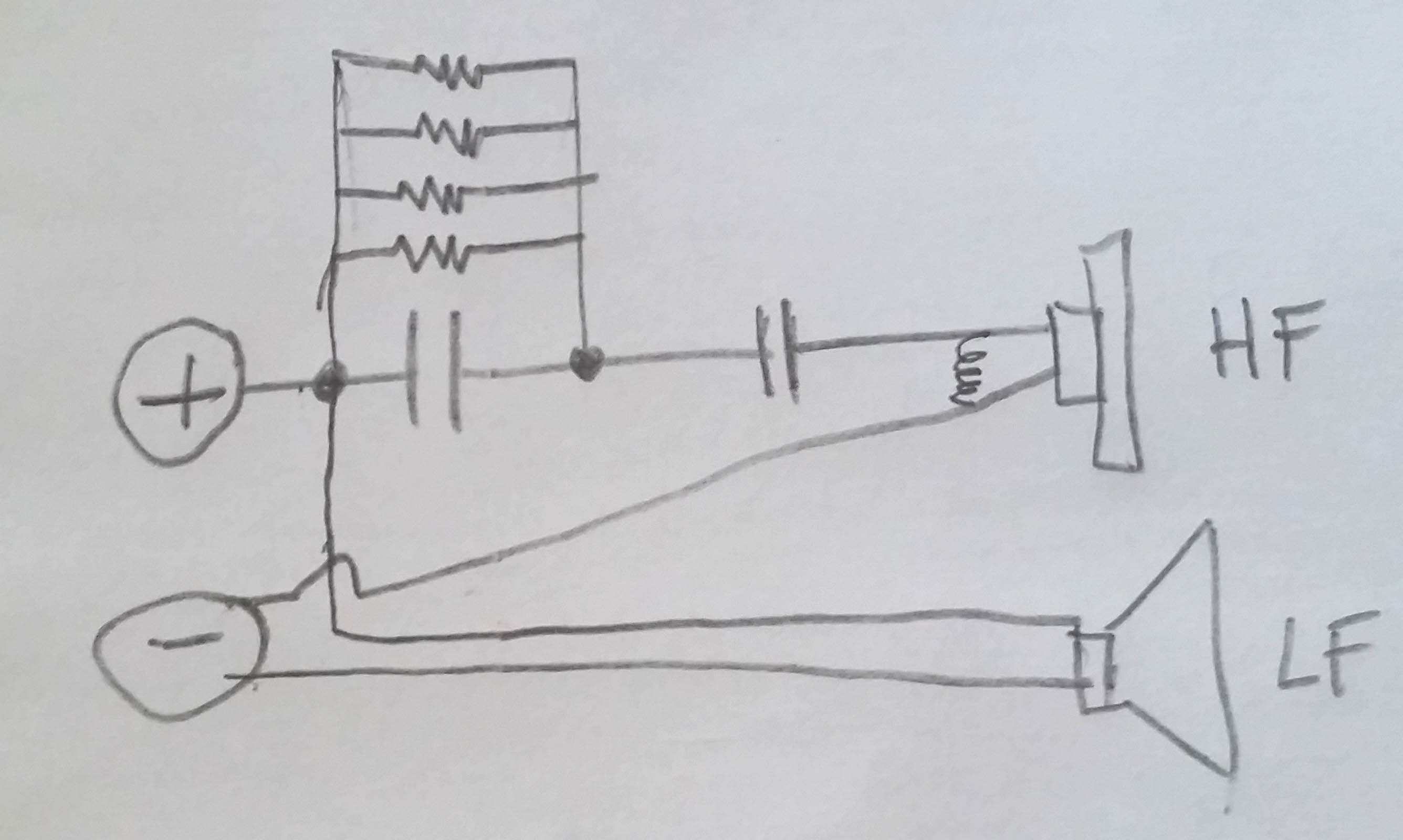

Woofer is direct connected. Path to the tweeter goes through 2 poly caps, the first cap in parallel with 4 resistors. First cap is marked 2.2uf and measures 2.17, second caps is marked 4uf and measures 4.2uf. Two caps in series measures 6.4uf.
The resistors have me stumped, and I have never seem them used this way before if a crossover. Why 4 in parallel and not one single? Are these referred to a shunt resistors to drop impedance?
Resistors are 2 watts. I know how to read resistors: Two resistors are Red Black Green Gold which means 2 meg ohm 5% but they measure 15 ohm. Other 2 resistors are Red Black Orange Gold which means 20K ohm 5% but they measure 18.3 ohms. Calculating resistors in parallel, and reading the color stripes, I should come up with 9.9K. Measuring the resistors in parallel, I get 4.2 ohms.
Question Number One: What am I not understanding about resistors here?
Question Number Two: What do I change to recover top end and get these out of the audio mud? Is there anything special about as ribbon tweeter versus a dome when it come to crossovers? Can I just replace what I have with a 2nd order 12db LR? What frequency do I crossover at?
Thanks!

For the resistors, I think your reading them backwards.
With time the colours can change, so the gold may actually be brown.
This would line up with what your measuring.
So your Red Black Green Gold becomes, brown green black red. 1 5 0 (multi) red (tolerance) = 15 Ohms.
These days I find colour coding not very clear. Primarily due to thin bands with 'washy' colour saturation.
Not helped by the bands now being (mostly) evenly spaced rather than grouped with a clear obvious space to the tolerance band of olden days.
edit.
too me the resistors body being a blueish colour suggests metal film, which also lines up with 2% tolerance.
Maybe I am an idiot? Maybe not, but what a doofus! I have read carbon resistors for ages and always saw gold as the last band for 5%. If I reverse them, you are right Brown Green Red Black = 15 ohms (measured 15) and the others must be Brown Grey Black Red = 18 ohms (measured 18.3). Thanks for pointing that out...
But why four in parallel instead of one?

No your not a doofus.
Just caught out by the lack of companies not sticking with the standards recommendations.
If it wasn't for DMM's these days I'd be up the proverbial re color coding on resistors.
Even with 'work bench' glasses and magnifying lamps and good lighting, it's still close to a guessing game these days.
Four instead of one will be to increase power handling.
And I do know of some that think multiple smaller metal films are better than a single 10w.
I won't go into that rabbit hole 😀
You said your ribbon measures as 0.3 ohm.
So unless you want to kill any amplifier connected to it you will have to include a series resistor (4+ ohms) irrespective of whatever crossover you use.
Why has it lost it's output ?
I'm betting the actual ribbons (foil element) are gone.
All you've measured is the transformer on it.
That won't tell you what the actual ribbon element is like.
If you can measure the resistance of the ribbon itself, it should be around 1 to 3 ohm. If it reads open circuit then, unfortunately, there is a break in the ribbon.
Sometimes, it is possible to bridge the break with conductive paint - search the interweb for how you might do this.

I'm not clear what is going on here:
703331d1536874608-ribbon-crossovers-help-20180909_162314-jpg

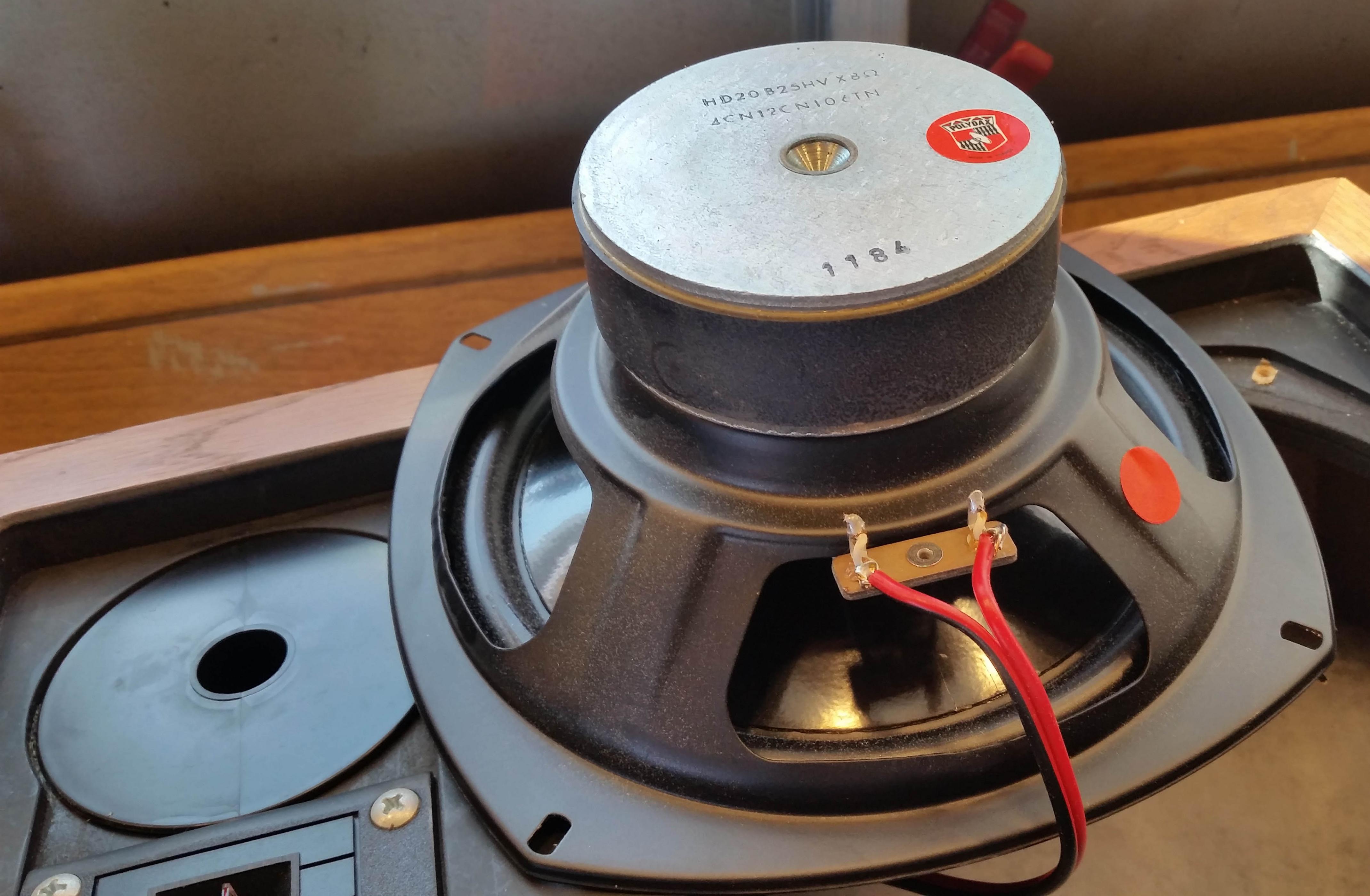

What is this? A small 5" bass speaker? Is that bass paper or plastic?
This is rudimentary to the max, bass running without crossover, guess just a glorified 4.2uF to the tweeter:

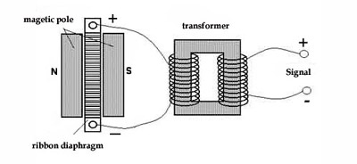

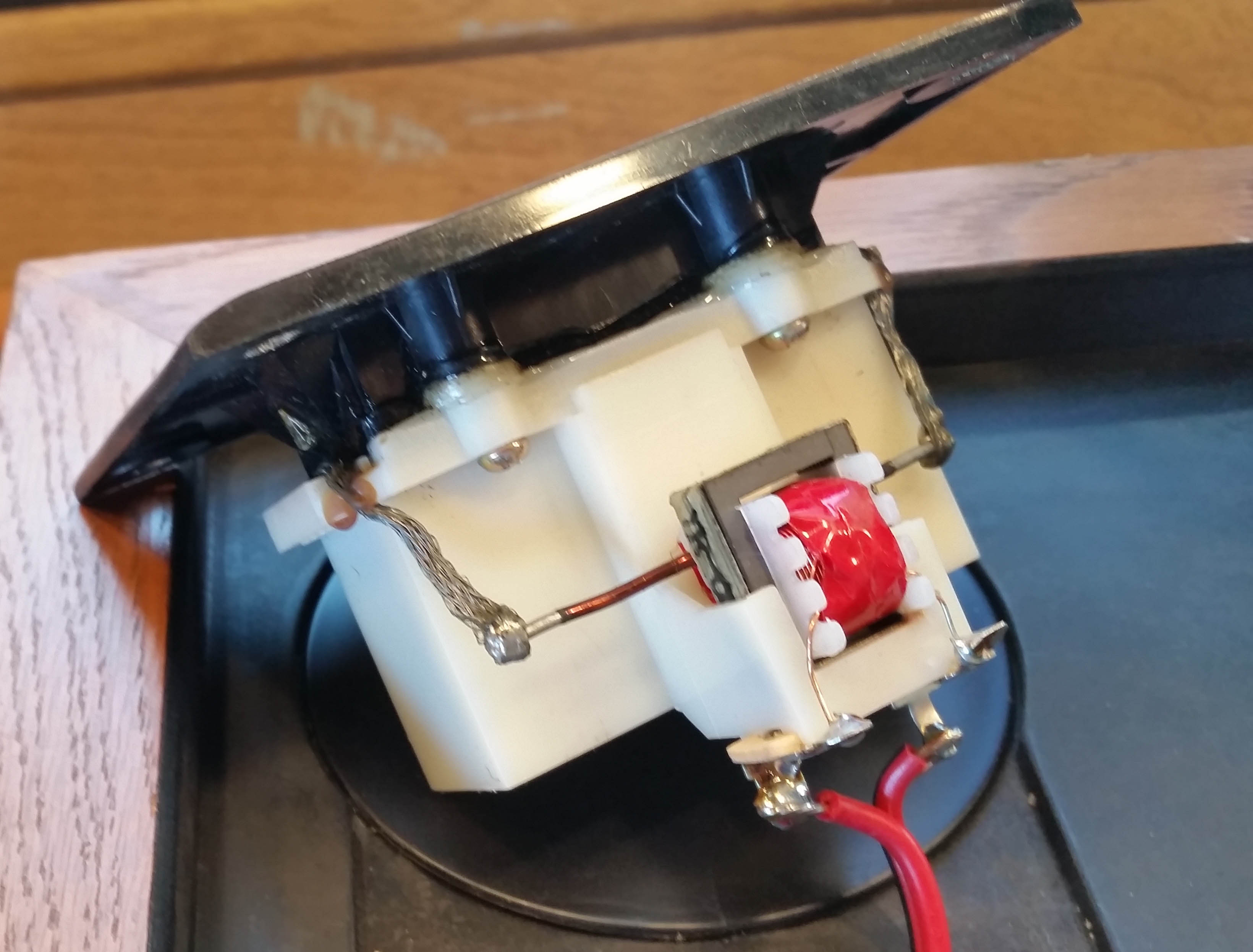

This ribbon or magnetodynamic tweeter has an input transformer:

What is that round plate? Some sort of small port? There's probably the makings of a goodish small speaker there. Maybe replace the ribbon, maybe build a decent crossover. All been done before. Right now you are just poking around aimlessly.
Series capacitors don't sum that way - something's off with your measurements there.

Next, I will desolder the inductor in parallel with the ribbon and test the ribbon itself. (Is the inductor a "shunt coil" for impedance, not that I truly understand that...)
As has been pointed out by Steve and Old'n'Cranky, that 'inductor' is a transformer. The crossover connects to one side of the transformer and the ribbon connects to the other side of the transformer.

That "ribbon" is really not a ribbon. That tweeter used to be sold by Radio Shack years ago. It is actually a rigid embossed foil strip, sort of like a ribbon, BUT the strip of stiff foil is suspended all around the foil strip by a soft rubbery film material.
I have disected that ribbon , and I have some in use experience with it.
first- its not much good below about 4 k hz so I suspect the crossover may be in this area.
2nd- the 4-6 khz area is an area critical to that "presents" and "crisp" sound your looking for. So if crossed over in this area, the frequency response may have not been handled well here and there may be a large dip in response through the "presents" region.
3rd- The low resistance you are measuring on the ribbon is the DC resistance of the ribbons transformer primary winding. The actual tweeter impedance will be around 8 ohms. so its fine.
4th- This is a very RUGGED "ribbon". I wouldnt worry about burning this one up. The foil is thick and the structure is not a loose fragile foil but a rigidly suspended stiff thick foil strip.

Lastly I would take that 2.2 uf cap And all the resistors in parallel with it and remove them. Just run the 4.2 uf cap. Then listen at lower volumes and see if the sound is more acceptable. That resistor /cap section may be pulling the low end sensitivity down enough to darken the 4 Khz region.

The woofer is a French Polydax HD20B25VHV. HD series, 20 cm (8 inches), Bextrene cone, 25 mm voice coil diameter, 96 mm magnet, minimum impedance 8 ohm at 150 hz, resonant frequency 26 hz, 86 dB SPL. Normal handling power 30 watts

You are absolutely correct, the caps sum to 1.4 per the formula, about 1.3 measured.

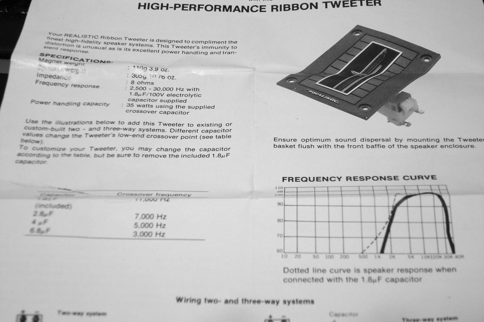

Note Radios Shack shipped this with a 1.8uf cap.

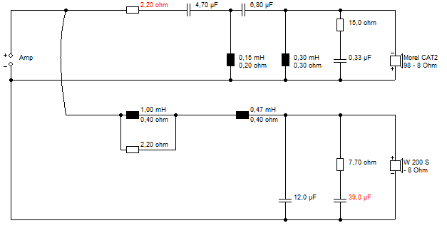

Second is a Rogers LS5/9 style which uses heavy impedance correction and lets the bass see a very low source impedance:
702389d1536483019-akai-sr-sa6-sont-e44-morel-cat298-jpg
703137d1536790734-kef-104ab-rebuild-minidsp-dayton-drivers-system7-speaker-circuit-png
703136d1536790734-kef-104ab-rebuild-minidsp-dayton-drivers-system7-speaker-fr-png
This design is outstanding. I haven't quite decided if I prefer third or fourth order on the tweeter yet. But it's world class sound for a two way. The 39uF and 7.5R is called a Zobel impedance correction, here for a driver around 60 ohms at 10kHz. Your driver might require nearer 15uF and 7.5R. The 89dB tweeter needs to be flat and around 5 ohms DC. But level is adjustable.

Can we get more detail on this item? I can't read it properly.
703574d1536950138-ribbon-crossovers-help-rstweeter-jpg
It is usually possible to splice a known tweeter response onto a known woofer response with satisfactory results. Just how it works.

Tweeter spec sheet photo found on the web, I have not been able to find a better copy of it.

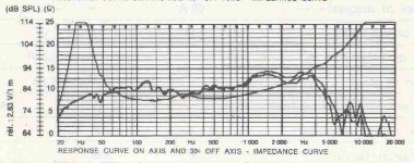

Graph of HD20B25H (from a catalog .pdf) shown below.
Initial tests with just a single 4.2 uF capacitor (about 4,700 Hz) vastly improve the top end on the speaker.
