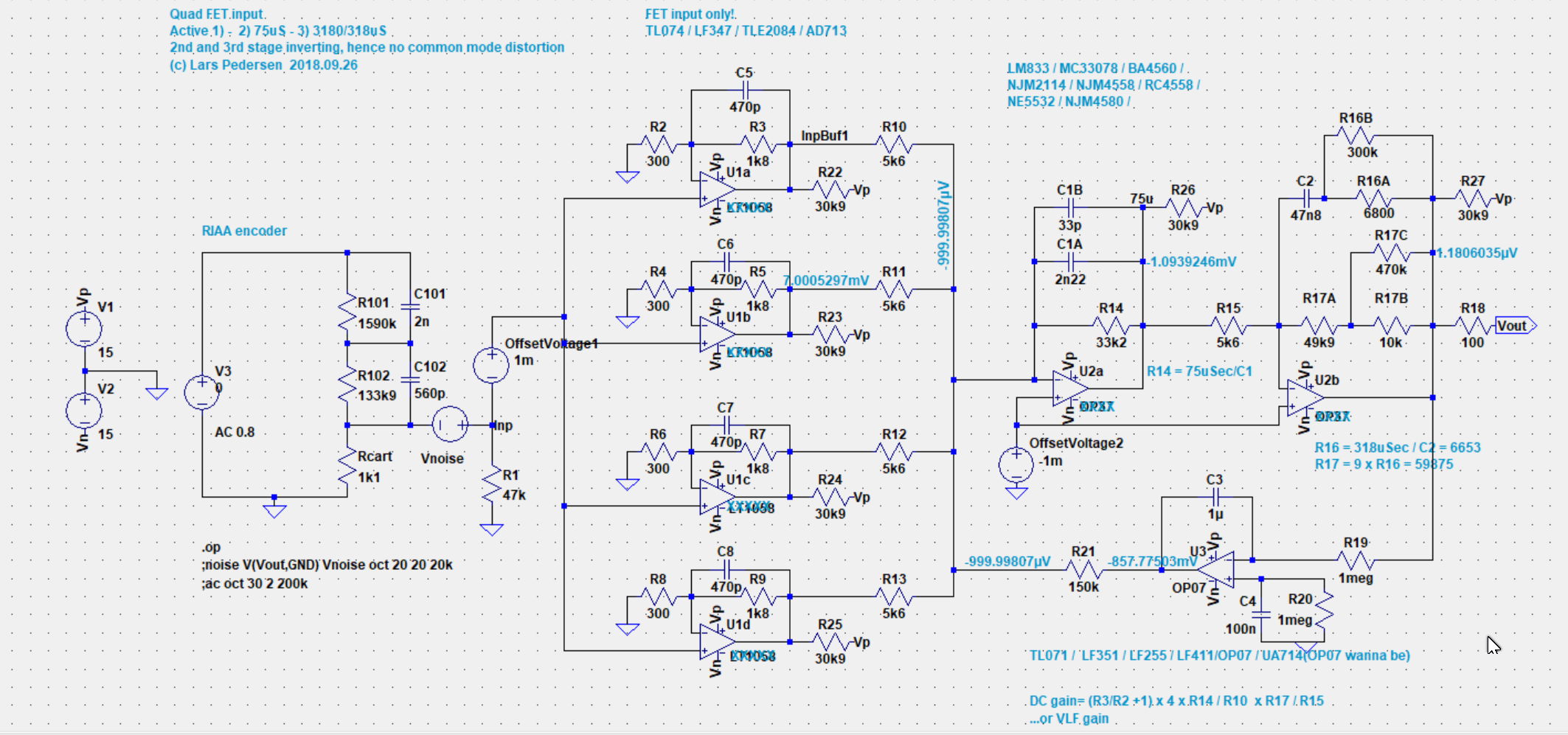

The circuit:

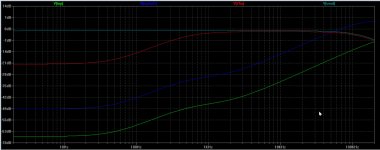

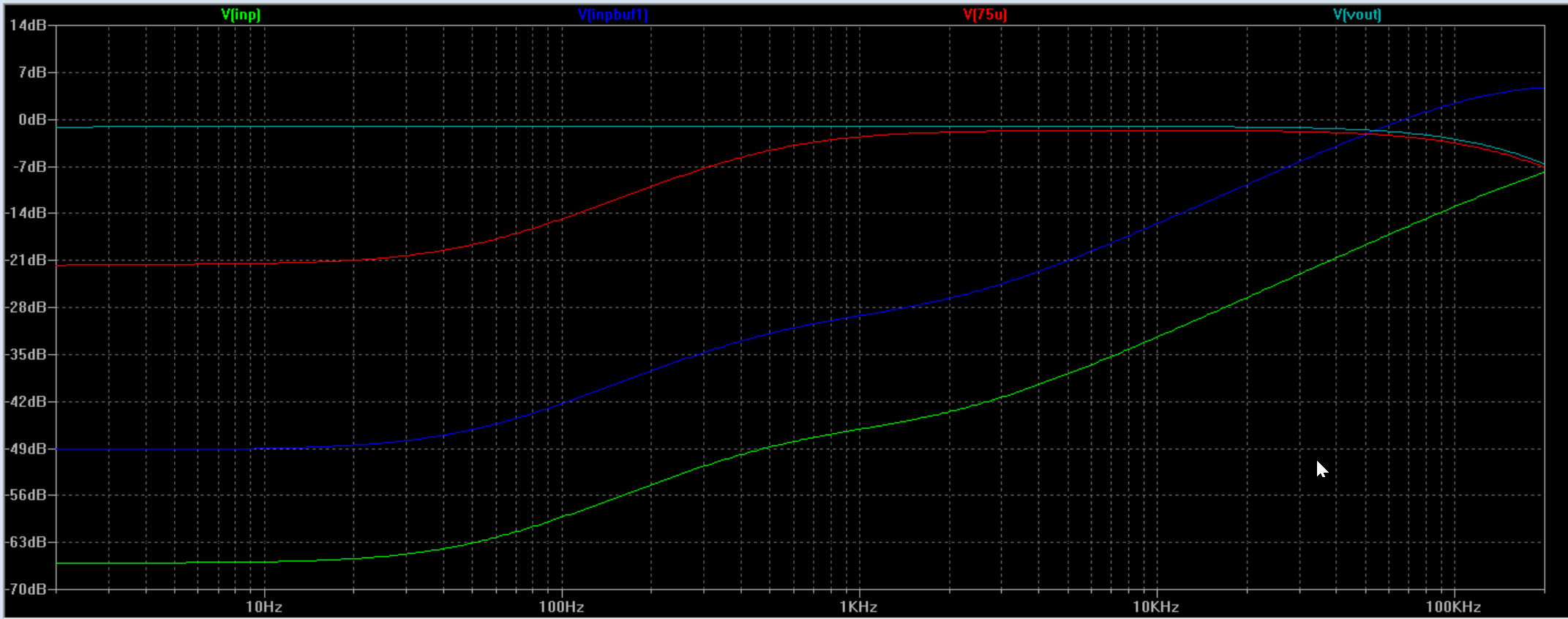

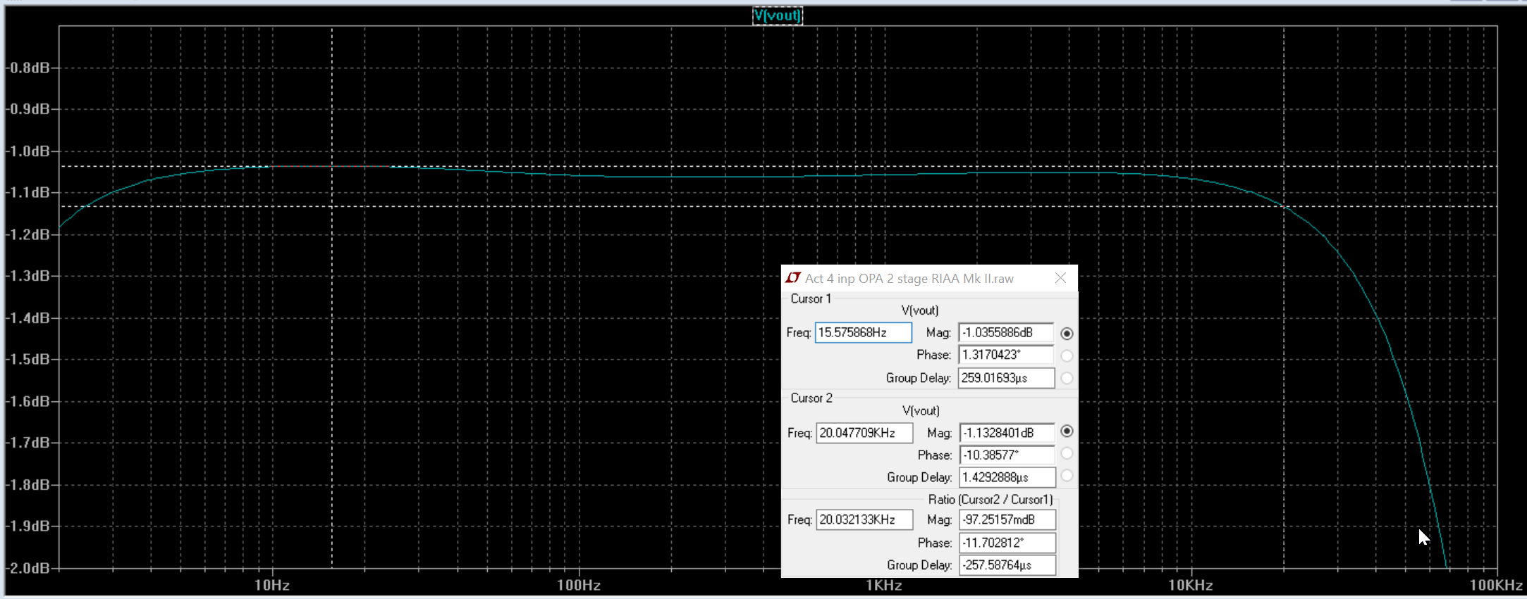

Looking at the schematic, the design starts off with a TL074 with all 4 amps
working in parallel to reduce the input noise with 6dB.
The second stage is inverting and implements the 75uSec time-constant.
The third stage is also inverting and implements the 318uSec and 3180uSec time-constants.
Below these is the servo amplifier that maintains the output at zero volt
(I used an UA714 which is an OP07 wanna-be).
The resistors R22 to R27 bias the outputs of the OP-Amps into class A. I probably should have used smaller resistors to get a larger bias current.
I have not used any fancy components, except 1% metalfilm resistors.
The capacitors are standard MKT or similar, which I have measured and matched across the two channels.
