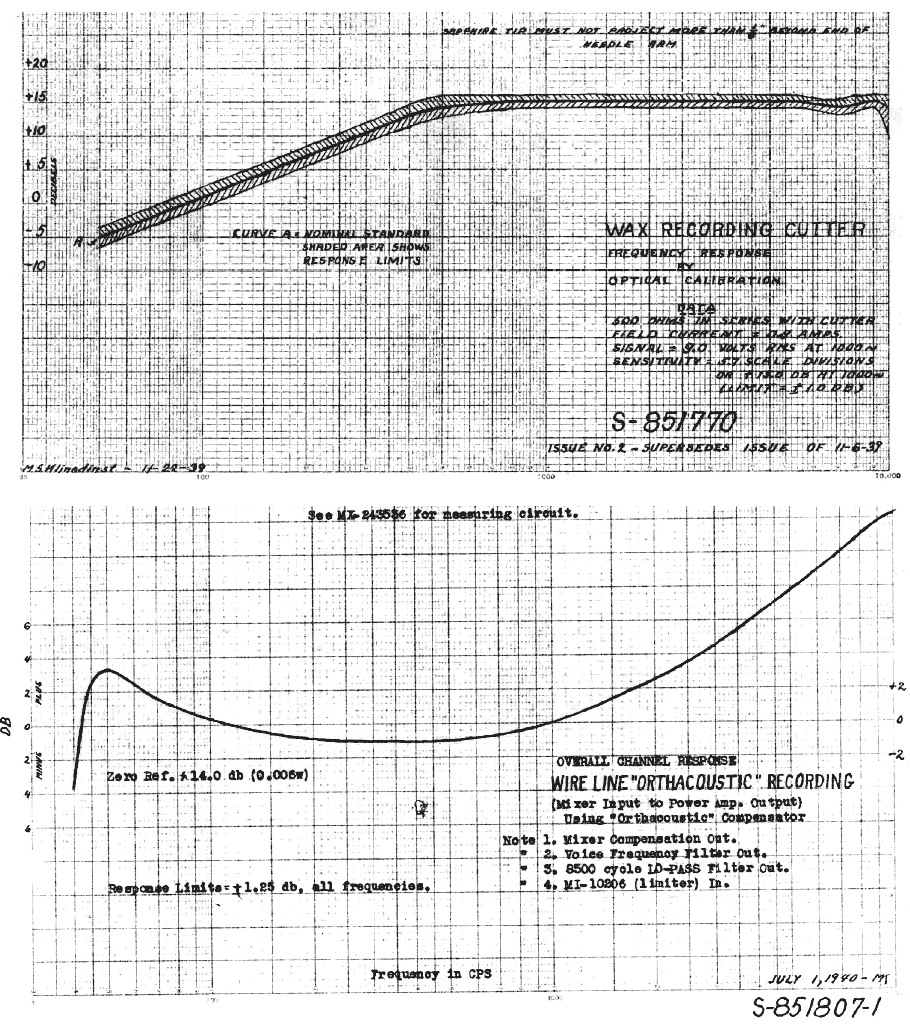

Originally Posted by davidsrsb> ....RIAA accuracy of common record lathes? I would not be shocked to see fairly gross errors.
RCA's in-house notebooks from 1940 have come to light.
Index of /schematics/RCA/RecEng/ 45 MB PDF
Recorders were tested (optical wax patterns) weekly, and monthly, and rotated back to Camden for checking every 6 months or on suspicion.
The cutter had an intrinsic bass-rise due to stiffness, which is very reliable and smooth. This is the origin of our 500Hz corner (not yet standardized). Then it runs flat to >6kHz, with minor damped resonance above.
The cutting amplifier supplied the ~~2kHz corner. This plot includes much of the system with multiple low-poles. In most complete setups the 50Hz bump would be milder.
