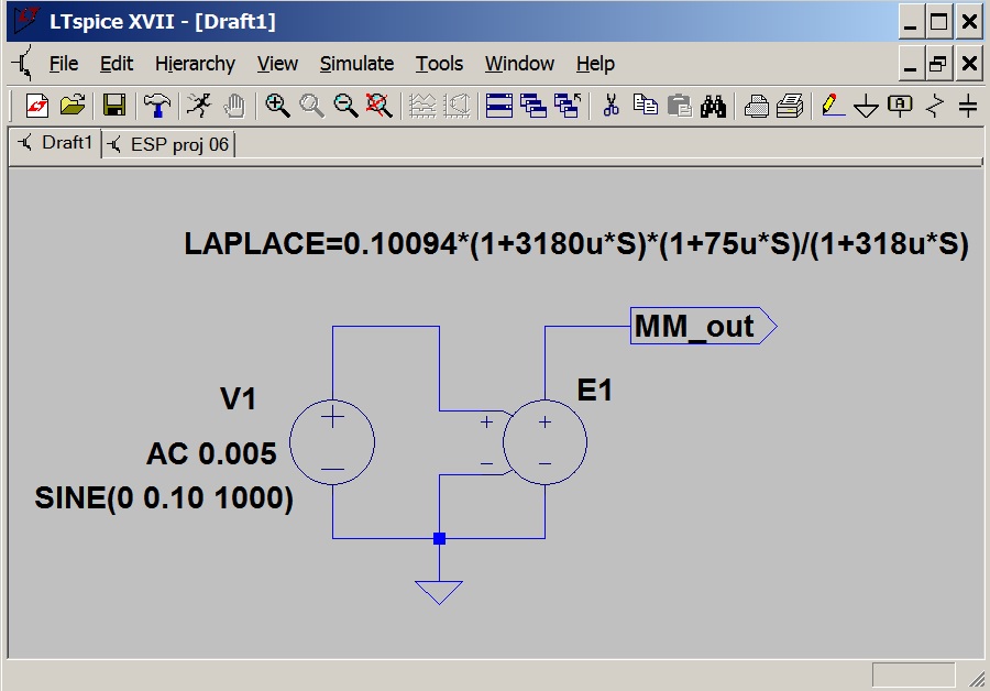

If you're using LT Spice you can use the 'e' component (voltage dependent voltage source) with a Laplace function in the value parameter as in the image below.
So, by using this source, I should expect a flat responce over the audible band? And, is this the same as playing the 7th and n8th track of this record?
