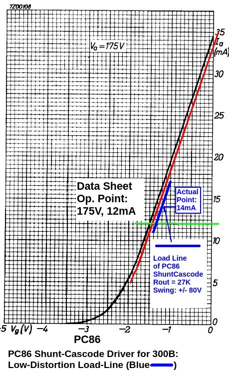

There are some obvious clues in the data-sheets of the tuner triodes, particularly the PC86 - but if you go beyond them and do your own characterisation you'll really appreciate what is possible.
to illustrate what I mean, see the attached characterisation of the PC86 (measurement of which gives the same results).
The resulting stage gives performance (low distortion, high gain, lack of EMI susceptibility, due to input & output both referred to ground) - O, and splendid sound quality.

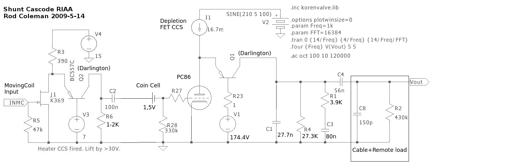

To illustrate the possibilities of a Shunt Cascode design, consider the RIAA design below.
It is designed for compatibility with Moving Coil cartridges, and in particular the Denon DL103, since no DIY design should fail to offer compatibility with this outstanding bargain - especially where your LP collection was acquired across the decades and includes samples from 1950s to 1990s pressings.
Trying to achieve MC input will either require a transformer (expensive if justice is to be done to the DL103), or you must use a JFET.
My design shows an MC RIAA that achieves 88dB (x25K) for two stages (before EQ), with low noise and ultra-low susceptibility to radiated fields.
It also has a supply current that is constant over average and instantaneous samples (allowing easy filtering) and the CCS in the valve stage allows superb rejection anyway.
See also how the active electronics do not spoil the EQ constants, because the EQ is current-fed, rather than fed by a highly imperfect voltage source, if we use a regular common-cathode stage.
Of course, shunt cascode have downsides: complexity, and need for suppression ferrites (gain is so high). But both of these are solved with a PCB, and that's what I use..... the sound is superb, using an unloved and cheap triode.

Rod, shouldn't the coin cell be drawn on the right side of R28 for biassing the triode?
You probably found it to behave linear at sub 1V level... how about addition of noise?
hi Jaap, Yes, you are right, there's a drawing error on R28 position.
The PC86 is explicitly designed for operation at -1,5V bias at Va=175V, so there's no problems, especially for phono stage use.
Coin cell noise is low in this position, largely because the load current is in the microamp region. Maybe a bypass resistance will also be needed in some cases, if any real levels of grid current exist.
But if you can't find a low enough noise cell, or want to bias to some less convenient voltage, you can use a small-value unbypassed cathode resistor. Gm and gain degrades a little, but you have so much available already, that the phono amp will still be a success.
Some cascodes are noisier than others, so some might be worse than pentodes (though this is probably rare). All cascodes involving tubes are noisier than a cascade using the same components. Since their linearity is worse too, I can see no justification for using a cascode in a phono stage.
Producing a Cascode phono amp with worse linearity than cascaded stages simply indicates poor design work.

You still fail to understand the ability of particular triodes to operate with vertical load lines - achieving higher gain, and lower distortion than otherwise possible.
You still fail to understand that for a triode, linearity is worse into a vertical load line than into a higher impedance load. This ought to be common knowledge...
Just look at the PC86 curve, and show me where the non-linearity is.
As you can see, linearity improves with load impedance. As it always does for a triode. (I'm not saying the distortion would be really bad, especially above 10mA; you have chosen an unusually good triode to bolster your claims, but it will be better still into a higher load.)

It uses a tuner-class triode in the amplifying position because the open-loop distortion is substantially lower than for any other device, (whether thermionic or solid state) - taking account of the signal amplitude.
One can see the potential linearity from the curve I posted along with the circuit.

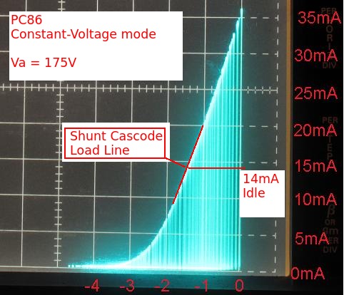

And finally, we do not need to rely on antique data sheet curves to see the linearity of a vertical load-line for the PC86. We shall need to measure, using the actual operating parameters of our design.
Forum colleague Adalin in Gotenburg traced out this curve of a real PC86 at 175V.
As you can much more easily see, an operating point of 14mA gives splendid linearity, even for +/- 6mA or more of swing! This means we can swing to the supply rails within the linear region using my 27K load, or even further if a negative supply is added.
If you believe your preferred common-cathode circuit can do better, please draw it out, characterise it, and we can review and apply the same degree of criticism.

Well, I have presented the evidence for the low distortion and high gain of my circuit, and I dispute that it will be surpassed by any old "gain stage". You do not even specify the type of stage - and certainly provide no evidence for its low distortion.

I just don't see the point of plonking a triode into an ostensibly solid-state circuit. If you really want lowest distortion, an opamp would have done the job better surely?
It's not a "solid state circuit". I don't restrict myself to using one category of device for some arbitrary reason. In every position, I use the device that meets the needs of the design better than any other device. JFETs, MOSFETs, BJTs and triodes all have a place is my system design. In this case, a triode is best - and also gives the best overall sound (the purpose for which the amplifier is actually being designed).
Artificially painting yourself into a corner with device-choice restrictions merely leads to compromised designs.

Yet it will never be as linear as Va vs Vgk; the cascode always loses the linearity and noise battle; it's a fact of life. That said, if you're going to use a cascode, the folded cascode with BJT upper device is the one to go for.
I am glad that you are beginning to see the advantages of my shunt cascode circuit!
Now, I have presented evidence for the high linearity, and we seem to agree that the noise level is not an impediment in this case. The shunt cascode is certainly ahead on the linearity - gain battle, especially in terms of spectrum, which is more important in this practical amplifier solution.
I don't follow this. You have four devices. Exactly the same number of devices could in principle be used in some cascaded arrangement to acheive the same overall gain.
For a start, you are conceding that your gain-stage needs a follower - which makes two devices per stage - or three/four devices to reach the same gain as two in shunt cascode.
More importantly, you are interpreting "Stages" and "Devices" interchangeably, which is leading you astray.
A stage should have a definable input and output signal voltages (or currents), presented at input and output ports.
The shunt-cascode is more like a single-stage compound of devices.
It has only one single input signal-voltage, and one single output signal-voltage. There is only one single signal current running along the whole compound stage. I am neglecting the residual signal voltage on the anode (desirably zero) because it is so small.
Clearly I'm comparing apples to apples, so I mean the PC86 working into a load line that is anything but vertical.

I saw the Ia/Vgs graph, but judging a curve by eye doesn't count for much. I'd rather see a THD measurment.
I remain unconvinced.

I would very much like to see some noise measurements of this thing. The Denon cartridge puts out a nominal 300uV yes? And the EIN of a good JFET might be 0.3uV ish, implying you'll get no better than 60dB SNR. To me that doesn't sound good enough for MC use. What am I missing?
300nV? You are off by 20dB, if not more.
The JFET is the K369, as labelled on the schematic. Part of the family of large-geometry JFETs that have been around since the 1970s.
Hard to know how you have missed these, if you are really in audio in any way. What have you designed your MC amplifier with?
The K369 shunt cascode can also be confirmed to be perfectly quiet in practice, in a real system. And even if it were not, if you have some even lower output MC, you can parallel two, three and so on, without any undue complexity. The addition of active area is simply the principle by which the low noise FETs were designed.
