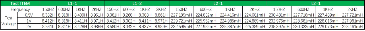

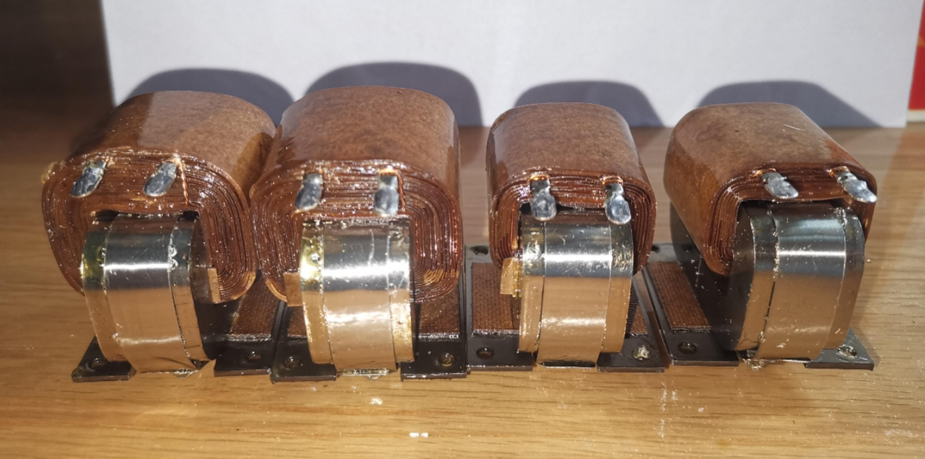

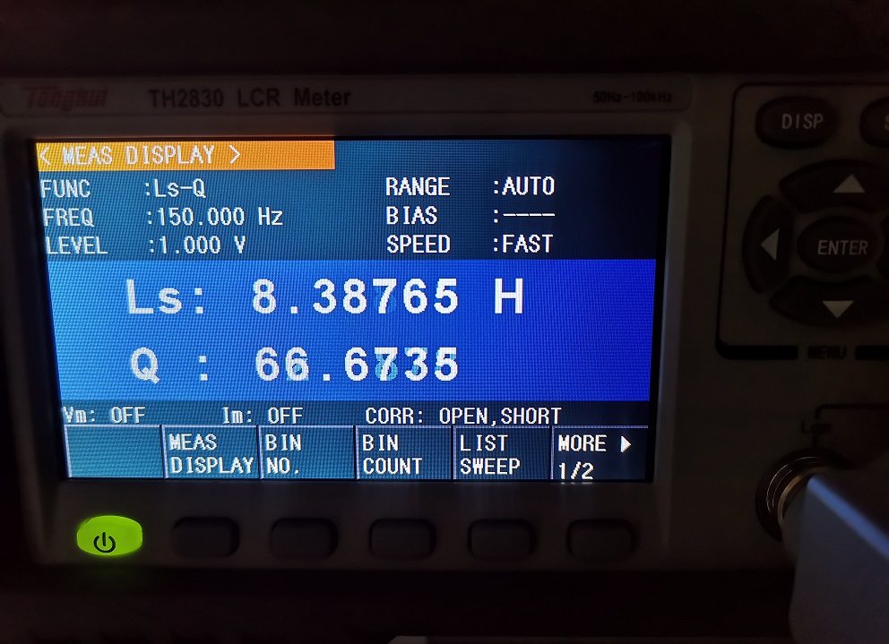

Have one question here.if we build the L,what is the test spec,which means for the 1.8H/45mH inductors,how to musure measure if we use the LCR meter.How to set the musure frequency and voltage,100Hz/1V for the 1.8H or 1Khz/1v for 45mH.
I ask this question due to I musured my ordered inductors,if I set different test frequency and voltage,the test result is different.

Hello. Even 45mH inductors have enough turns and layers that they have some parasitic capacitance. This creates a resonance at relatively low frequency. This resonance spreads down enough (the Q is not super high) so when you measure at 1kHz you have the capacitive part starting to effect the measurements. Therefore the inductance looks lower b/c the meter does not compensate for the impedance due to the capacitance. Your 100Hz measurement is more correct.
The 1.8H inductor will really show a difference when measuring at 100Hz vs 1kHz.
Btw the capacitive part, and thus resonance, is completely swamped by the driving tube (or transistor) and load, so in practice it is of no real worry. (Assuming you don't have crazy high impedances driving and loading).

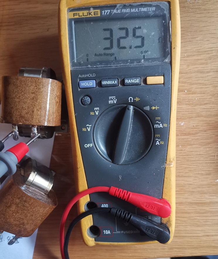

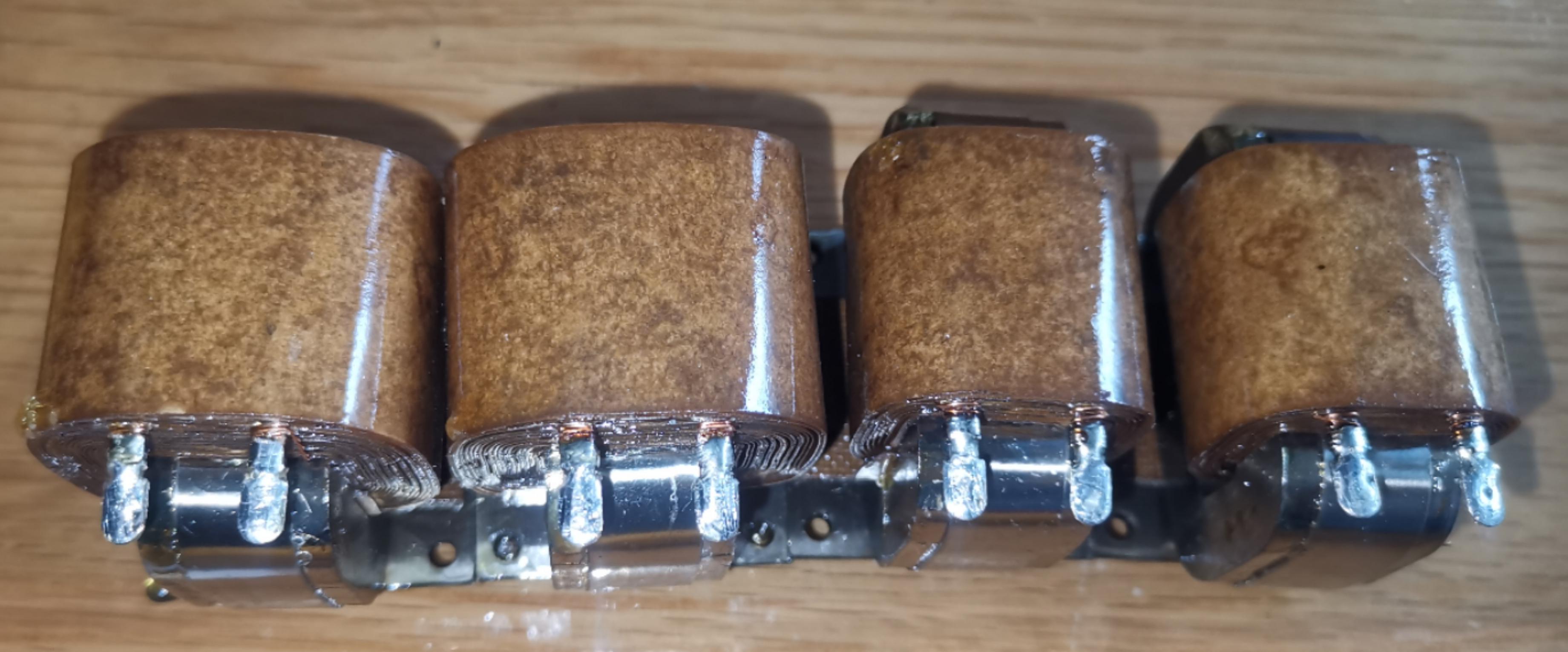

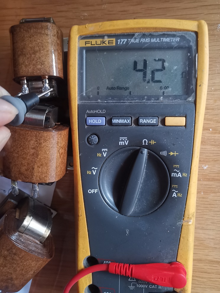

I plan to use the a litter bit high impedance.I summarize the the different test frequency and test voltages.Details please refer to the attached photos.
