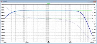

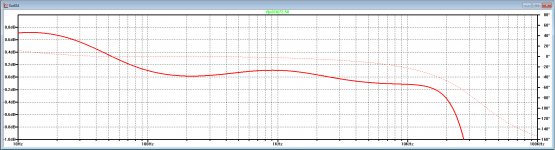

Just for completeness to see the difference:
Now without the 200nF input cap and with the original 110pF and 330pF caps instead of 105pF and 320pF in posting #17, frequency response with the same 300mH / 600Ohm virtual cartridge and 60pF cable capacity, looks like:
Hans

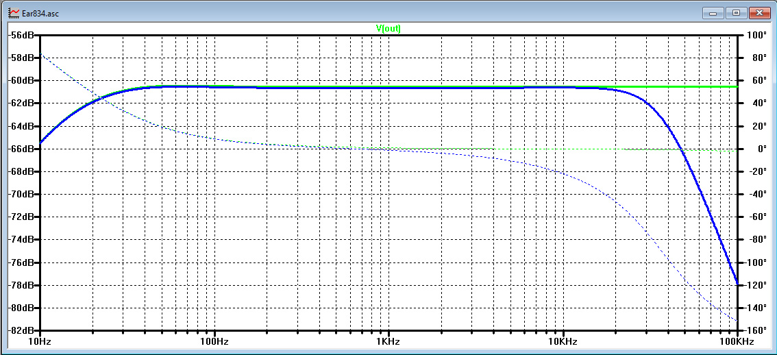

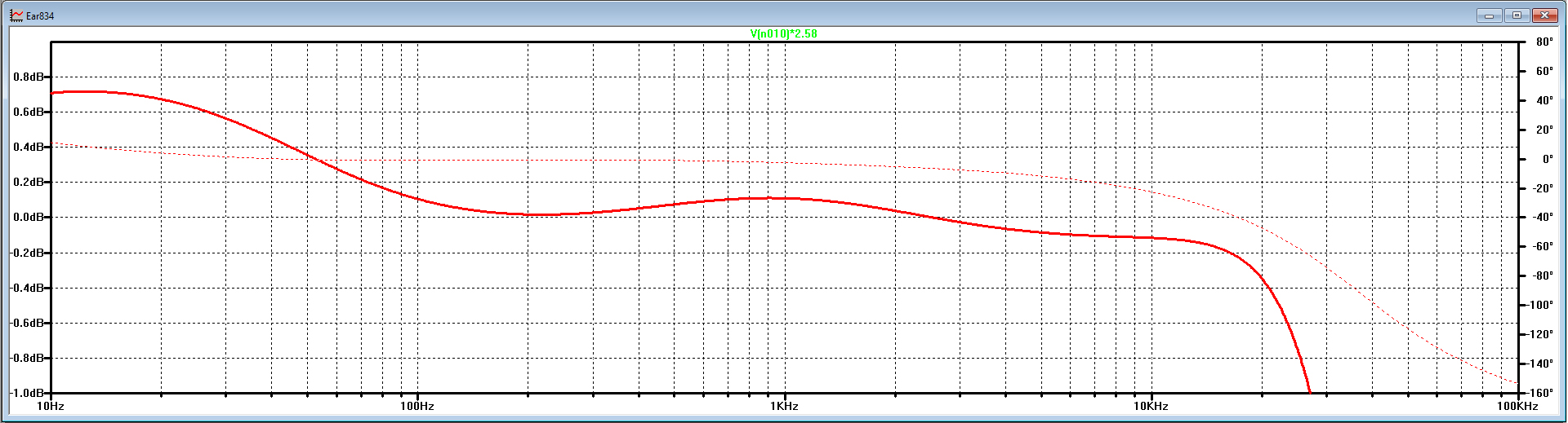

Hi Albert,
Don't worry too much.
The difference between the (300mH + 600 Ohm) Cart in Blue and a straight wire in Green simulating a low output impedance prepre is neglectable in the audio band, see image below.
However using MM carts with different induction values can make a difference from 10Khz and higher.
Hans
