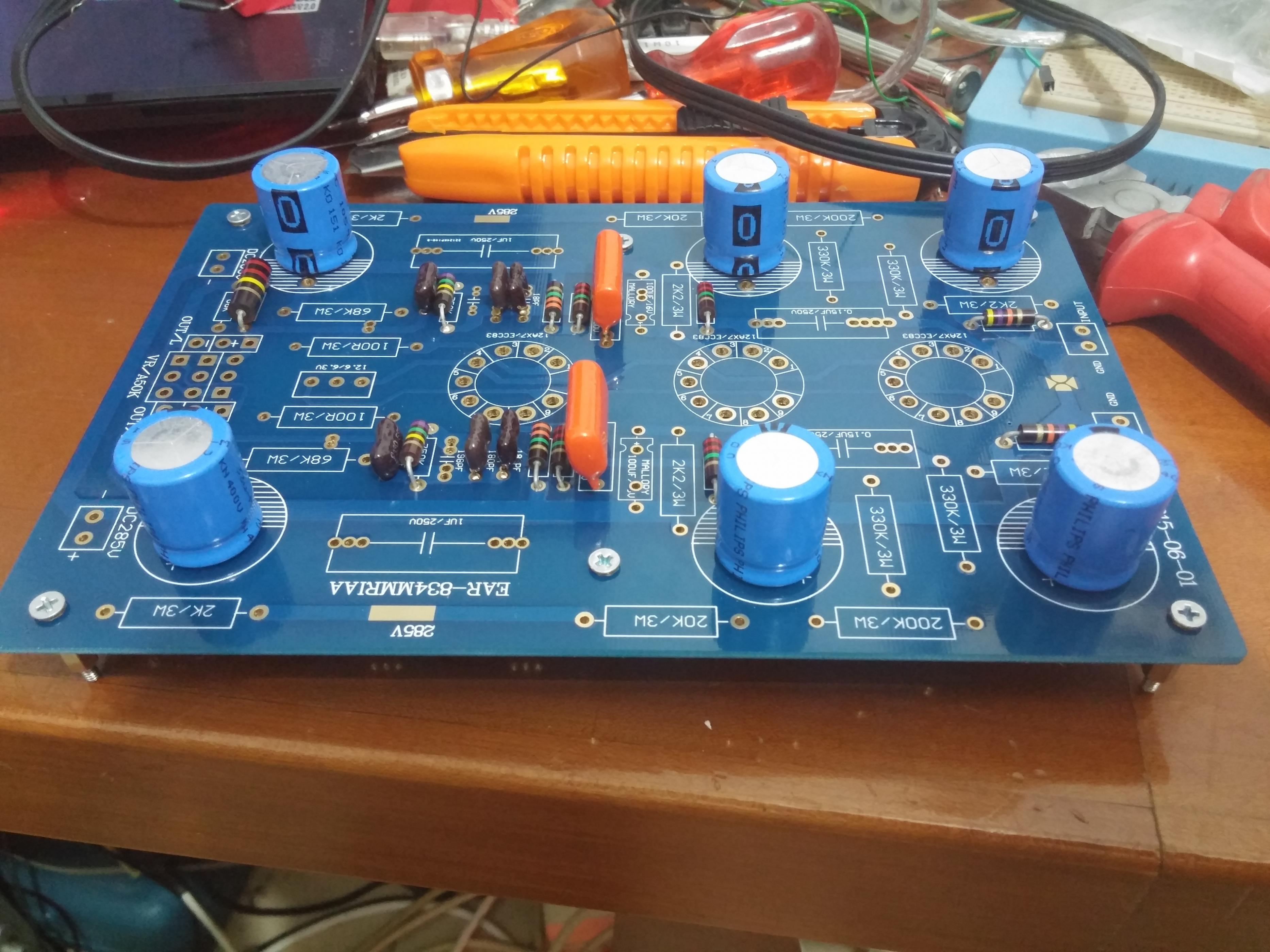

my new project is to build the EAR834 phono stage.
i order Quality components for the riaa but the values are Inaccurate, how it is Affect on the FR?
my valuse are 130p (110p-Theory)
850k(750k-Theory)
335p(330p-Theory)
thanks

Need to get closer on the 750K resistor, I would use a couple of resistors in series to get as close as reasonably possible. The 130pF is a bit high too, try to get a bit closer. 335pF is OK. Matching between the channels is very important, but so is some level of conformance with the RIAA curve, the errors occur over the entire frequency range and may not be subtle if you are several dB down at 20Hz or 20kHz, or the turn over points are in the wrong spots.

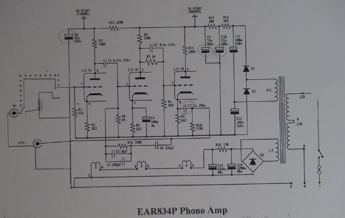

The designers omitted the resistor in parallel with C4,Let's call it R15
http://www.diyaudio.com/forums/blogs/hbc/1077-heretical-834p-mods.html
R12 * (C2||C3) should equal 75uS (T5)
R15* C4 should equal 3180uS (T3)
R12/R15 ~= 11.8 or 8.8Meg
The approximate value of C4 should be ~360p

The designers omitted the resistor in parallel with C4, Let's call it R15

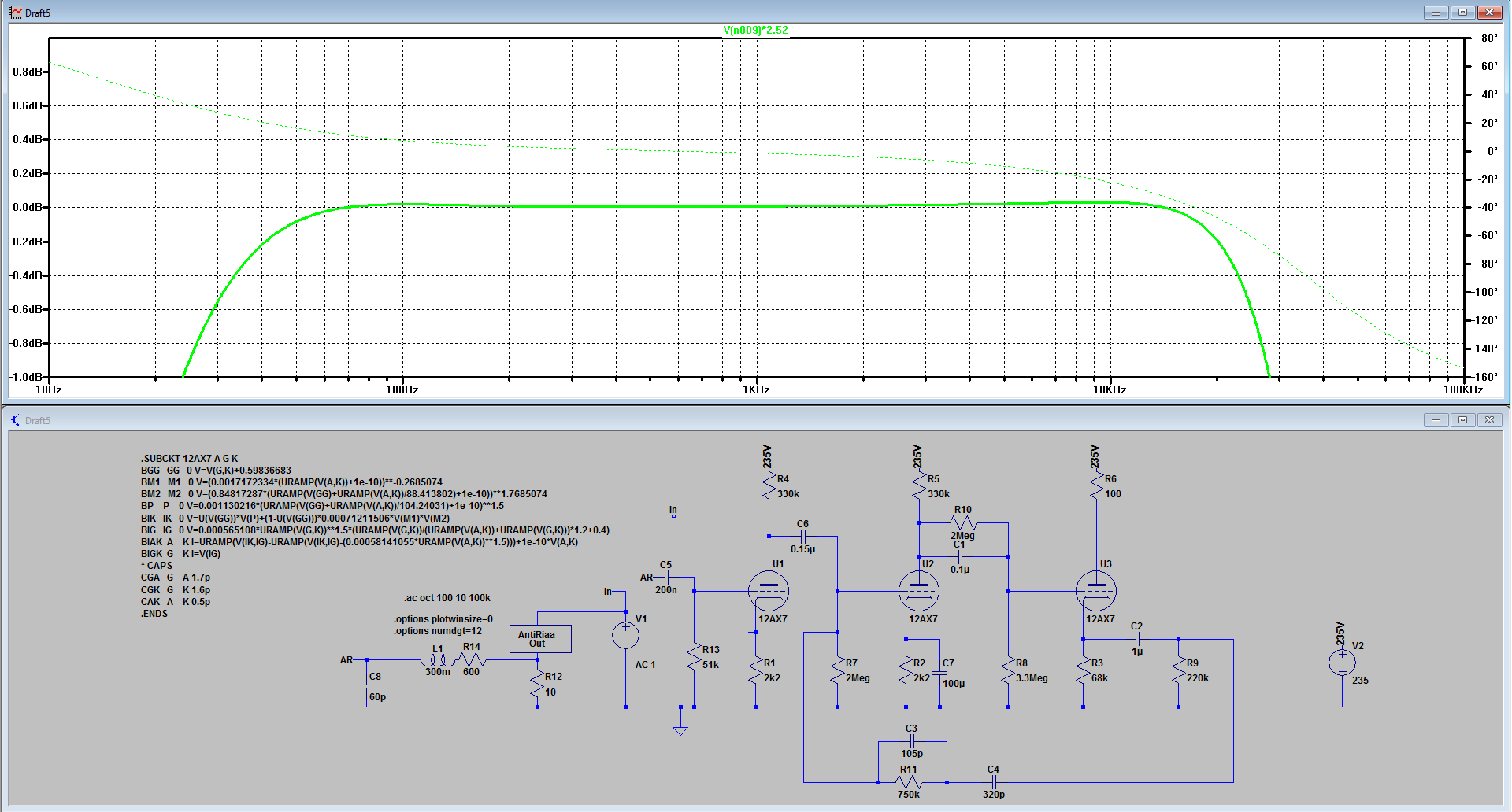

So, finally back to the simulator. R15 is not necessary, the 3180 uS compensation is accomplished otherwise. With the original values the RIAA compliance seems to be quite good (better than +/- 0.125dB). With a couple tweaks it is theoretically close to perfect.
But it's just simulation.
For the record, I centered the response around 1kHz = 0.0dB
Limited gain in V2.
This means the sub-50Hz response depends on tube parameters instead of R and C. This is mildly compensated by the NFB/EQ loop terminating into V1 plate; at least to first-order, B+ variations cancel.
Limited gain in V2.

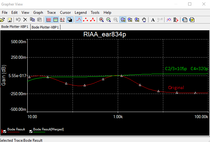

Using the 12AX7 I got the frequency response below including a Cart connected.
The cart was assumed to have 300mH and 600Ohm (L1, R14)
Cable capacity connecting TT and EAR834 was set at 60pF (C8)
An input cap C5=200nF was added to flatten the LF response and act as rumble filter.
C3 was lowered from 110pF to 105pF and C4 was lowered from 330pF to 320pF.

Flat electrical response will not necessarily mean flat total response. Depends on the cartridge, and what capacitive load it needs.
That's why, when designing an MM amp, one has to assume some average which is 300mH and 600 Ohm for the cart, 60pf for the cable and a very low mass for the tip with supersonic mechanical resonance.
This can be regarded being the best possible starting point and that is as far as you can go with a general design.
Further tweaking with extra input caps to get the HF response above 10Khz as flat as possible is up to the user .
Below 10Khz the projected frequency response will hardly be influenced by different cartridges, unless they are extremely different.
So your point is correct but a bit pointless.
Hans
