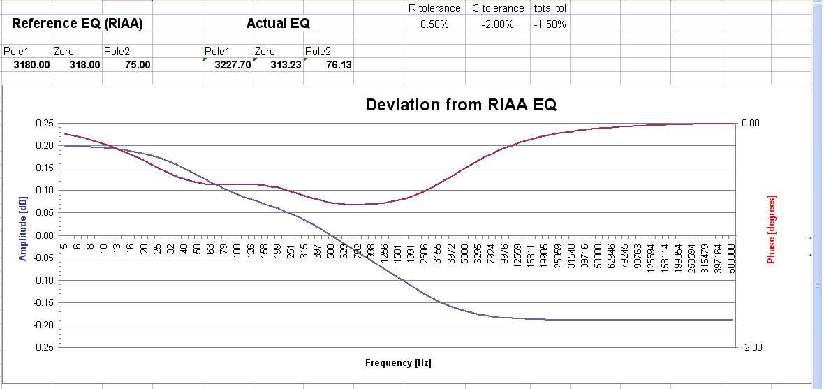

How does one use it?
If I change the 50us RC to any other value, the calculation page shows gobble de gook.

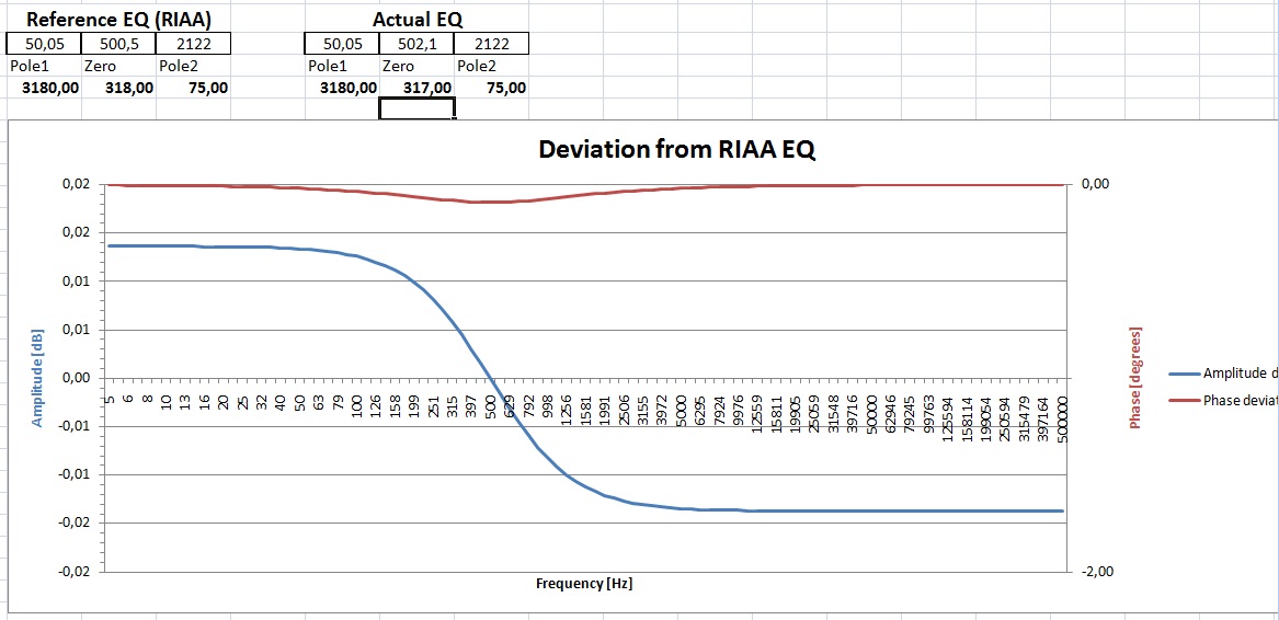

Change the values below Actual EQ and ENTER.
Changing the Zero from 318 to 318.3 (500.5Hz to 500Hz) procuces a really small Amplitude deviation.
Are you using Excel 2003? Then you need to add the Analysis ToolPak. Here are the istructions from Microsoft:How does one use it?
1.On the Tools menu, click Add-Ins.
2.In the Add-Ins available list, select the Analysis ToolPak box, and then click OK.
3.If necessary, follow the instructions in the setup program.
Excel 2007 already contains the Engineering fuction library that handles complex functions.

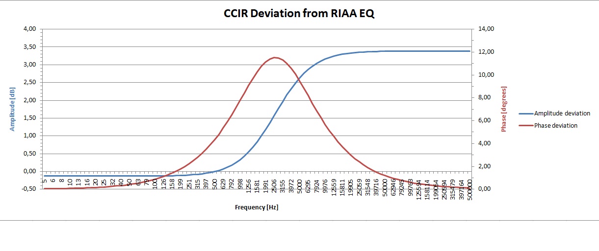

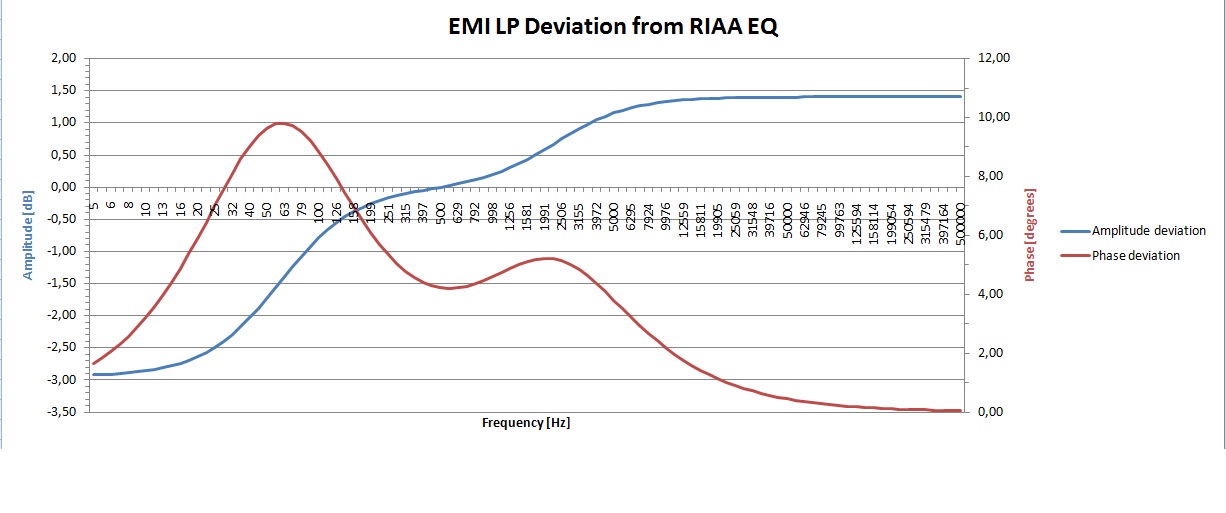

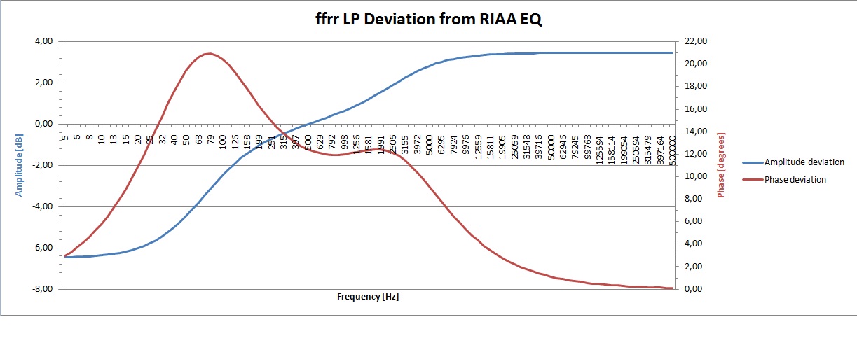

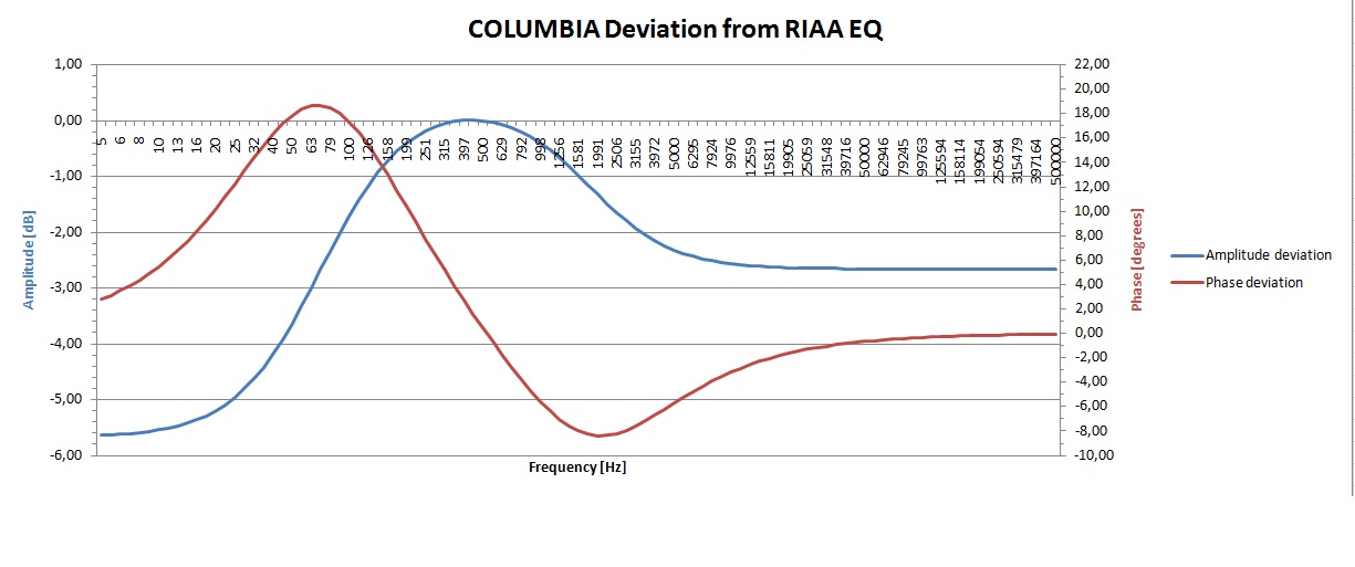

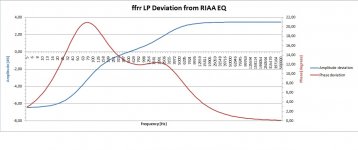

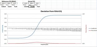

Using this spreadsheet, just by moving the 318uS zero a little we get the following diagrams:
Using 317uS (502.1Hz) the sound presents less attack and is softer.
Using 319uS (498.9Hz) the sound presents more attack and becomes nasal.
The numbers do not do justice to the real effect that is really noticeable.
There are some problems with your assessment:
You changed a capacitor for a value different in just 40pF and IN THEORY this just moved the pole in 3.2Hz, a minute amount.
You claim that the effect is really noticeable.
Problem 1: Just moving your head 5cm from your listening position would wildly change the effective frequency response of your system in more than 2dB at several frequencies. This is something ignored by most audiophiles but something that is well known by the people who work optimizing speaker placement and doing compensation of room modes.
Problem 2: To do a "scientifically correct" listening test, you would need to do a blind test with an ABX box.
Problem 3: Let's say there REALLY is a noticeable effect and it's coming out from the circuit itself. Then this effect is not due to a 3.2Hz change in said RIAA pole but by some more complex interaction/effect that is going on in your specific circuit. Am i explaining myself clear enough? It would not be the 3.2Hz change the thing that is making a supposedly huge difference to the sound, but another electrical effect inside your real-life circuit with real-life capacitors.
Because you were assuming that your capacitors are ideal and that their capacitance in your circuit will *only* move the time constant and do *no other* effect in the circuit.

Problem 4: You changed a capacitor for a value different in just 40pF. But capacitors can be wildly varying in tolerances, even 10% of tolerance is not unusual. You can use a capacitance meter, but measuring capacitance of just picofarads is not easy at all... just putting two wires close together will already create capacitance of a few pFs.
RCruz, i don't want to claim that you are deluding yourself; if you hear a difference, maybe there is a difference. What i find hard to believe is that the ONLY real difference in your preamp was a 0.05dB change. I think that something more is going on inside your preamp, or that the change was not really just a 40pF difference in capacitance.
