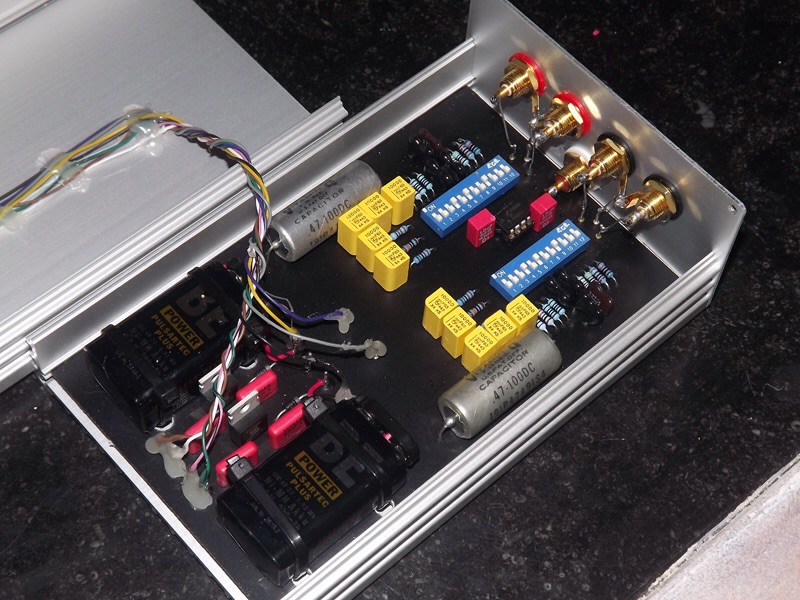

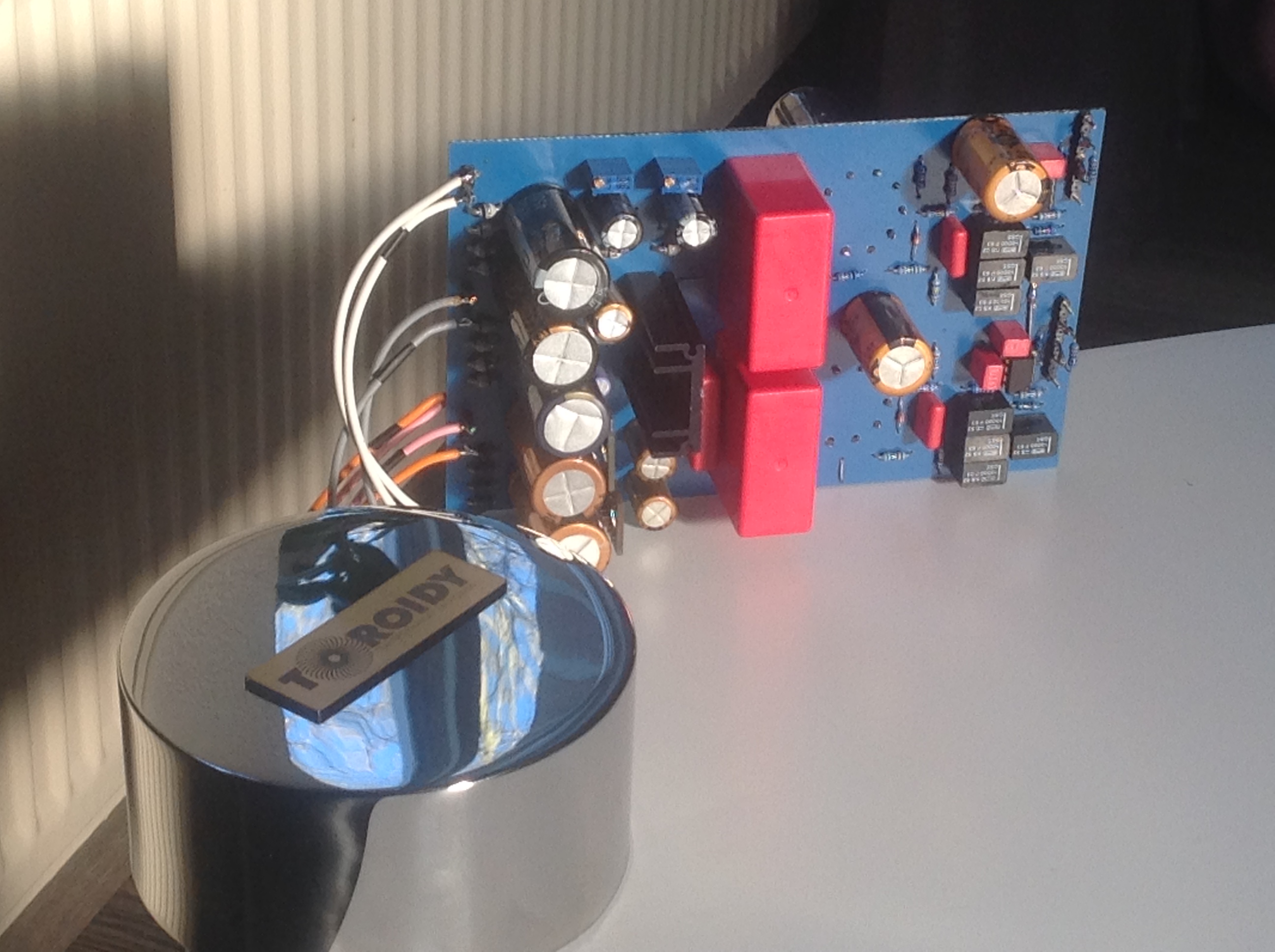

Does the battery power option remove any noise or lower the signal to noise ratio much ?
Battery supply is the most quiet design i have build. It is also easy to build. Just 2 x 9v batteries and solar charger. About 12 hours of continue play.
lm4562 MM phonostage on solar energy.
