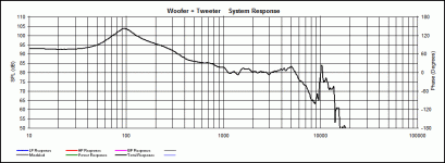

Here you go, 25mH in series with a HiVi B4N, and done. 😉
