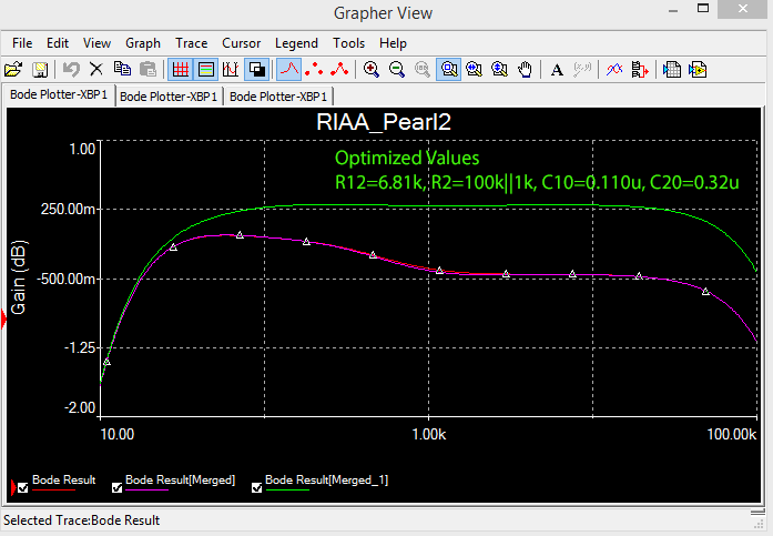

Digikey has the Vishay MKP416 pp caps and Mouser the Wima FKP2 pp caps, both better than Panas IMHO.
Hi Massimo, thanks for the help.
The Vishay MKP416 are metallized polypro whereas the Pan ECQP and Wima FPK2 are not.
Mouser's Wima FPK2 only go up to 0.033uF and I need 0.33uF.
Jeff
Jeff
An Aussie member reported the MKP416 as a very good sounding cap.
Yes, Wimas are film and foil, but you can mix them (i.e. C17 = 333nF = 100nF x 3 MKP416//33nF FKP2)
