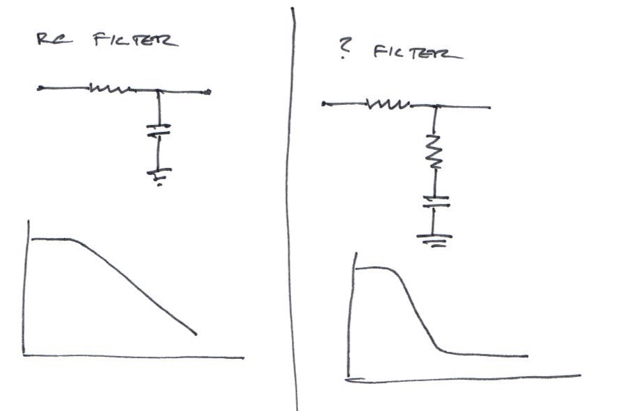

another calculation question - this time a filter taken from the hagerman bugle circuit. here's a drawing of two filters. What's the one on the right (?)called? Interestingly if the resistors in the two filters have the same resistance (R1 on the left = R1+R2 on the right), the rolloff will be the same. But - according to spice simulation - the filter on the right will "stop" the roll off at some point. I guess that's what you call a zero?
Can somebody tell me the name of the filter on the right?
Its tehcnially a lag compensator. Lead compensators have the pole higher in frequency than the zero, and lead-lag compensators involve both a lead and a lag compensator (2 zeroes, 2 poles), apparently.
Poles are always bumps in the graph, and zeroes are dips, so yes the roll off begins at the pole, and stops at the zero. The DC response is unity, and limit at high frequency is set by the ratio of resistors.
