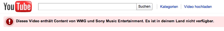

Tut Mier Leid
Es tut mier leid dass, Sie kann mein video nicht sehen und hoerhen. Ich kann nicht GEMA bezahlen.
My German is rather rusty, as I haven't been there since 1971. I really wish you could have got it. Thank you for your kind words, Edgar
That is the message i got from You Tube. I can not play it in my country because the music is owned by Sony !
Move on Edgar, i find your efford way cool.
