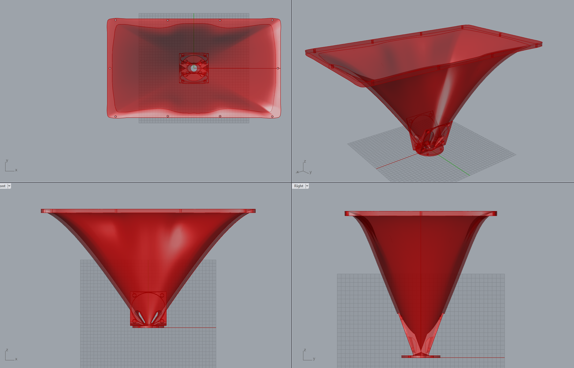

I made this grasshopper script a while back that would dynamically make a multi entry horn from the output of ATH.
This is the sort of output you get

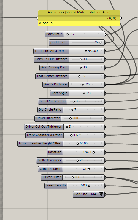

There is a lot of options down the side to adjust the ports and other things

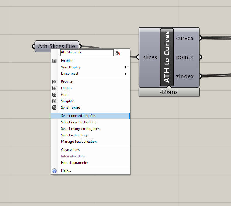

The input it takes is the slices output from ath, you can select it using the Ath Slices File input (Right click and select one existing file)
I didn't end up adding the cone plug which I had planned to do, you can easily change all the dimensions currently then export it to some other software to slice up and 3d print.
I have uploaded the grasshopper project file if anyone wants to have a go with it.
