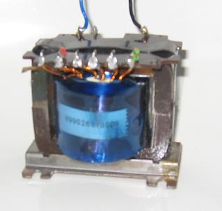

I've got a pair of speakertransformers (originally meant for 100V speakers),
made by Philips, using the same core of the allmost legendary AD9058 output transformers.
Measuring them, I calculated that putting 300ohms on the secudairy,
I will get a reflected load of about 5.5K on the primairy.
What if I were to use these transformers in the EL84 schematic ?
Tubes in triode, to minimize output power ?
What's your verdict on this scheme ?
Greetz,
Empee

100V transformers might not cope very well with DC across its primary, however if they are indeed 5.5K : 300R they must be very high wattage type so core is probably large enough to still stay in the linear region despite DC bias ? Try it out and let us know whether you're missing out on low tones (bass) or not.
Some 100V transformers I have are already built with same orientation (no spacer between both stacks though) and are welded together. "What welder hath joined together no man shall put asunder" 😀 I think that simplified the construction as interleaving requires more work.
