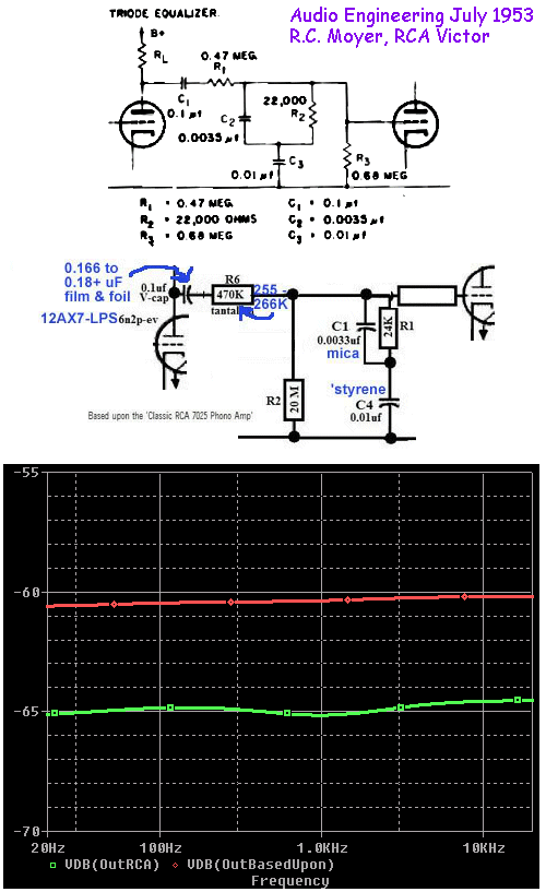

Ok point taken -- I do, however, find the bass a little anemic through the phono stage. I've A/B'ed the same songs on LP and CD...
Is there a change I can make to that phono EQ to help out the low notes? Or will it just be squashed by the NFB?

LP cutting has a problem with deep bass. CD is agnostic to frequency. LPs and CDs are NOT the same recordings. (Also of course mastering tastes have changed over the decades.)
Have you built a reverse-RIAA network and verified your preamp?
FWIW: I was going to point out the changes from RCA's values to this "Based upon" plan. However they both sim incredibly accurate, +/-0.3dB. Likely errors would be weak tubes and wrong values. Also of course unfortunate tonearm resonance.
