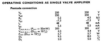

Just some more for a laugh,
Pentode..
I have changed the zener (G2 22V) to a resistor and slowly reduced it bringing Ig2 to spec and measuring the VD across the resistor while listening to the sound change..:D and as you would guess it gets louder than the zener and different.
I managed to get down to 300 Ohms. Which I can now switch between ES U/L and pentode. Its just something to try when I get bored..I guess a stiff zener reg supply is on the cards..
Anything for a laugh :D
But I have an itch to build higher power for a laugh..:D So I was looking at the tube cad super charger has anyone tried this?
http://www.tubecad.com/2013/04/blog0259.htm
its probably easier to just build with a bigger tube..:D
