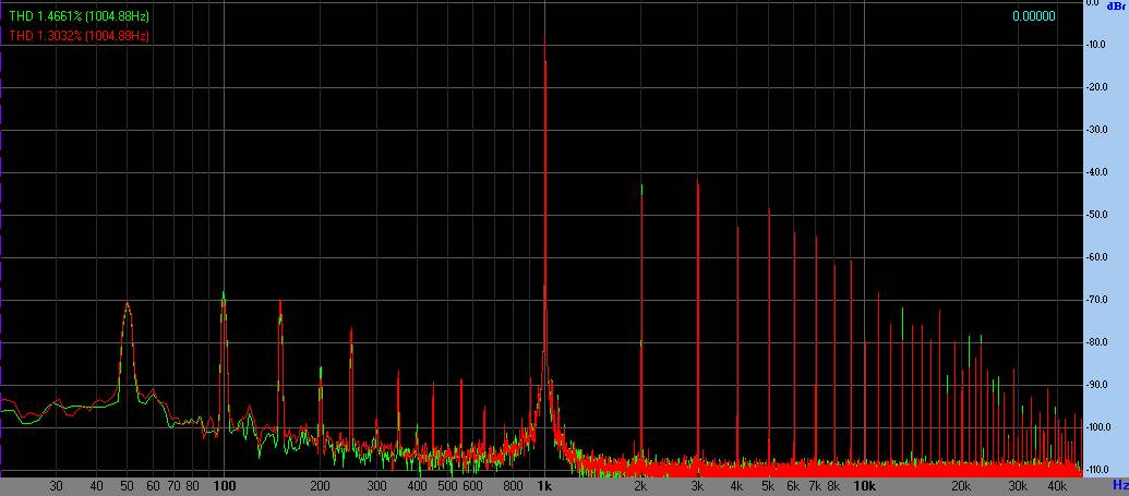

Most 300B SE amplifier (with commercial 300B tubes) at 10W near to clipping.
Over 6-6.5W (depending of amplifier structure) starting A2 mode, increasing the distortion.
My 300B (D3a+CCS, "powerdrive", EH300B) over 10W begin to produce more odd harmonics due to clipping.

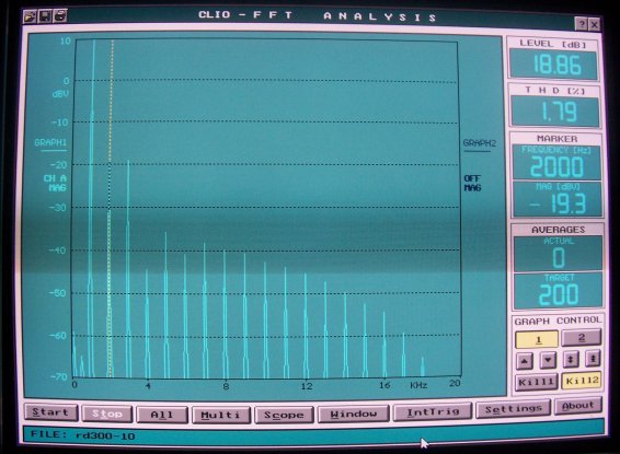

An easy 300B amp is: voltage amp with the two sections of an ECC83 in parallel, RC coupled to a cathode biased 300B. With the 300B at 400-420V/75 mA and 4K primary load one just needs to play with the ECC83 anode resistor in order to achieve useful 2nd harmonic cancellation which will be the only one at low power and the dominant up to the onset of clipping. It is possible to achieve low distiortion anyway: less than 0.2% at 1W and less than 2% at 10W as shown in the picturs below. This is a real amp as just described....
