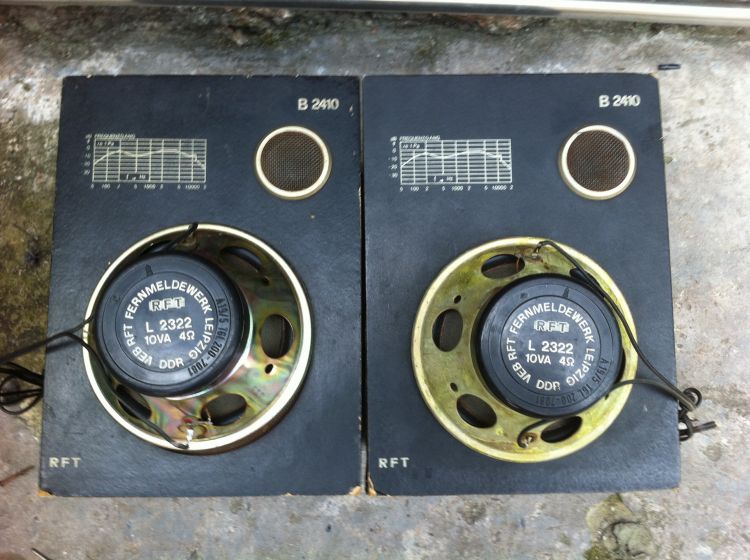

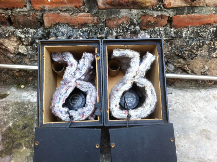

2) well, in my intention, the starting project would be the RFT B 2410, a 6 liters bass reflex cabinet with this L 2322 inside:
Bassreflexbox B2410 Speaker-P Stern-Radio Sonneberg, VEB, RF
So, the only thing to add is another L 2322 into a bigger cabinet (of course).

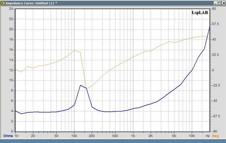

I found also the impedence curve of the VEB STRATON Kompaktbox B7114 (I mean the sealed enclosure speaker with the RFT L 2322 full-range inside)...if that can help, you can find it below, in the atteched files.

RFT L2322 has very large Qts parameter, so bass-reflex box is out of question. The best enclosure for this diver is TL (Transmission Line - see Quarter Wavelength Loudspeaker Design), but it is much bigger than closed box, and demands good knowledge to design and build.
Bass-reflex box will increase low frequency range a little bit, but the sound quality will be also lower. Closed box has the same SPL as Bass-reflex box (above it's F3).
Because RFT L2322 is 4-ohm speaker, you can't parallel two speakers in one enclosure (you will get dangereosly low 2-ohm impedance). Serial connection will not bring higher sensitivity, so I recommend to use only one speaker per box. Build 10-liter closed box and stuff it well with Rock-wool or other mineral wool. Aperiodic box (with stuffed vent) is also good. Do not expect any bass below 100 Hz.
