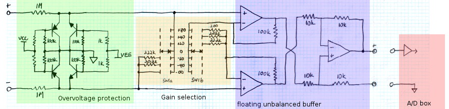

RFC: fully floating buffer with OV protection and gain control
Hi folks,
Everyone seems to have designed a buffer at one point or another, all slightly different in order to fit the specific application.
The point of this specific design is to act as a floating balanced buffer for testing, both to sample the differential voltages within a test circuit and then drive an A/D box. It includes overvoltage protection that will clamp the input to the opamp to just past VCC/VEE when powered and to approximately ground when not powered. Input attenuation is pre-clamp, allowing the circut to be used at up to 400Vp-p [theoretical]. Of course, being a floating circuit, there must be a shared ground potential somewhere-- just not in the signal path.
I have a few question on which I'd appreciate comments.
This is a probably an appropriate circuit to feed balanced-input A/D boxen. But most A/D boxes are both unbalanced and have a 'common' ground across all the inputs. Do I gain anything by having the fully differential output into an unbalanced input? I could just as easily avoid ground loops by having each buffer circuit 'float' on the signal ground provided by that A/D input. Or should I embrace the suck and just put up with the ground loop potential on such examples of consumer equipment?
Assume the opamps are OPA[4]132. Given the large-ish value resistors on the input, is the BJT overvoltage protection still necessary? My guess is yes due to the 2^13ohm FET input impedence. I don't want to accidentally pop an opamp by having the wrong range selected when I hook it up to an amp. Not that I love the opamp, but it could feed through to the much more expensive A/D box...
Any other thoughts?

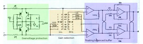

In case it wasn't clear what I meant by "I could just as easily avoid ground loops by having each buffer circuit 'float' on the signal ground provided by that A/D input.", I've attached another pic.
Again, simulation and limited bench time only tell me so much... I know both circuits work, I'm just looking for obvious recommended improvements as well as where to eliminate unneccessary overkill.
Hi Xiphmont,
To make some statements one must make some assumptions.
I assume you have the buffer's PSU GND connected to the A/D-GND or a potential nearby, and that the buffer GND is not directly connected to safety earth (only via a loop breaker circuit). Then you would not gain anything from the servo output, in fact it only adds distortion. In that case you'd be better off with the conventional subtractor as the output stage, connecting it's REF input to the A/D GND (which kills GND-loop hazard). This is your "floating buffer" in your second drawing.
When the A/D is fully differential, again there is not much profit, then two simple subtractors would work better, this time REF being GND of the buffer supply. Or a simple subtractor and an inverter after it. Of course no output should be shorted to GND, then. The primary goal of the servo ouput is to maintain constant gain into both balanced or unbalanced inputs (one line shorted to GND), which need not bother us here as we have full control over the situation.
The input stage doesn't eliminate common mode signals (common mode gain = 1, and that's why you need the subtractor), so if you want to probe signals at, say, 50V common mode you must divide down the common mode signal (resistors from the subtractor opamp's +IN and -IN nodes to GND). This comes at the cost of increased noise gain. This also assumes that the PSU for the input stage is floating and it's "GND" is connected to a potential nearby the voltages you want to probe. Still you have the problem that you cannot exceed the input amp safe ranges, differentially also (and you would need to divide down the outputs or change gain of the subtractors anyway to not overrun the A/D). If that is required (eg measuring the output of bridged power amp), then input dividers are needed (EDIT: I now see you have those already), but then in turn you could divide down to GND as well, reducing common mode "on the fly" and then would not need a separate floating supply and the dividers in the second stage.
This all very much depends of what signals you want to measure, if you really want to do millivolts at 400V common mode it's gonna be tricky.
Regrading protection, those 1M, though adding quite a bit of noise, would do the job (and please add some filter caps, both common mode and differential), but clamp diodes to the supplies are never overkill (simple 1N4148 will do, no need for more complex circuitry).
You also must make sure that there actually is a DC path for the input bias currents back to the supplies of the input amps (via GND, normally), as little as it may be, but you need it. For higher gains AC coupling is often a better choice (then you need distinct bias path resistors) because of offset/drift issues.
All in all, welcome to instrumentation, can really be a big can of worms, sometimes.
You might want to check some AppNotes on instrumentation at Analog Devices, Linear, TI, National, etc, and the corresponding parts for more info.
And have a look at the THAT1600 and THAT1200, those are advanced line drivers and receivers.
Last not least, don't forget plain simple signal transformers (output maybe buffered, depends), those are safe, easy to use and work very well in many AC situations at high common mode voltages. For example I use them to measure PSU rail ripple, even actually listening to it. Need some precautions, though (no DC, not even for a brief moment, or many good xformers will be degraded severly, getting magnetized).
- Klaus

Of course. I didn't go too overboard because I half expected no one would care to answer 🙂 Buffer design being old hat to the experts and all...
Yes, that correctly matches my unstated assumptions, and answers my question directly. Thank you!
That would have been my next question 🙂
As envisioned, the circuit would run on +/- 6V-- zeners that small leak current like a sieve. I had wanted to maintain as high an input impedence as possible. thus the attempt to do clamping via BJTs.
[edit: I'm not sure what you mean by the clamp diodes-- I had assumed you were talking about zeners, but the 4148 isn't a zener, so... Do you just mean stacking a few diodes and relying on the forward junction voltage? It seems like that would add some strong nonlinear distortion.]
The 1M inputs were, again, an attempt to keep input impedence high despite the attenuation circuit sitting in front of the input buffer. Would the self noise of 1M resistors really be that much of a problem if chosen properly (eg, Vishay/Dale CMF55 series).
I was still considering the possibility of dropping the BJT clamping/1M resistors and just using coupling caps and bias path resistors, yes. I had not forgotten about the input bias path, but I think i also have not thought about it hard enough.
Those 1N4148 are switching diodes (low capacitance/leakage) and are meant to go to the PSU rails, so they are reverse biased under normal conditions. You could also use the reverse biased diode of a JFET, which is even better in terms of leakage.

With the 1Meg inputs, the unavoidable thermal noise will be dominant (and construction dependent noise add to that) once you go below a certain signal level. As long you aren't to measure millivolts or below, this will probably not be a factor (for distortion measurements, frequency response etc).
You could do a building block approach (already there with those colored shades you made) and make different input modules for different purposes.
On safety thing to consider: check that the A/D input can withstand a constant DC of your supply voltage in case of a fault/overload condition. Most sound card inputs (do you use a sound card) are AC coupled and have protection to survive 6V DC or so (nevertheless I burnt 2 channels of mine lately, with "only" 10V AC, but I still have 22 cannels left ;-)
- Klaus
