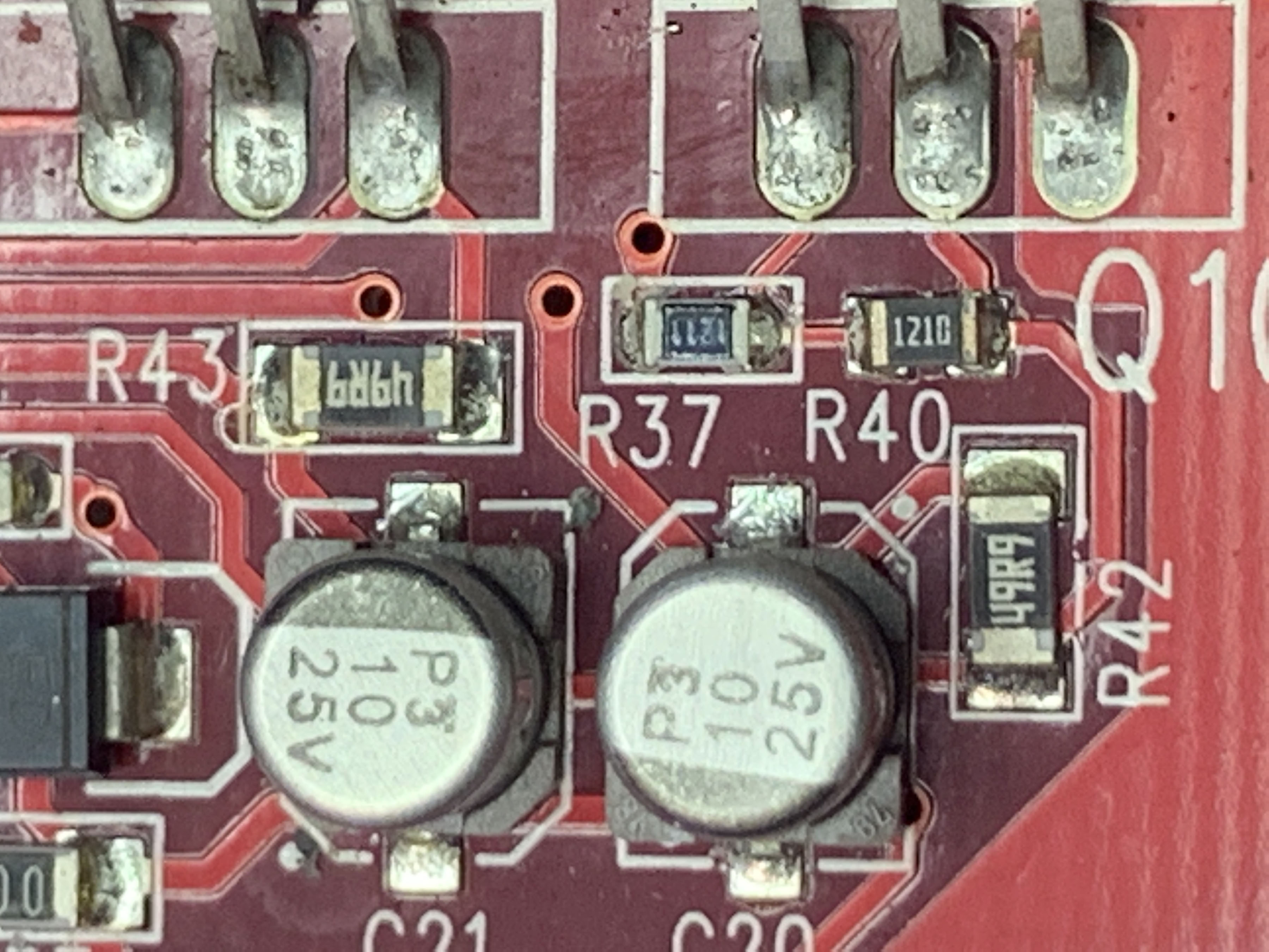

RF P200.2 No Sound, not in protect?
No sound until I back the power supply down to about 11.5V. Then it's faint but changes with the gain. I purchased Perry's manual and have been reading and re-reading the power supply and x94 operations. Some things point towards the transformer. I was also considering the voltage regulators. Nothing looks burnt and no shorts on the outputs but no voltage, either. 26V AC between center legs of Q9 an Q13(right of power terminal). 12.4V DC on the RCA shields. I have some higher than I would expect voltage on TL494 Pin 8, 11, & 12: 24.8V DC. Here are the other DC measurements:
Pin 1: 2.15
Pin 2: 2.45
Pin 3: .0076
Pin 4: .0013
Pin 5: 1.5
Pin 6: 3.4
Pin 7: 0
Pin 8: 24.8
Pin 9: 10
Pin 10: 10
Pin 11: 24.8
Pin 12: 24.8
Pin 13: 5
Pin 14: 5
Pin 15: 5
Pin 16: 0
