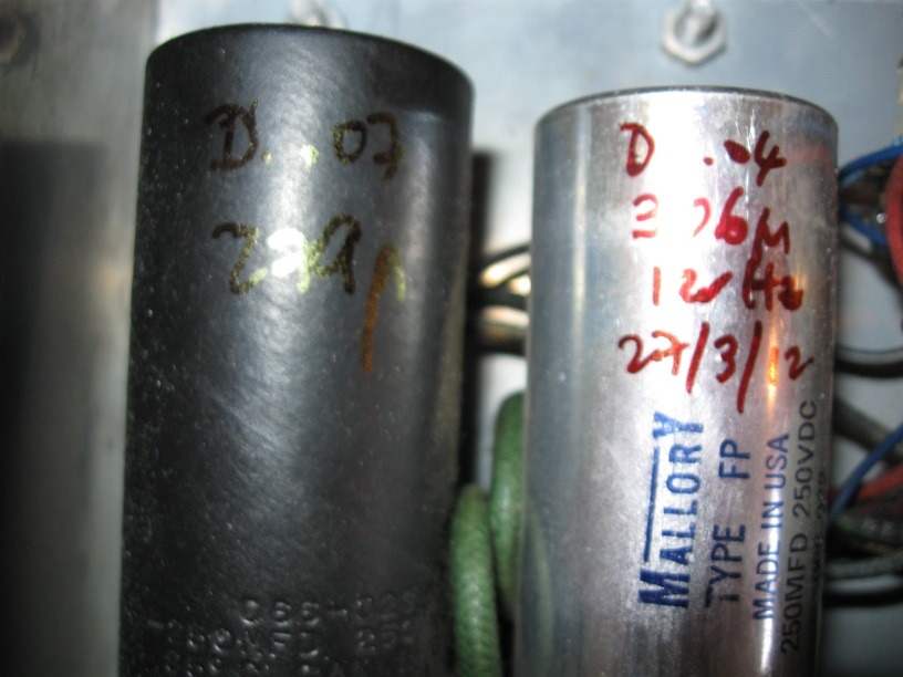

When it comes time to replace the can caps, I can really highly recommend an outfit in USA called Hayseed Hamfest, who make beautiful new look-like-spun-stainless versions to your spec using 105C Nichicon's internally, and at Ham, not Audiophile, prices. The proof of their sincerity is their clunky website!
All good fortune,
Chris
All good fortune,
Chris
They look great, but I already bought F&T drop in replacements from Germany; they've been in a drawer for years while I try to overcome the fear to attack the taps that are soldered to the chassis. Besides, the original ones are still better than specs, about the same as the F&T in terms of dissipation factor (D).... Hayseed Hamfest, who make beautiful new look-like-spun-stainless versions...

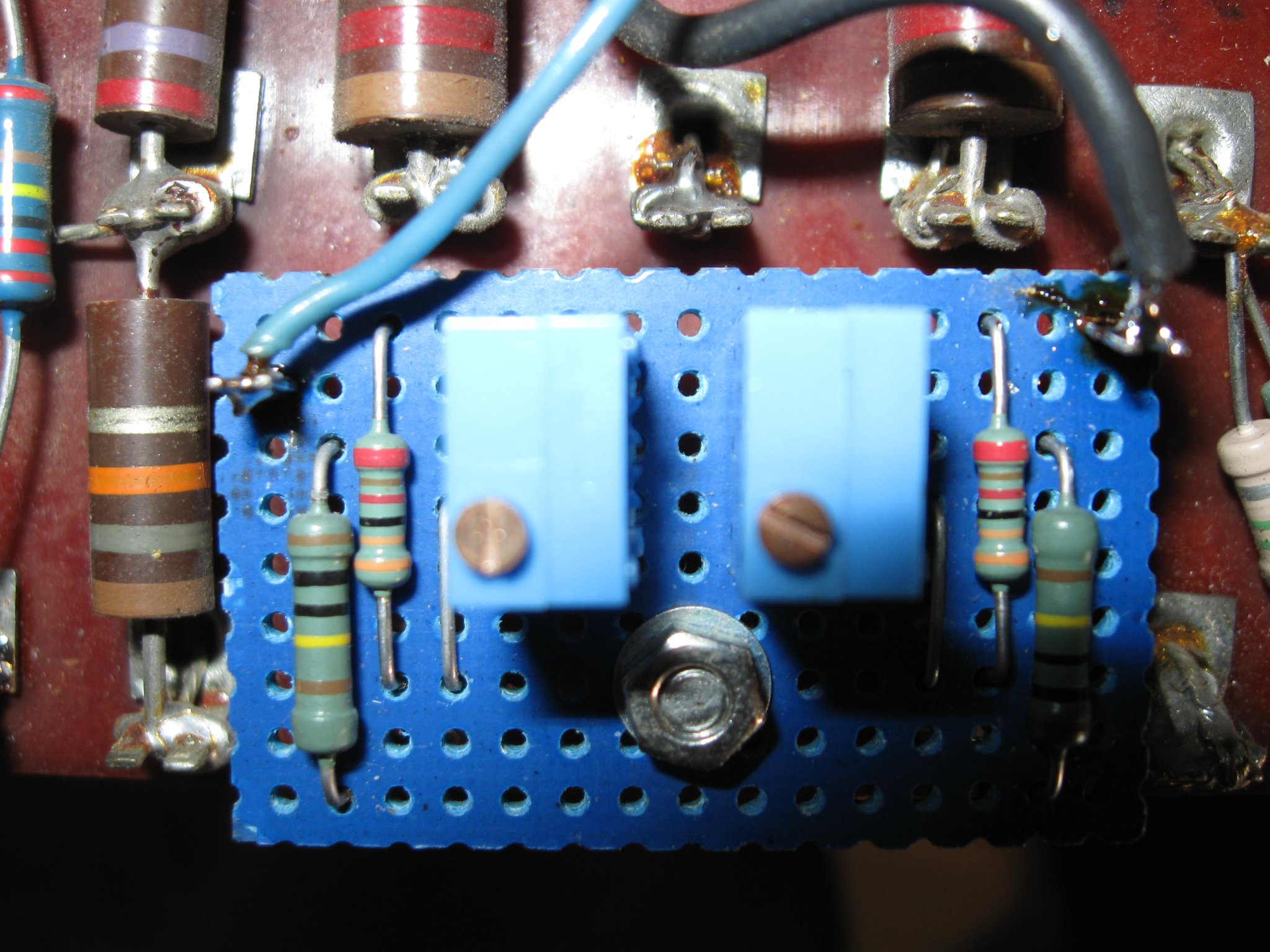

That guy needs some serious professional attentions: there're plenty of unused original holes in the original board to mount whatever it is you fancy. 🙂... I've had to restore a couple McIntosh amps that an idiot did that to...

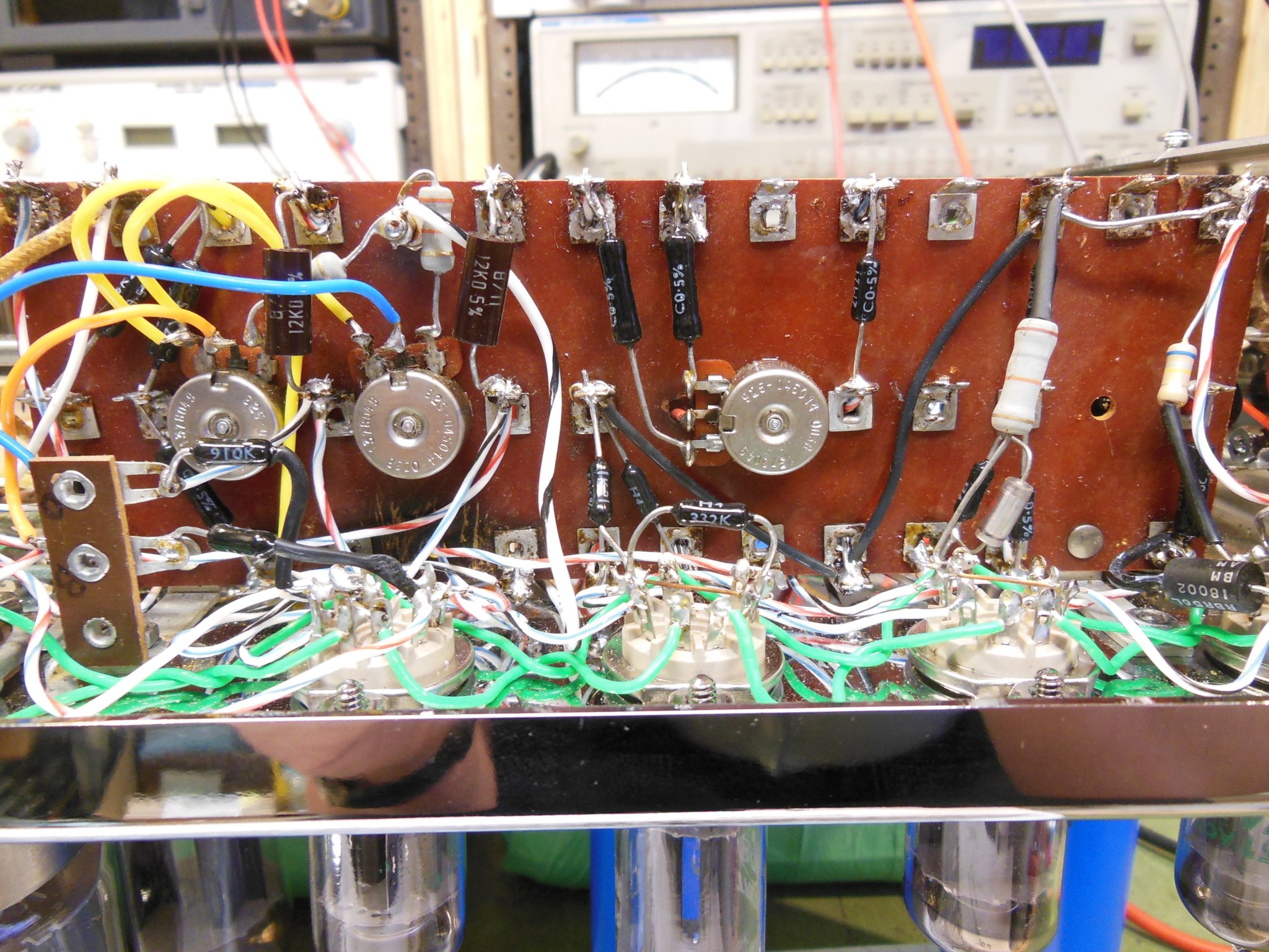

This is what I had to rebuild. The rest of the chassis is worse (believe it or not).
The rebuilt unit sounds amazing. I'm sure you would have liked it very much. I had to replace absolutely everything and rebuild the terminal board. Replaced terminals where there were big holes. Even the wire (most was only 300VDC!!!!).
