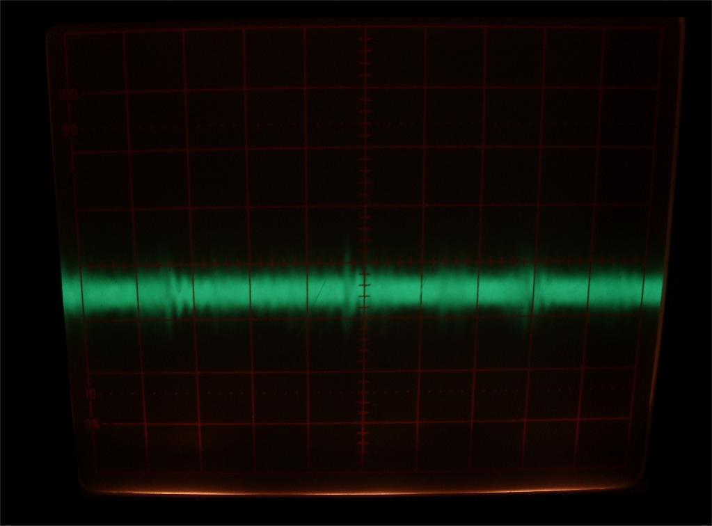

Quite so. With every "new technology" device I hook up , I can see it's "garbage" (picture 1 - rail shot) , even on the common ground of the HT system. Turn off all the NT stuff , most of this goes away. I can't leave my stuff off , or no music. I tried this filter (picture 2 - schema 3) , it drastically reduced what I saw on the scope. The problem with pix 2 is that it is for a small SMPS and not for a 1KVA toriod , I plan to fix that and build the "real deal" (big RFI filter).
As far as sound , I think it sounds better without this "hash" in the PS. I have tried a battery powered MP3 player and wondered why it sounded cleaner than my $100 sound card (at times ****).
*** it is strange how the switching pulses "gang up" with multiple sources going simultaneously (TV/PC/Cablebox/HUB). Under these conditions I could hear a difference. On the CRO it was quite obvious.

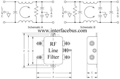

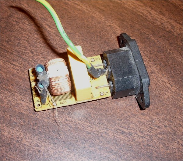

OS, I have 11 EMI filters of this type you presented. I got them from broken computer power supplies for free. However if there is no grounding connected, and you connect the grounding wire of filter to the case of device you placed the filter in, then the case will be constantly polarized with half of mains voltage. I had this problem since in good, old, communism times in my country they preferred two-wire installation with no grounding wire. I had to connect all my equipment to pipes...
Correct me, if I'm wrong, but putting audio device in metal, grounded box shouldn't remove all RF interferences?
Yes it would, provided you had no cables connecting to the inside of the box. Hard to imagine how that'd work as an audio system 😛 Conducted RF is a problem.
Are you sure they're the same? OS filter does not look to have the Y capacitors, only an X. The schematic shows filters with Y caps, definitely to be avoided unless you're very sure of the quality of your earth 😱
AVE...
Abraxalito, I'm sure. I used the same filter design in my small SMPS, which will be finished when I get my toroid chokes installed...
