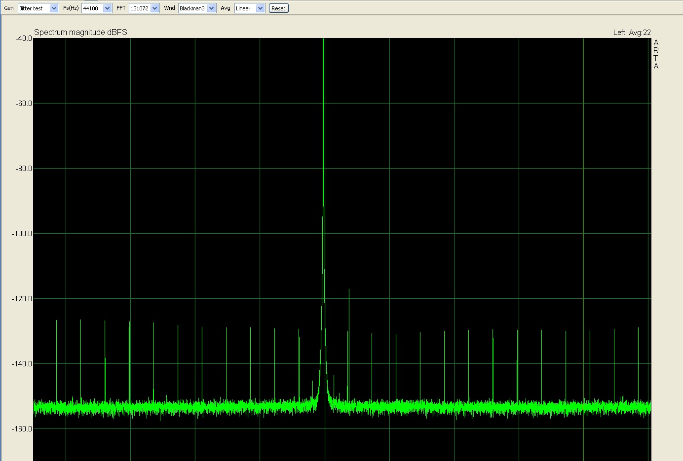

This was taken while I was playing around with the same kind of "analog output" jitter tests:
The card is mine, an EMU1616m, not modified. This is the signal in loopback.

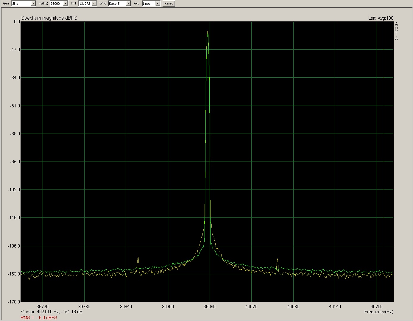

This was another shot at it, emu spdif out > sabre spdif in > sabre analog out > emu in. A very close closein. Yellow is the sabre, green is EMU1616.
After this I gave up because was not satisfied by the test's "resolutive power". All this quite some time ago.
Do you have comparatives at the same frequency, same resolution, same level, same window, same sample rate...? The lines spaced ~180Hz apart on the loopback spectrum look suspicious. As do some of the lineshapes.
Nonetheless, all of the artifacts are at ridiculously low levels.

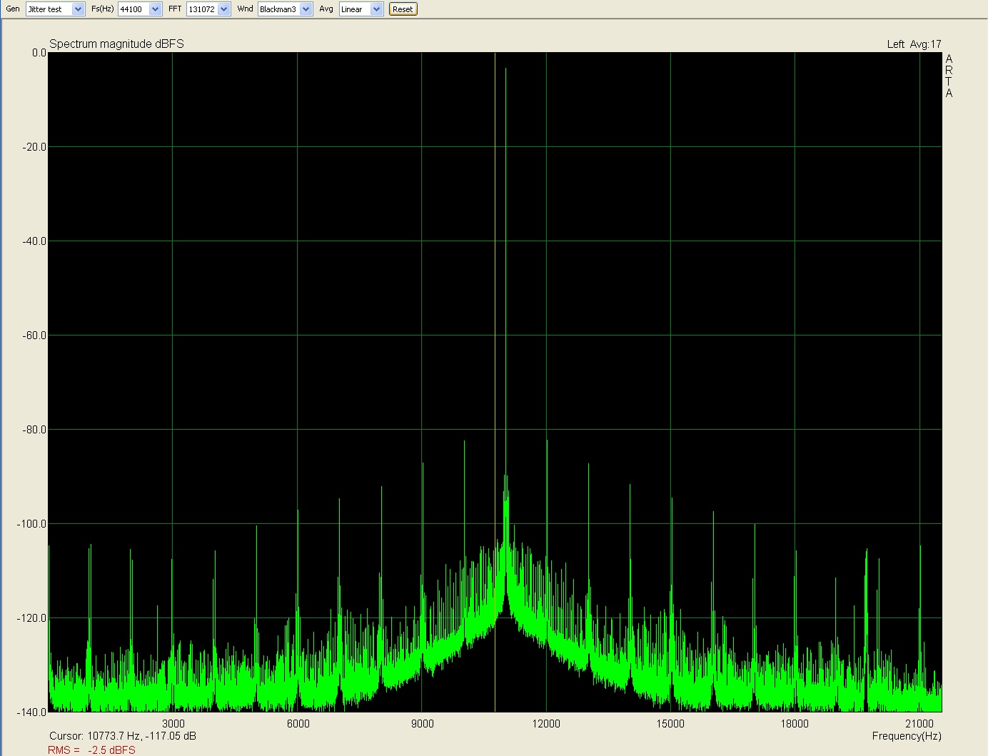

Sy,
Those "spuries" are the jitter test signal itself.
11025 Hz -6db + ~229Hz LSB signal toggled.
The second shot shows a "comparative" measurement: one is loopback, the other is accross the external dac. They are overlayed. The signal used was not a JT test signal that time, just a sinusoidal. The lineshapes are due to the bmp/jpeg conversion - zooming in the originals, they are fine.
EDIT: I withdraw this last. the 229 Hz line variations are real, artifacts.

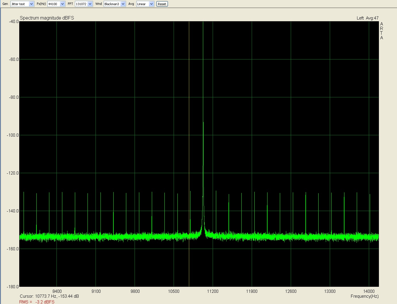

Here there are two players. Pardon, I could not crop better. They are the same setup anyway.
These were done with the same conditions like the EMU feedback loop.
