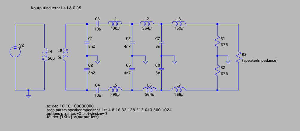

For the reconstruction filter, a non-constant impedance (ie speaker) changes the last pole and progressive ingress of the effect into each stage of the filter. So for a speaker this would be say between 4-1Kohm impedance range.
For digital RF you could standardise on 50 or 75ohm. The 'output transformer' would then simply be a 50/75ohm primary if possible with the digital switching and . I'm making the assumption that a step down to increase current would then drop the secondary output to say a low 0.75 for example. I would need to check if that could be possible.
MarcelG's reconstruction filter is a LC butterworth that has a stop at 81KHz.
Now the interesting question here is with a high order LC butterworth, how much of a difference does the speaker impedance range make?

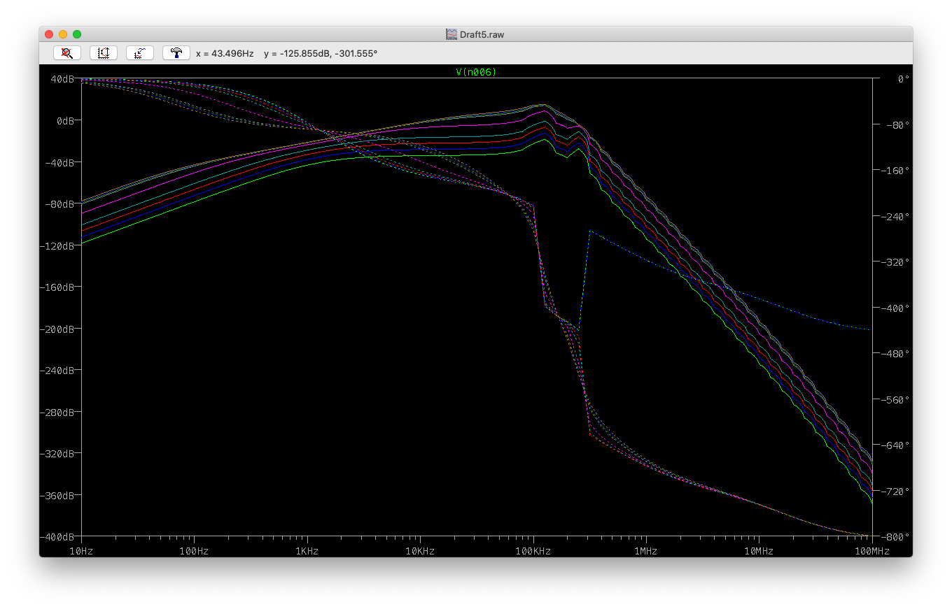

Just to perhaps close off the conversation - I modelled varying speaker impedances vs frequency range in ltspice using MarcelG's 81Khz reconstruction filter used in his valve doc.

Now this doesn't mean much as this is simply an AC sweep, what is important is running a DDS digital signal through vs sweeps of impedance to show the corresponding response.
The filter is designed to remove the aliasing from the switching which it would still do.
However the AC sweep gives a hint at the resulting problems that occur - such as low ohm load results in roll off. With a speaker having a wide range and full range typically an impedance spike around 50-100hz this may result in a uneven frequency response.
